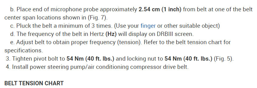

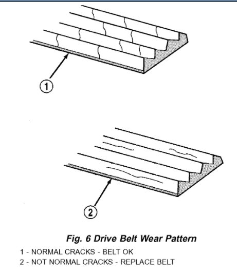

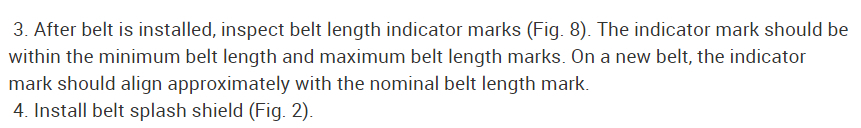

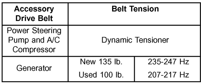

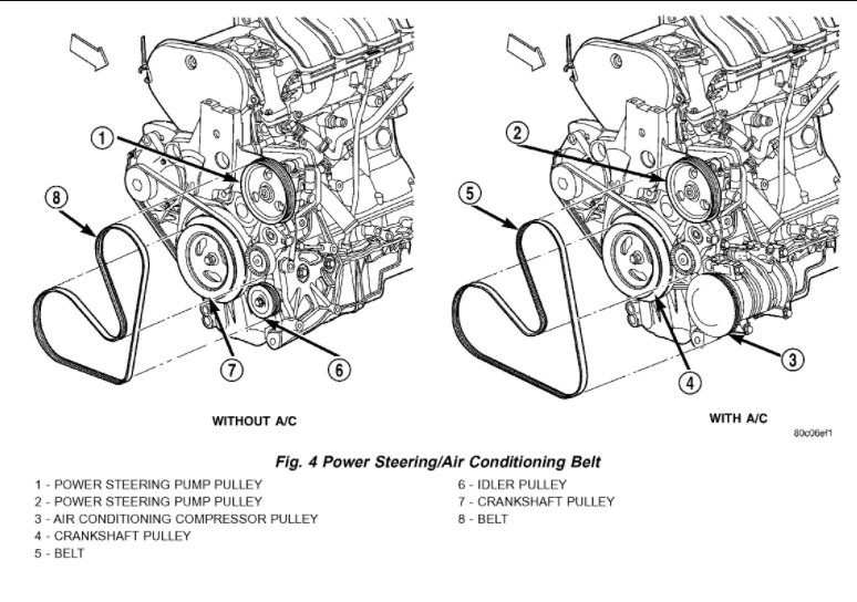

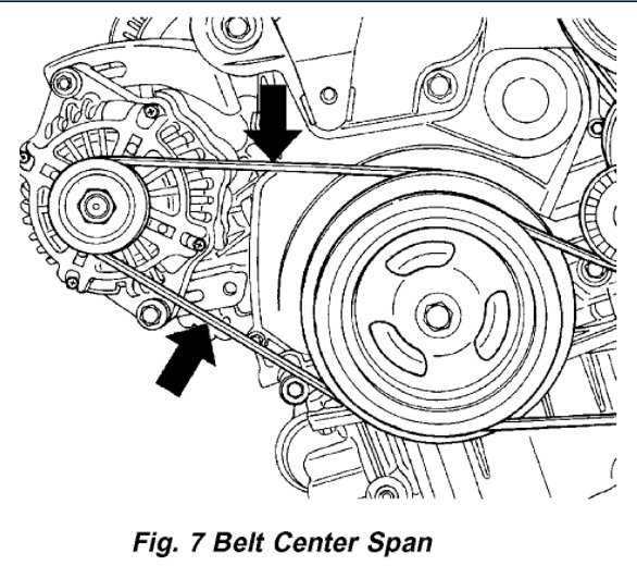

How do I gain access to the belts? and Where can I find a belt routing diagram?
May 20, 2008 at 1:58 PM
DANNY L
CERTIFIED EXPERT
5,648 POSTS
Hello, I'm Danny.

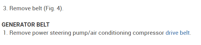

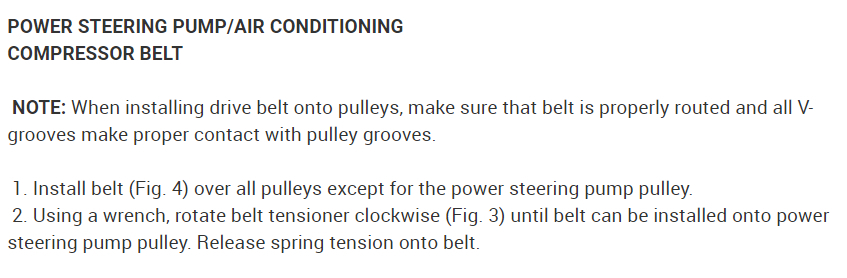

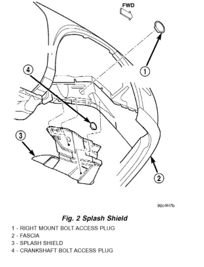

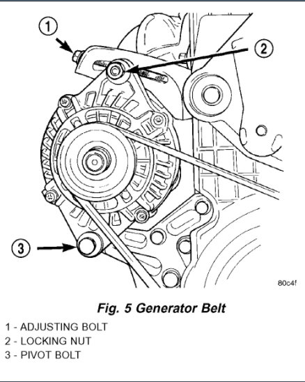

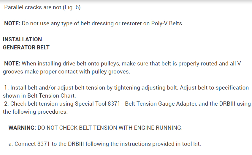

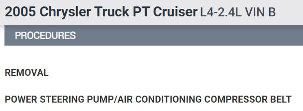

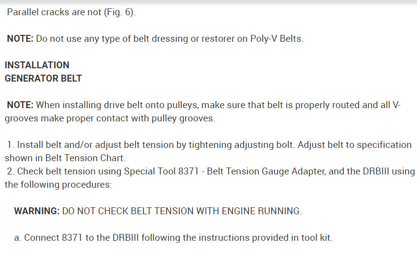

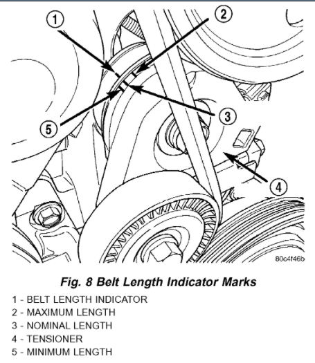

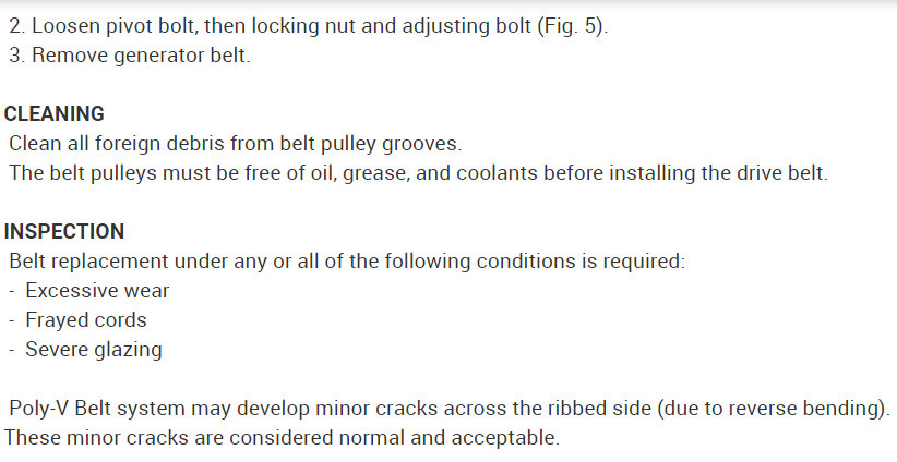

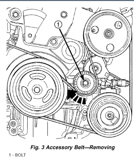

Here is a tutorial for you to view on how to replace a serpentine belt:
https://www.2carpros.com/articles/replace-serpentine-belt
I've attached picture steps below on how to replace the serpentine belt on your vehicle. Hope this helps and thanks for using 2CarPros.
