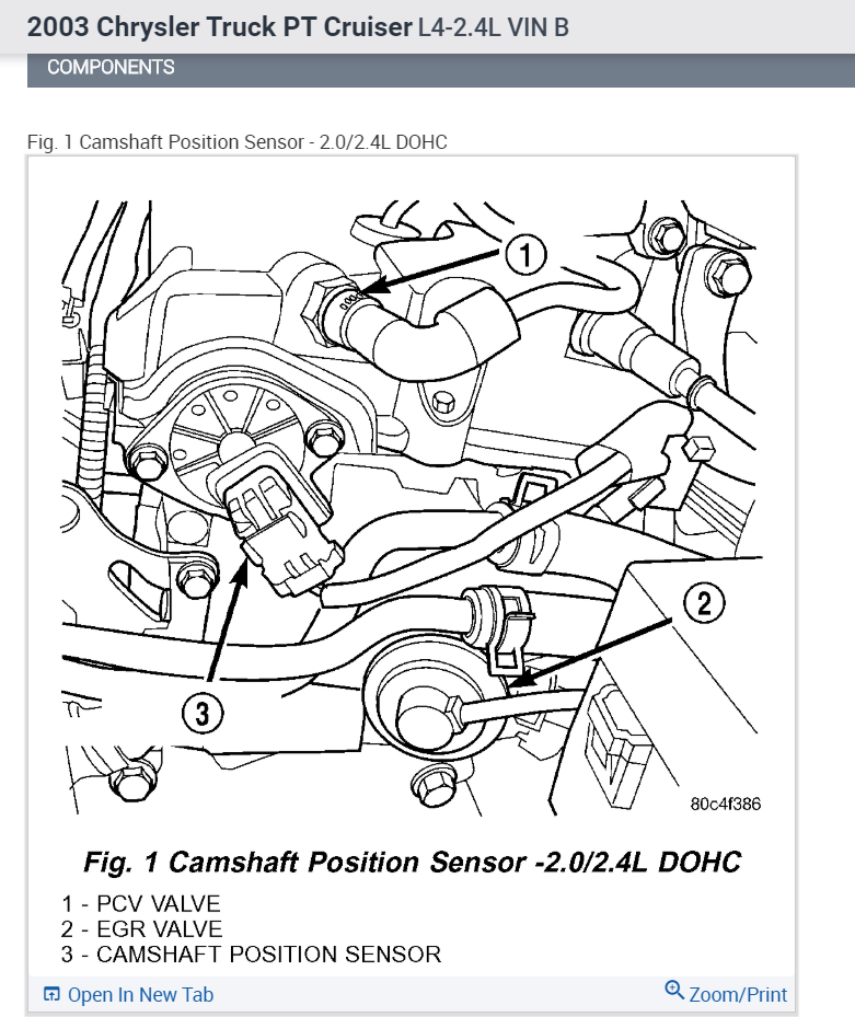

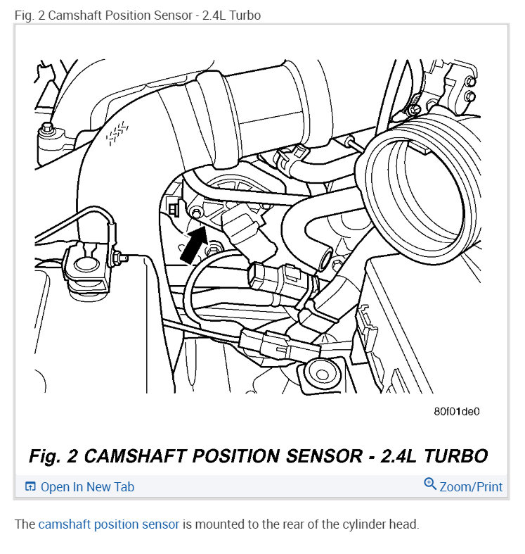

The code P0344 relates to the camshaft positioning sensor. I would replace it to see what happens. here is the location in the diagrams below. Check out the diagrams (below). Please let us know what you find. We are interested to see what it is.
