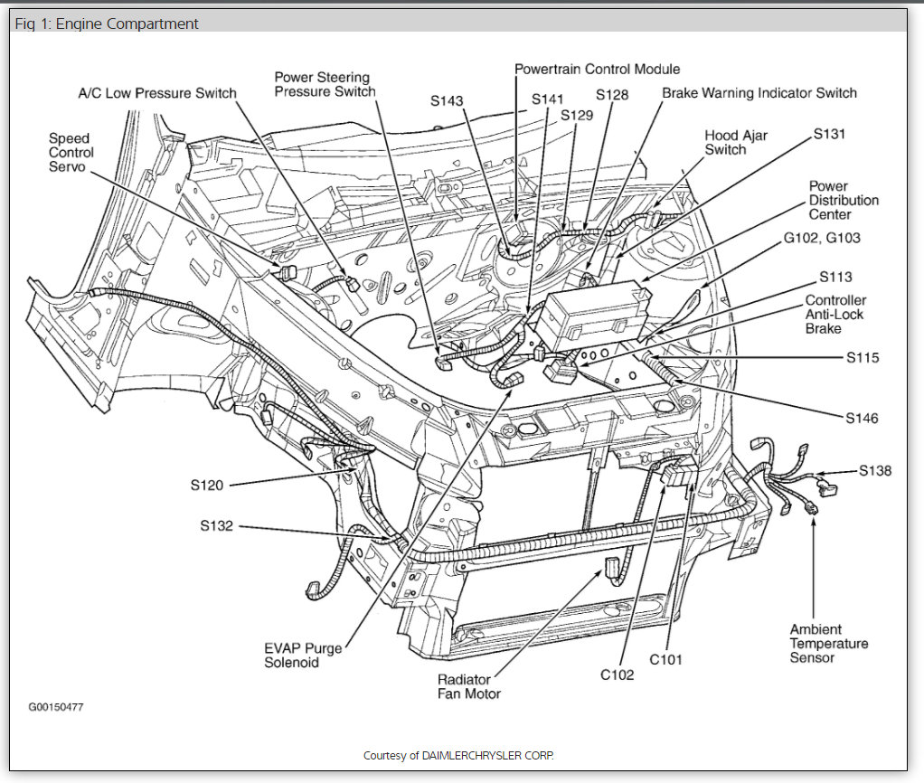

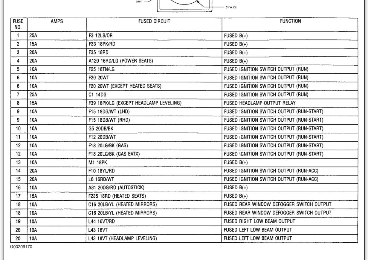

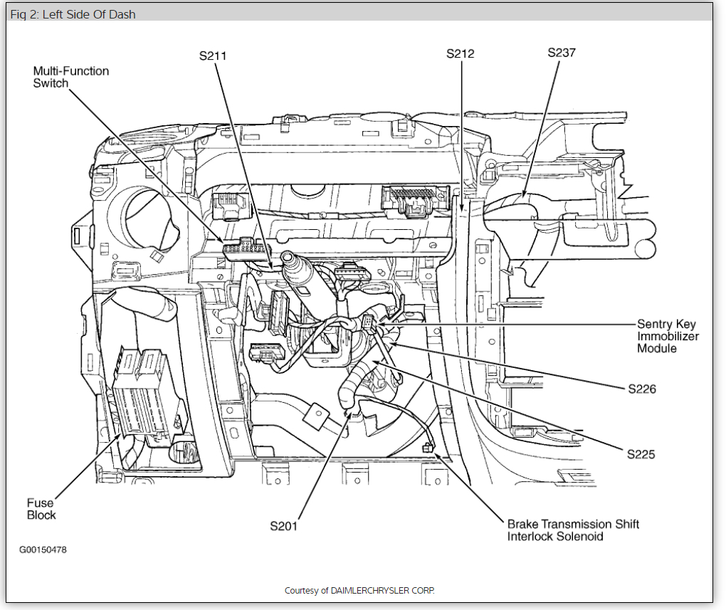

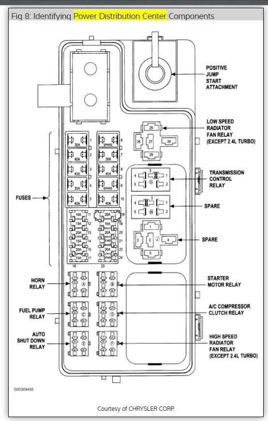

The first thing you should do is scan the computer for codes so it can point us in the right direction.
Here is a guide to help

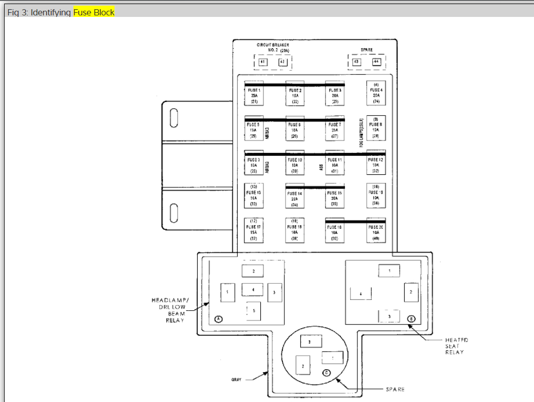

To could also be the ASD relay which had big problem in the at car.
Here is a diagram (below) and a guide to ehlp you get the problem fixed.
and
Please run some tests and get back to us we are interested to see what it is.
