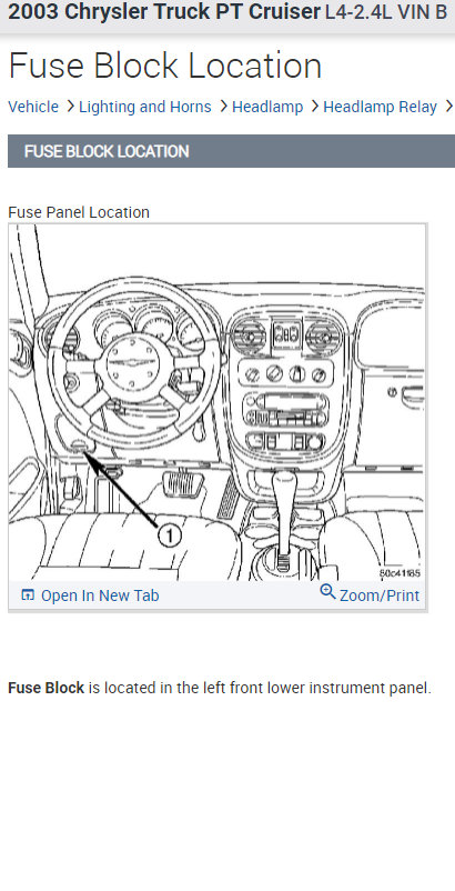

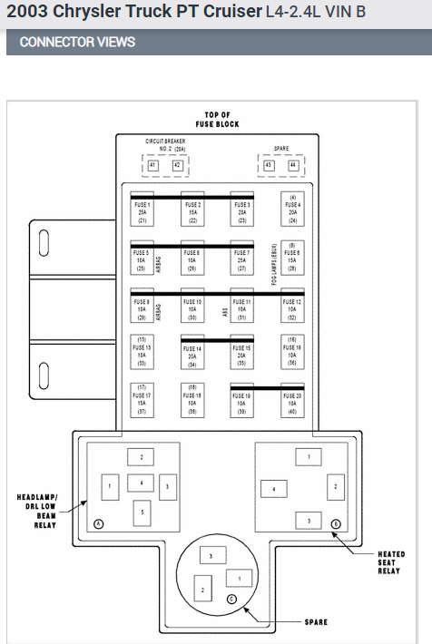

The headlamp relay is located in the fuse block that is under the driver side dash (see picture below). You can test the relay to verify if it is bad.

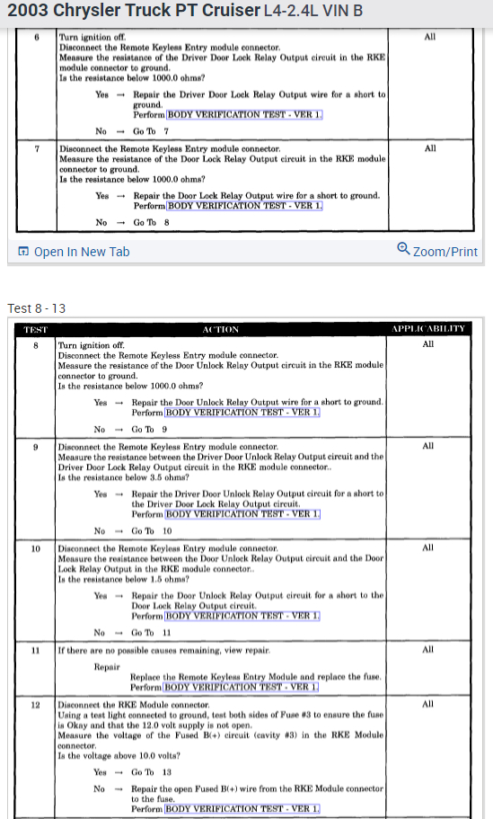

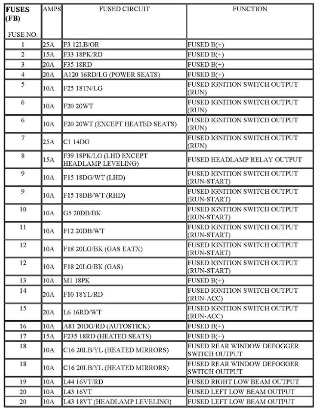

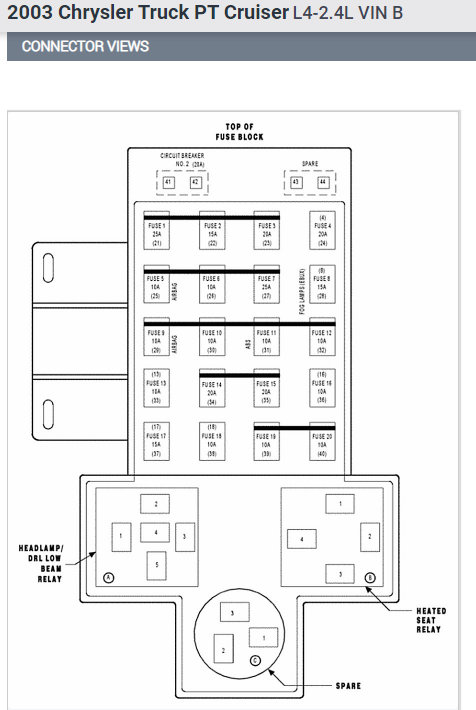

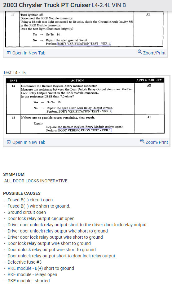

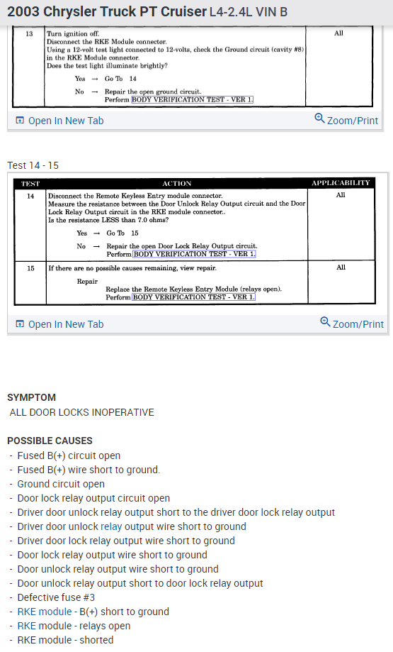

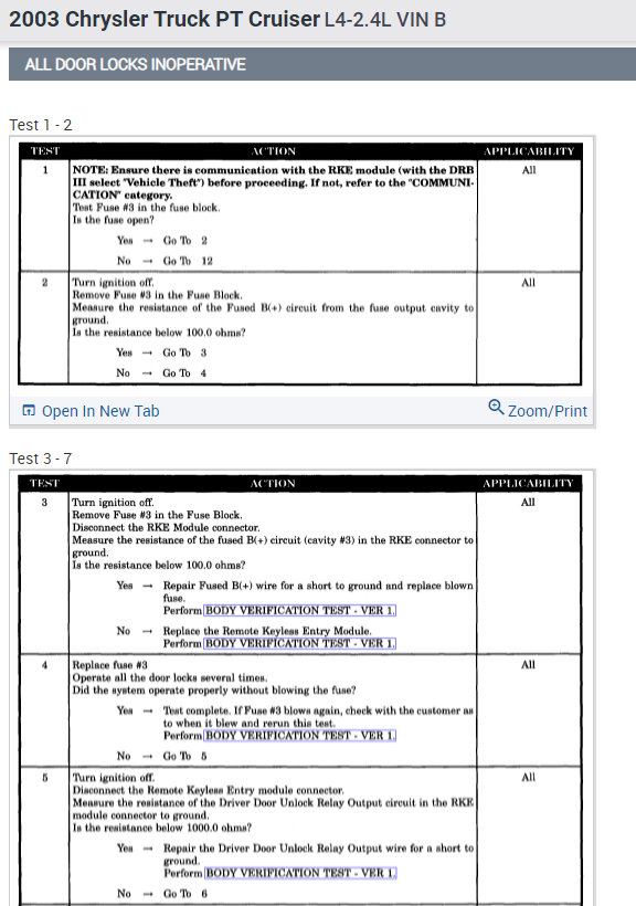

I have attached the fuse block diagram for your reference. Also included the diagnostics procedure for the inoperative door locks.
