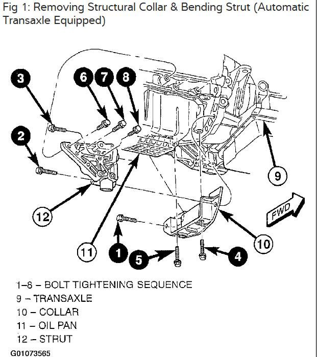

Remove structural collar. See: Engine Mount

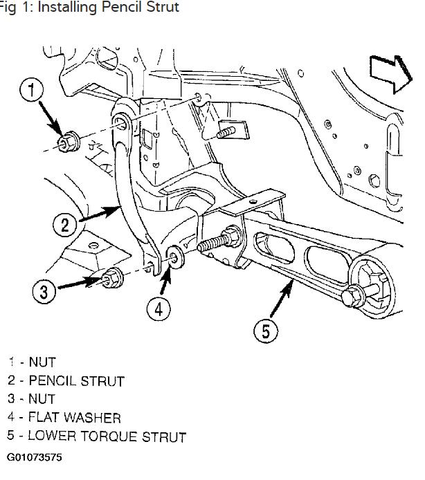

Remove lower torque strut.

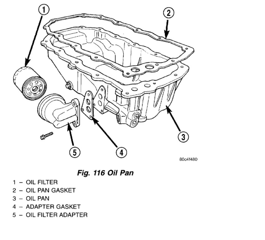

Remove oil filter adapter and gasket (Fig. 116).
Remove oil pan and gasket (Fig. 116).

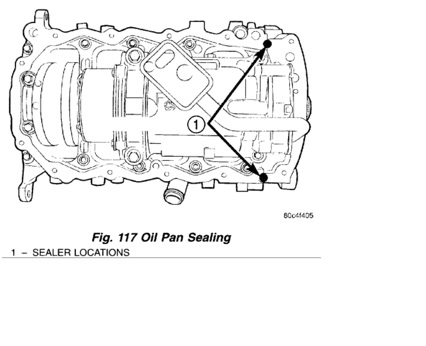

Apply Mopar RTV GEN II at the oil pump to engine block parting lines (Fig. 117).

I'm trying to remove a oil pan and 3 of the bolts are under the structural collar and I need to remove and need to know how to remove the structural collar vie have tried a ratchet with a socket and a crechent wrench neither worked. How do I remove the structural collar
Dec 22, 2016 at 3:54 PM (Merged)
HMAC300
  • 48,601 POSTS
you have to remove collar with bolts indicated. you will have to support engine from top also you need to remove lower torque strut see pics.
