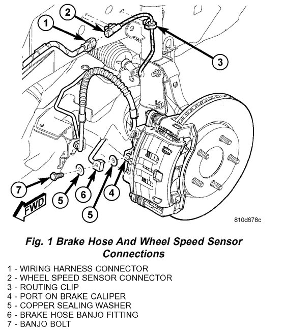

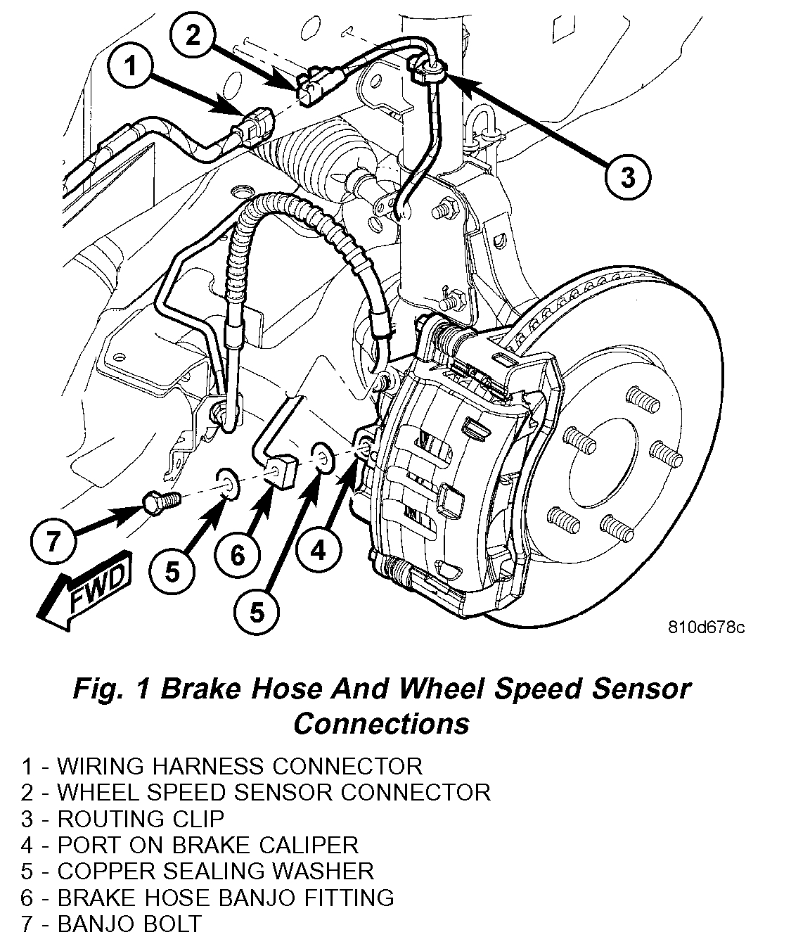

pic 1
2) Disconnect vehicle wiring harness from wheel speed sensor connector (Fig. 1).
3) Unclip wheel speed sensor connector from frame rail outer reinforcement, then open routing clip on reinforcement and remove cable (Fig. 1).

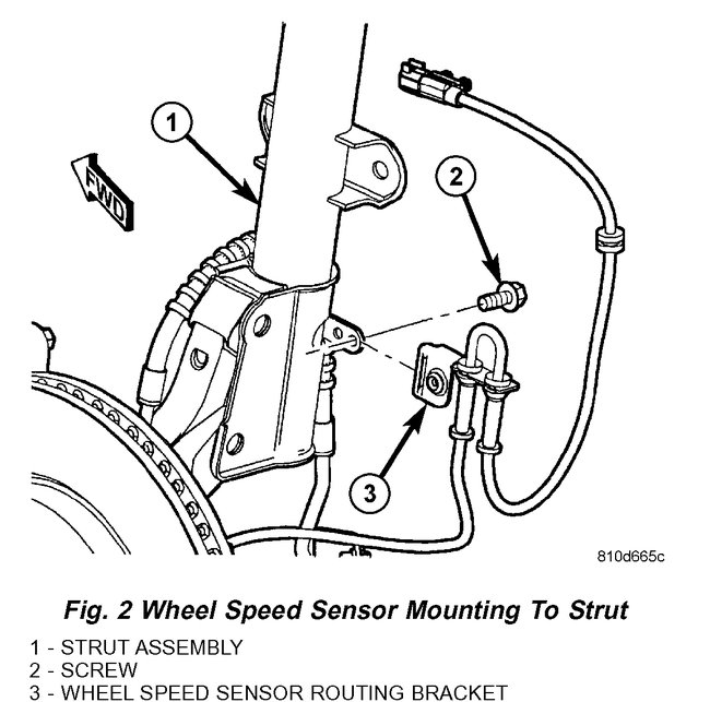

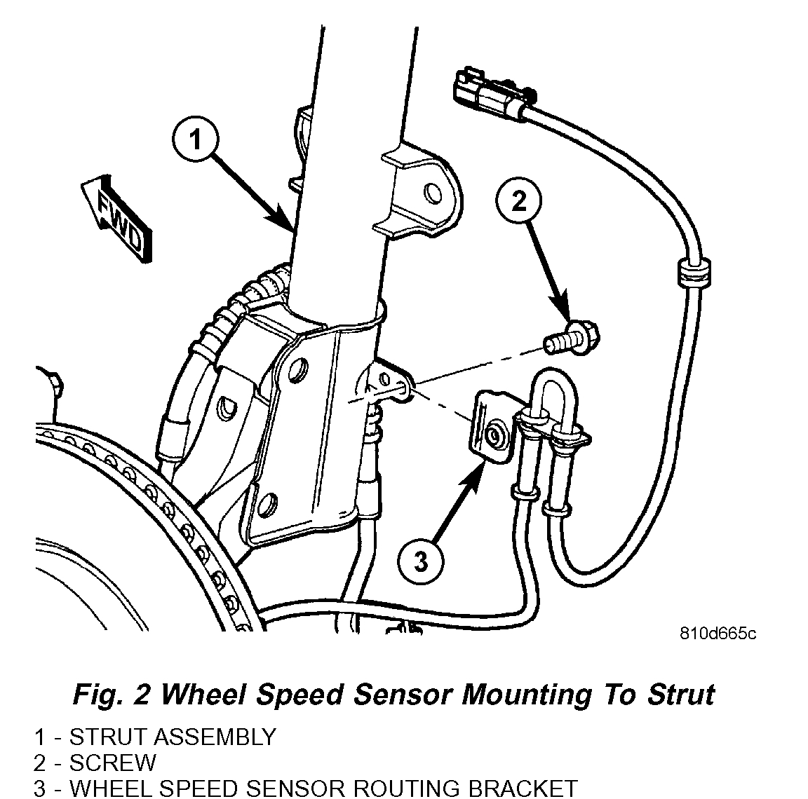

pic 2
4) Remove screw fastening wheel speed sensor routing bracket to strut assembly (Fig. 2).

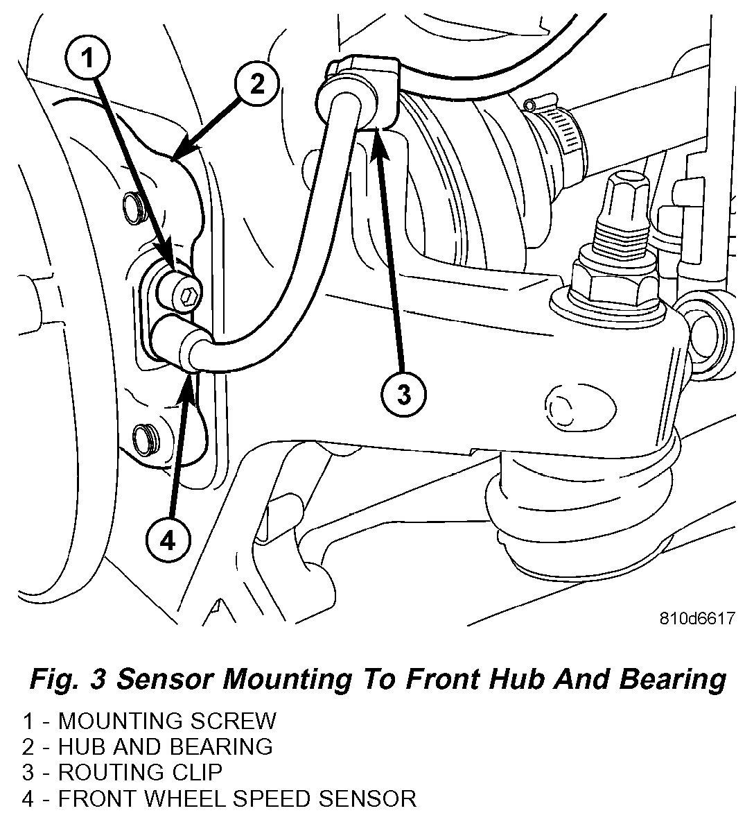

pic 3
5) Open routing clip at knuckle and remove wheel speed sensor cable (Fig. 3).
CAUTION: Prior to removal, clean area around sensor head to help prevent contaminants from entering bearing when sensor head is removed.
6) Remove screw fastening speed sensor head to hub and bearing (Fig. 3).
7) Remove wheel speed sensor from hub and bearing.
