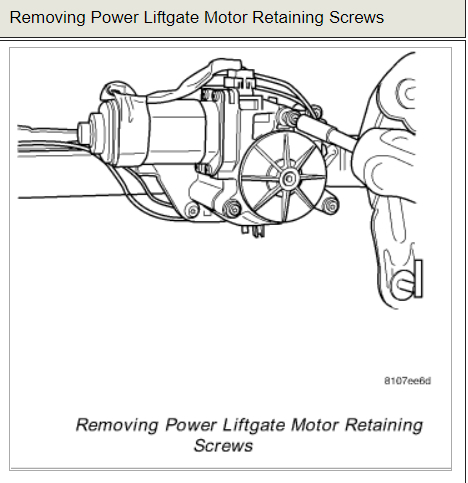

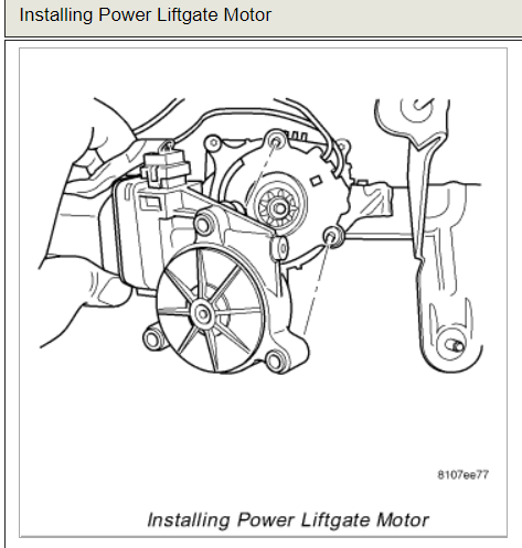

i also have trouble with my lift gate. i bought a pacifica for parts and the liftgate was working and i thought that on mines it was a bad liftgate motor and switched it and all good now here are the diagrams I used to fix the problem (below)
