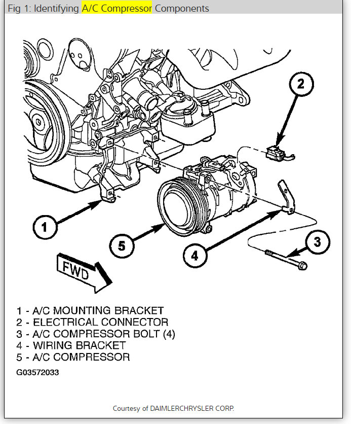

This happens when the compressor clutch coil is going out. Here is a guide to help you change the compressor out to fix the issue:
https://www.2carpros.com/articles/replace-air-conditioner-compressor
Check out the diagrams (below). Please let us know what you find.
Cheers

I had this problem as well, had to have the compressor replaced for $560.00 all fixed!
