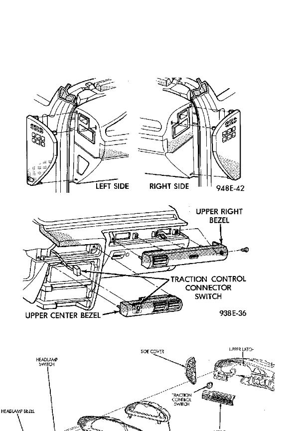

MARACOLLENDER
Can you give me the steps to changing my indicator bulbs in my 94 Chrysler LHS. I need to know how to take off the dash and where the instrument cluster is.
Aug 27, 2020 at 11:38 AM (Merged)
CARADIODOC
  • 34,306 POSTS
The furthest back I can go is a '96 model, but the instructions should be the same:
To service any instrument cluster component, the instrument cluster must be removed from the instrument panel. Use the following procedure:
1. Remove instrument panel left end cap End Caps
2. Remove instrument panel headlamp bezel.
3. Remove headlamp switch screws and move switch to allow clearance for the instrument cluster removal.
4. Remove instrument panel upper center bezel Center Bezel
5. Tilt steering column down into the lowest position.
6. Remove instrument panel cluster bezel. New Yorker/LHS only, disconnect the message center wire connector. The message center lamps may be serviced at this time Cluster Bezel and Cluster Bezel - New Yorker/LHS
7. Remove instrument cluster screws and disengage upper latch
CAUTION: Pull steering wheel down to gain access for instrument cluster removal.
8. Remove instrument cluster from panel. The instrument panel wiring harness connectors are mounted directly to the rear panel. A force of approximately 9 kilograms (20 lbs.) will be required to disengage the cluster from the connectors.
