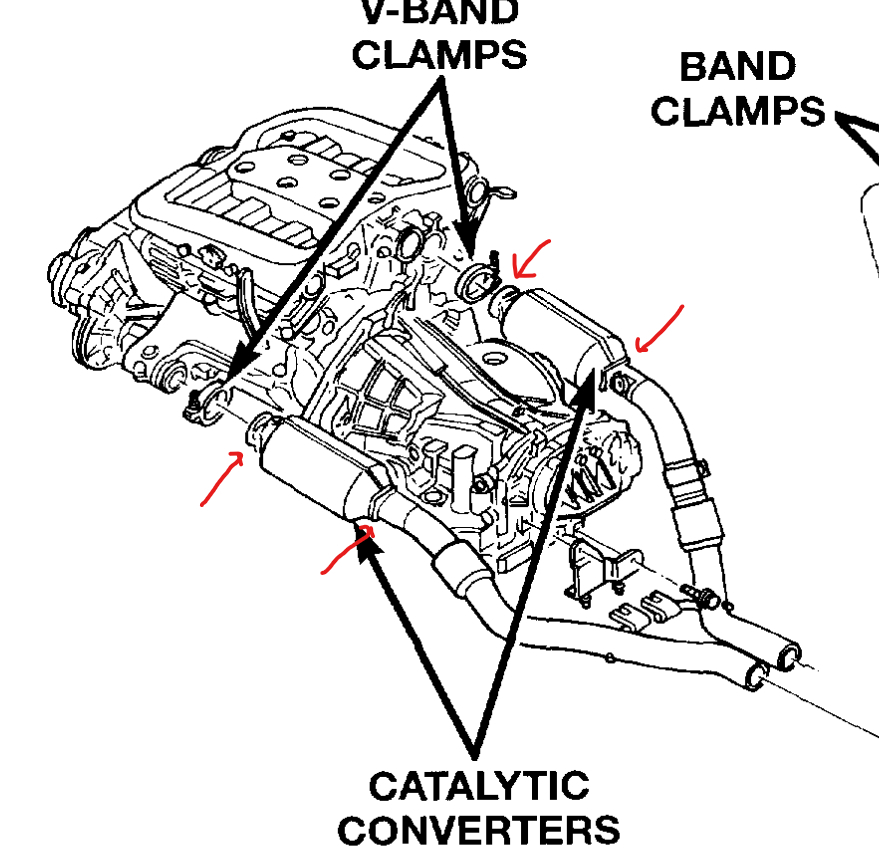

For the first code I would replace the battery and clean the battery cables, this guide can help:
1. P1684: Battery Disconnected Within Last 50 Starts
2. P1289: Manifold Absolute Pressure (MAP) Sensor Circuit High Input
3. P0172: System Too Rich (Bank 1)
For the second and third code it sounds like you have a partially clogged catalytic converter. To be sure here is a guide to help as well, you might need to raise the car up for testing after the test drive.
