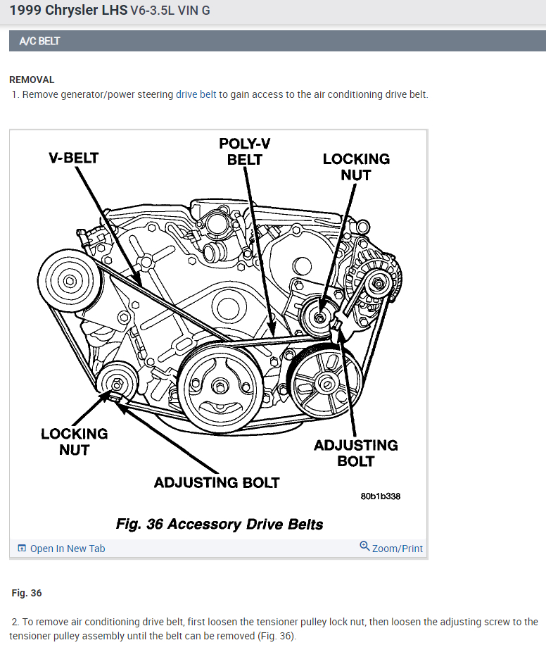

How do I turn the tensioning pulley to loosen the accessory belt so I can remove it so I can replace the air conditioning belt? I loosened the locking nut and am supposed to turn the tensioning pulley counter clockwise to take the tension off. I can't turn it by hand.
