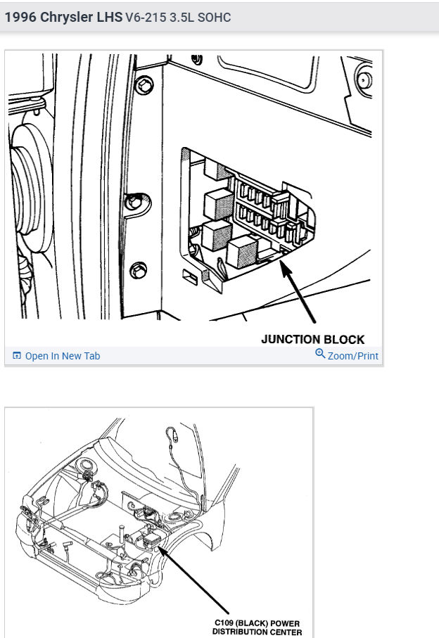

There are 2 fuse boxes on this vehicle.
One is under the hood on the driver's side and the other is located inside the passenger compartment, on the left end of the dash.
I have attached the diagram below for your reference.
Thank you.
