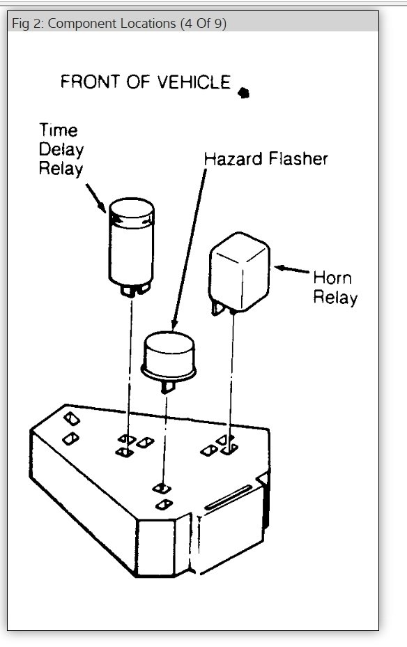

Need to know the location for the turn signal/hazard flasher - not in fuse block or under dash. What other locations could this be found?
Thanks
Apr 27, 2008 at 11:45 AM
Hey DENNIS69
Behind left side of dash, mounted on left air outlet duct. It is the time delay relay.
