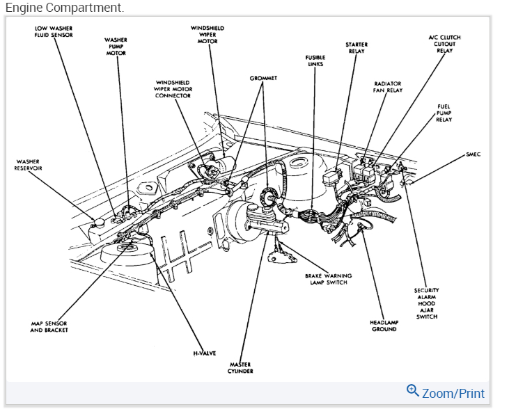

So I changed the fuel pump before I tested it. The old one worked but I cannot return the new one. After testing both fuel pumps I realized that there is no power going to the fuel pump. What can I do? Is this common for this car?

It sounds like the fuel pump relay is not working. Here is a guide to help you test it and the location of the relay below:
Check out the diagrams (below). Please let us know if you need anything else to get the problem fixed.
