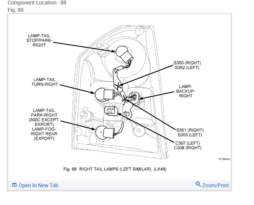

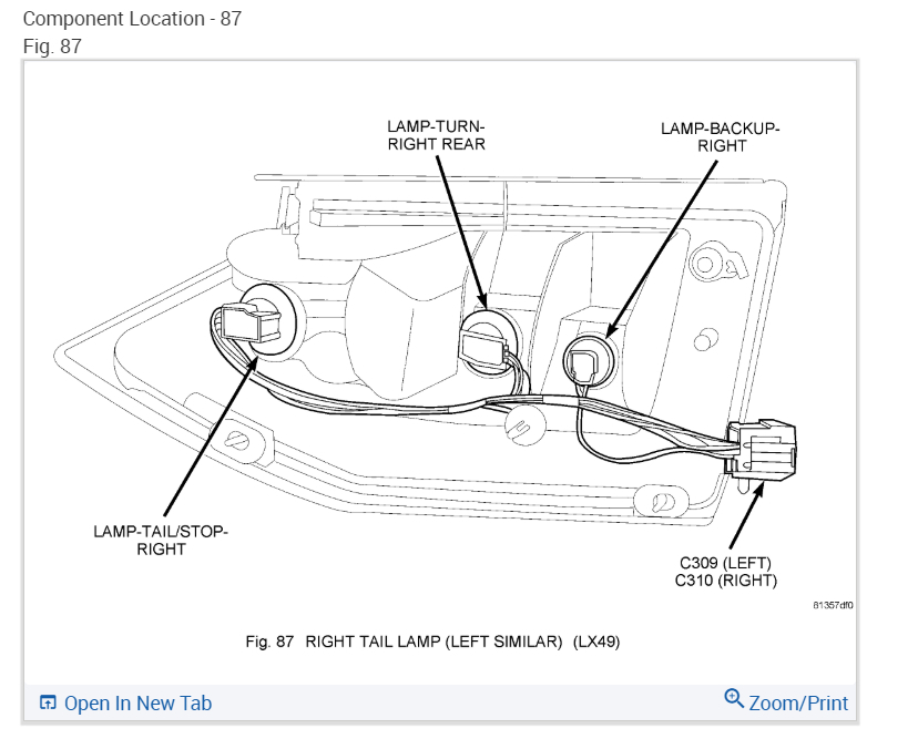

go in the trunk and look up where the light is and they should turn out and down. then pull the light out to replace it. Here are diagrams and instructions below.
https://www.2carpros.com/articles/brake-lights-not-working
Check out the diagrams (Below). Please let us know what happens.
