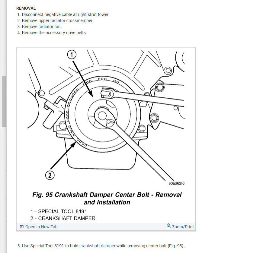

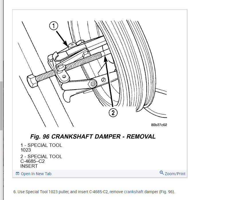

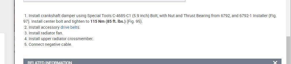

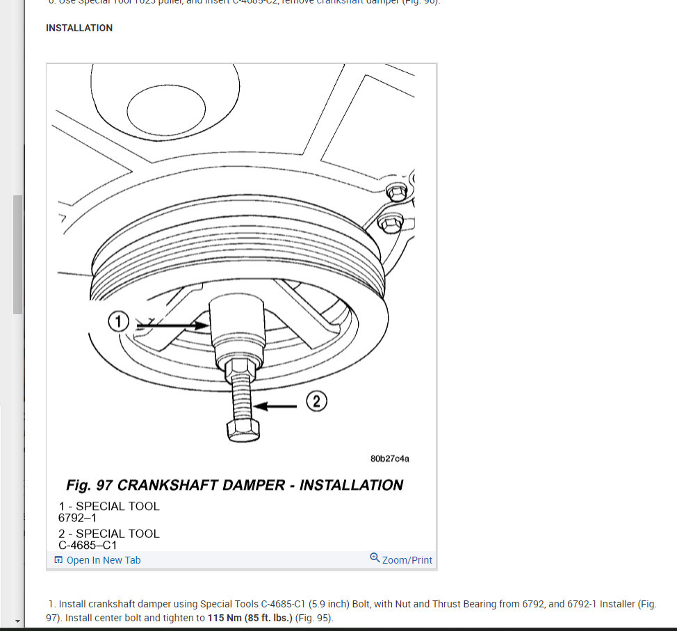

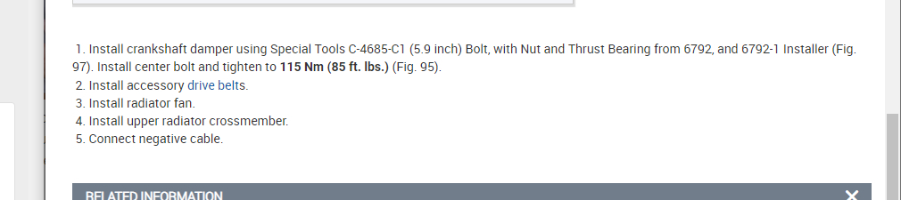

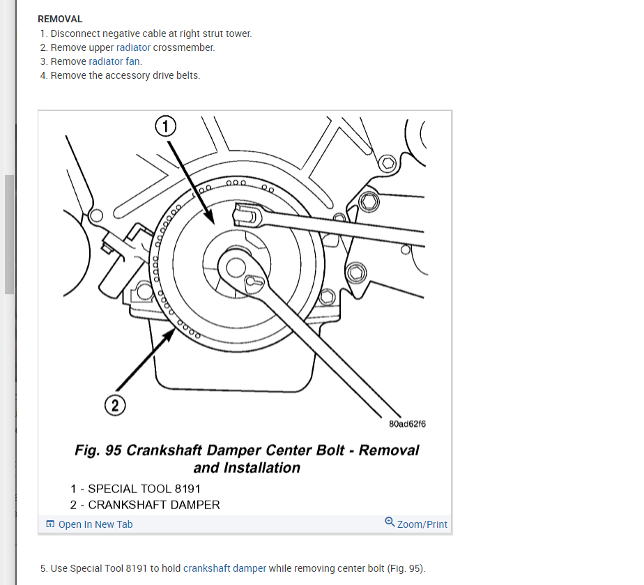

Here is a guide that will help with replacing this:
https://youtu.be/WITN7Q8SX1U
I am attaching the process below on how to replace the balancer. Please run through this info and let us know if you have other questions. Thanks
