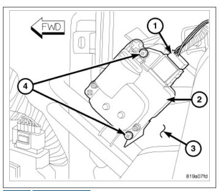

This is a common problem, the driver side of the blend door actuators has gone out, here is a guide to walk you through the steps of replacing it and diagrams on which one to replace in your car int he diagrams bbelow.

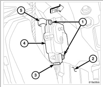

Here is the only image Mitchell1 gives us, once you have it removed turn the heater on and work the blend door by hand to see what it does to make sure you have the right one
Please Let me know.
Dec 4, 2016 at 5:19 PM

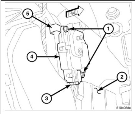

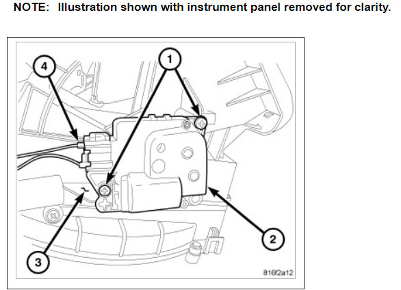

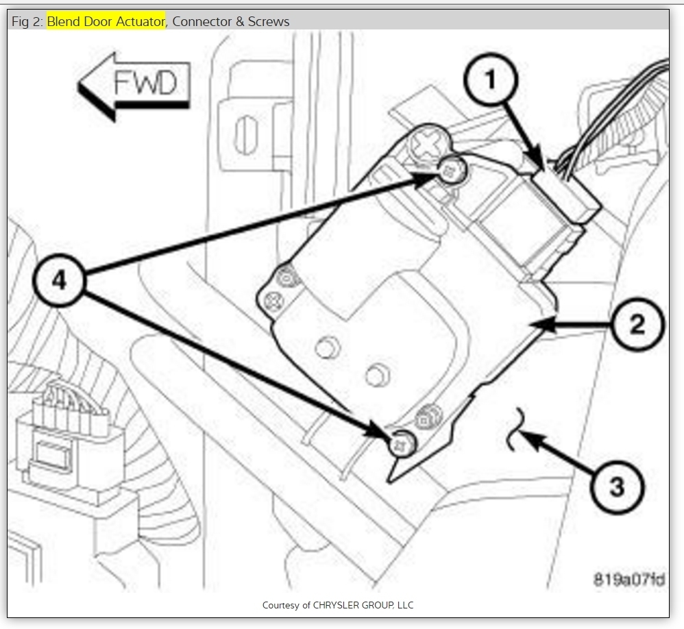

Here are more diagrams to help you see where the locations of the blend door actuators are located. Check out the diagrams (Below)
