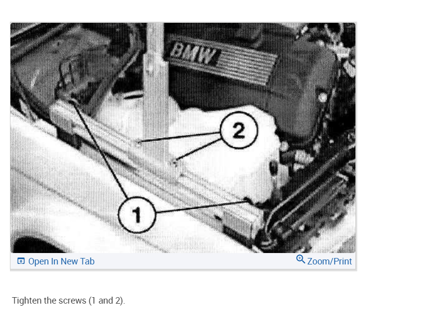

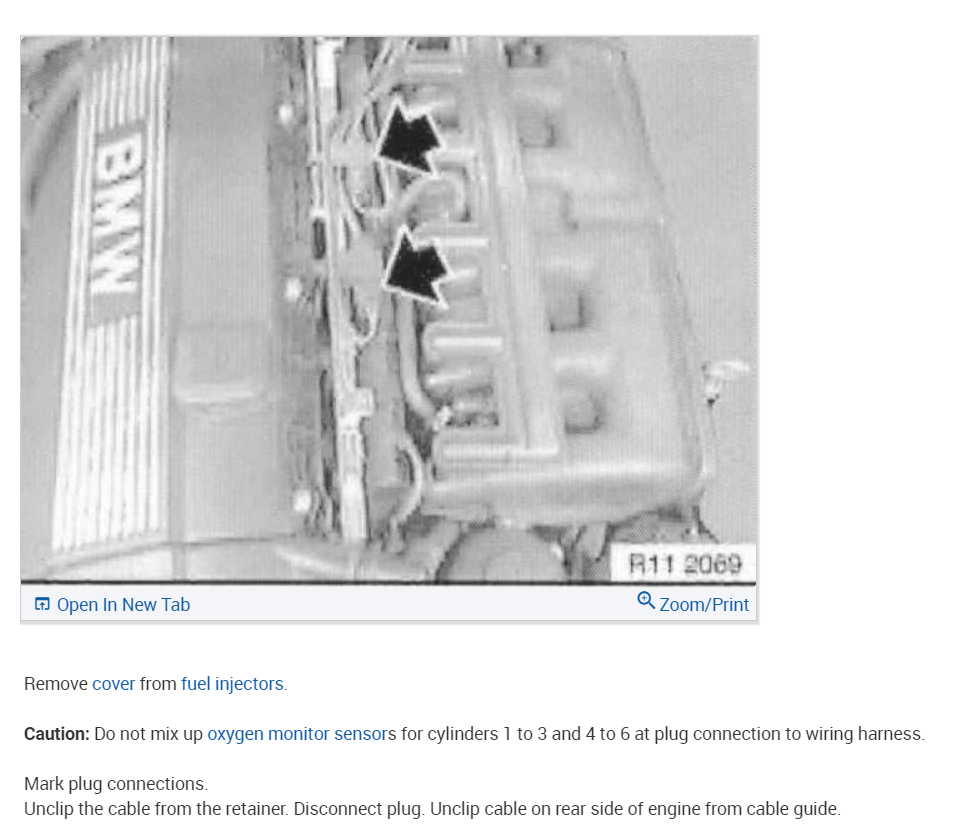

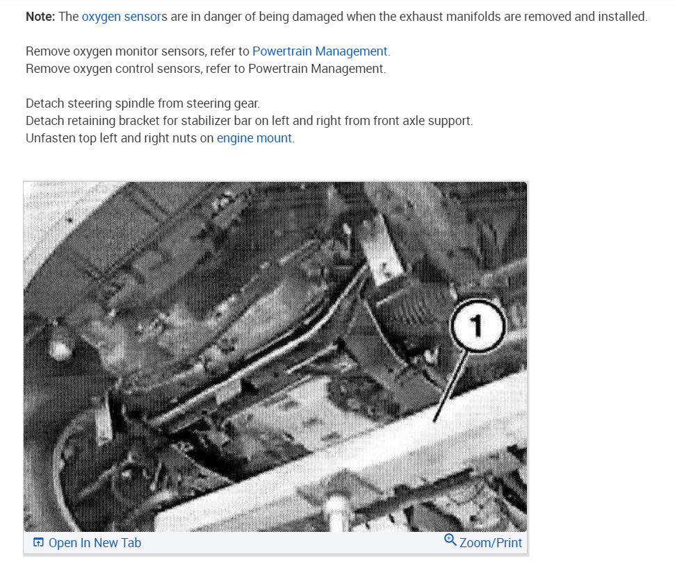

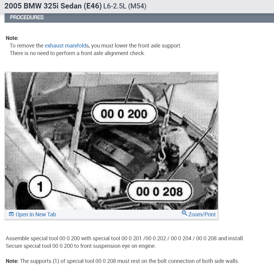

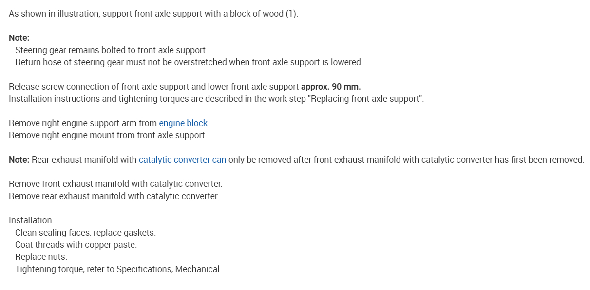

Hello, so after some investigations it seems it could indeed be a leak around the exhaust manifold. I'll have to wait a few months to get it done because I don't have any room at home and unfortunately and I can't drive right now for reasons.
