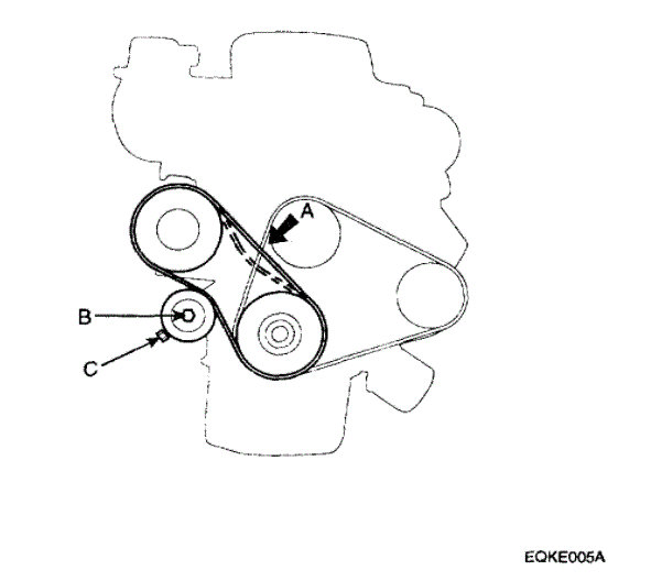

Okay, I would check the belt tension to be sure they are tight. If they are loose, this noise will happen.
