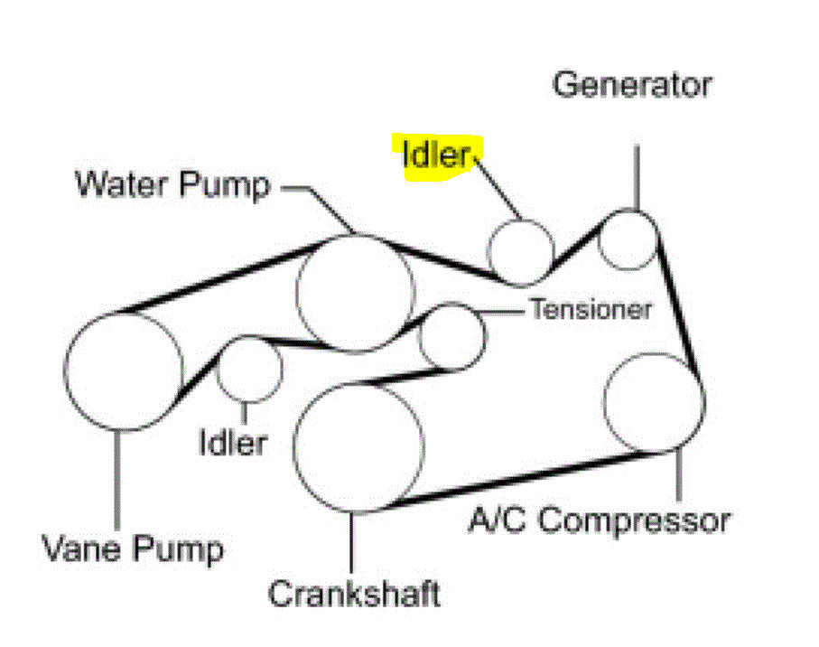

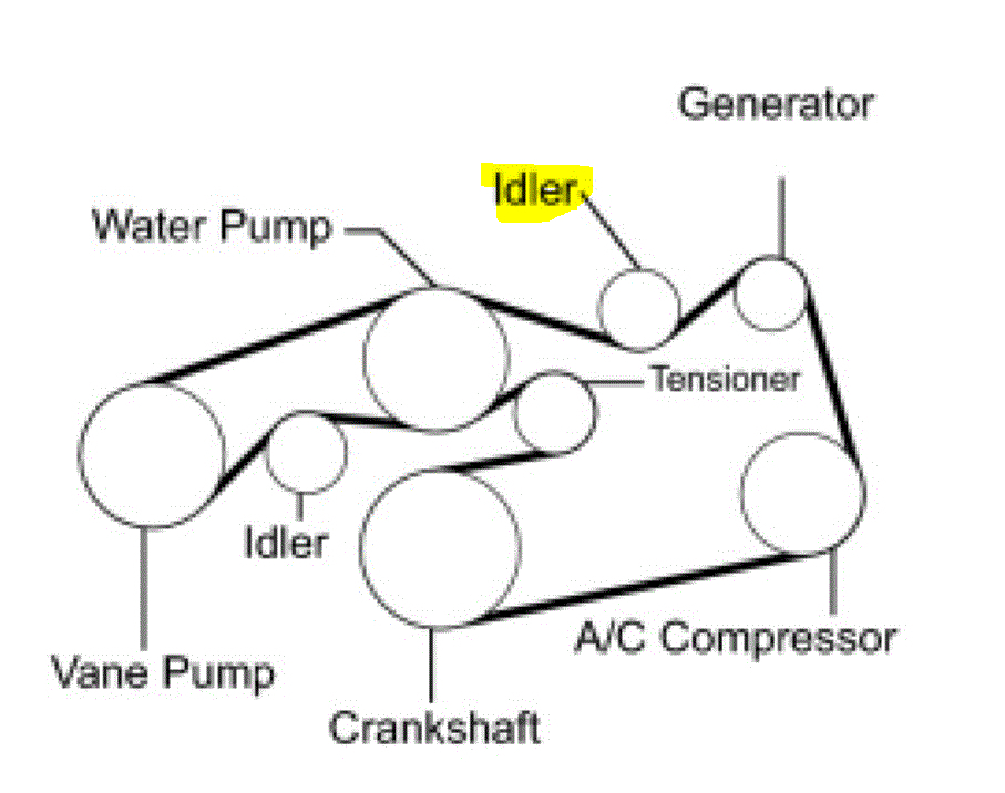

I attached a pic below with the belt routing.
