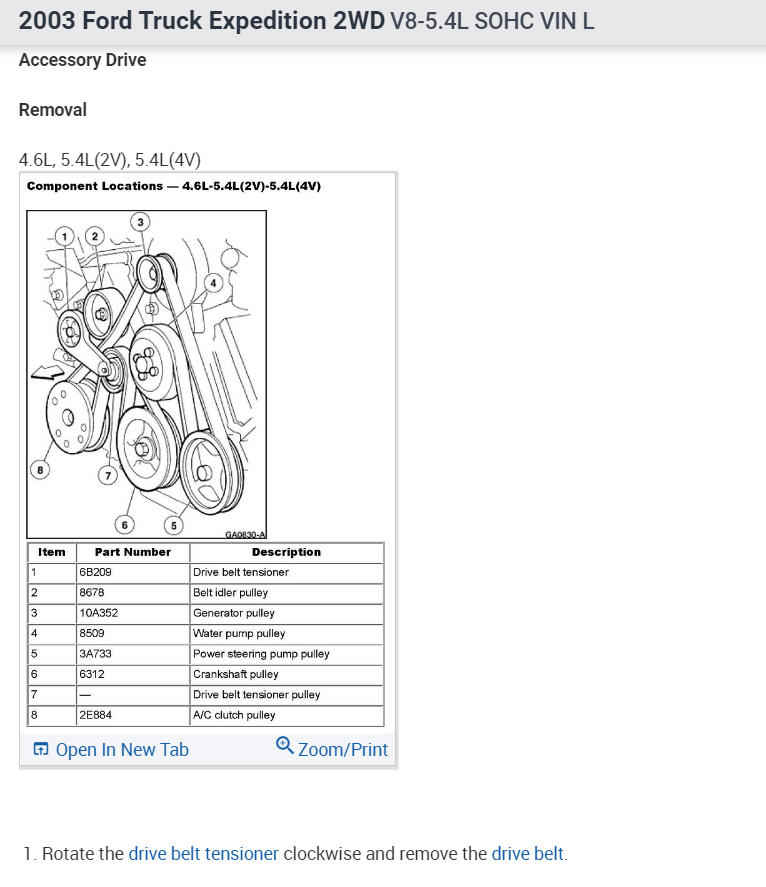

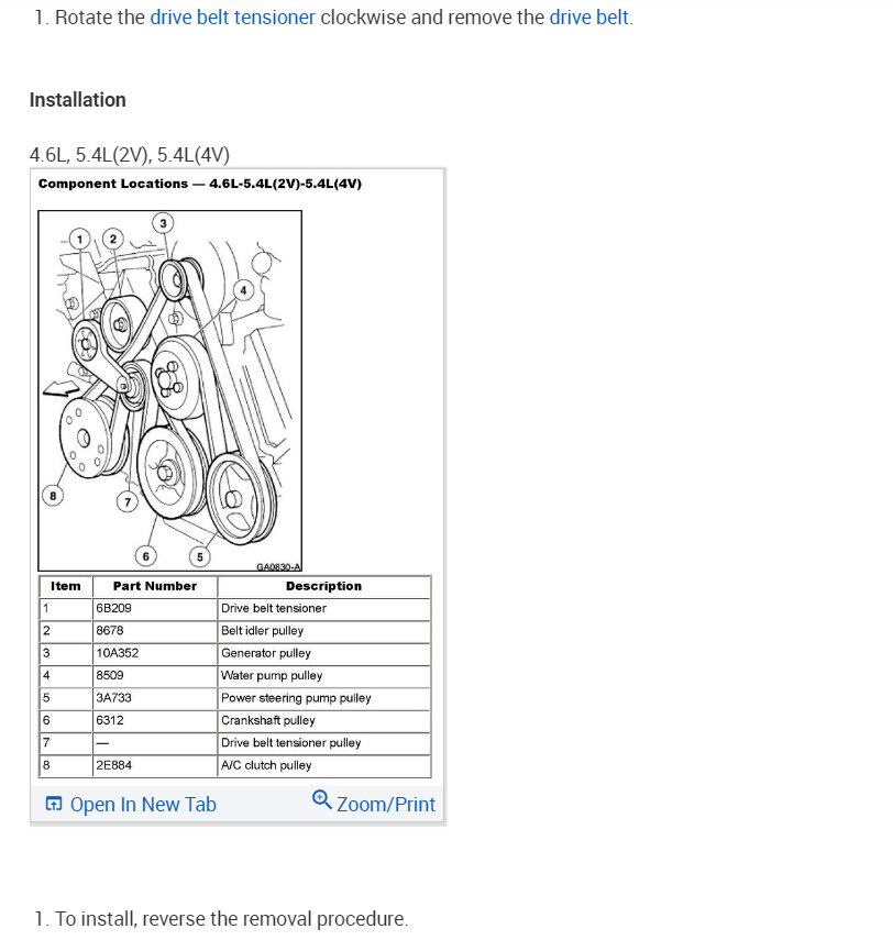

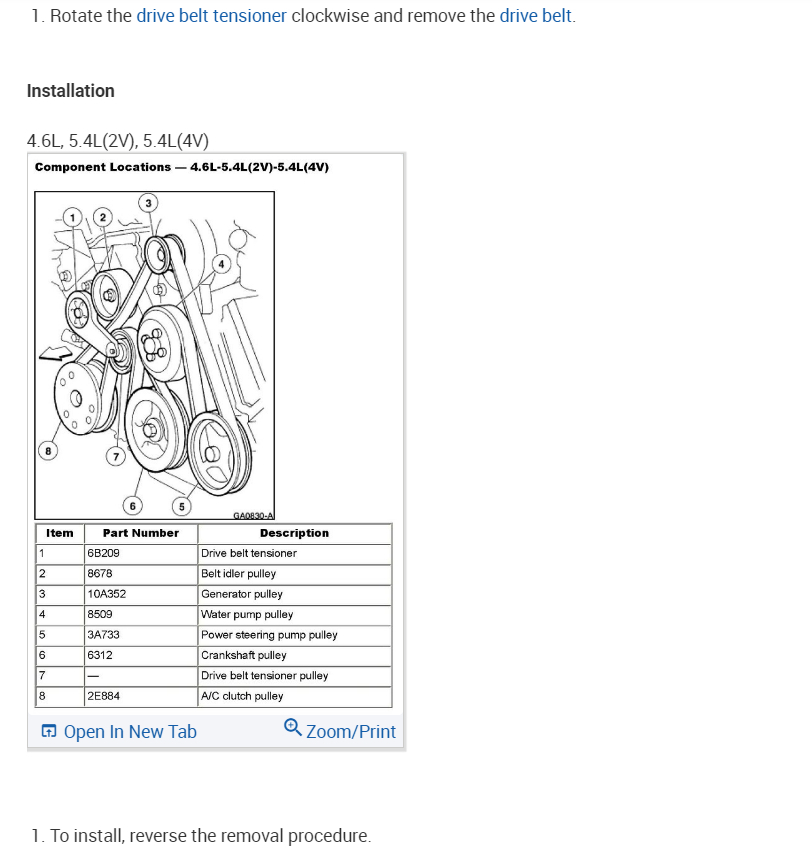

This sounds like it could be a serpentine belt or tensioner pulley noise. Can you please shoot a quick video with your phone so I can hear the noise? That way I can tell for sure what's going on. You can upload it here with your response. I would start by installing a new serpentine belt.
Here is a guide to help and the instructions for your car in the images below:
https://www.2carpros.com/articles/replace-serpentine-belt

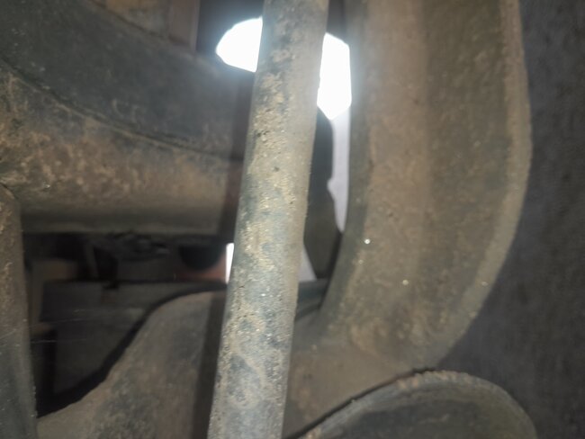

I just replaced them last week. It's there rear passenger CV axle is bad the boot on the inner part towards the differential is complete gone.

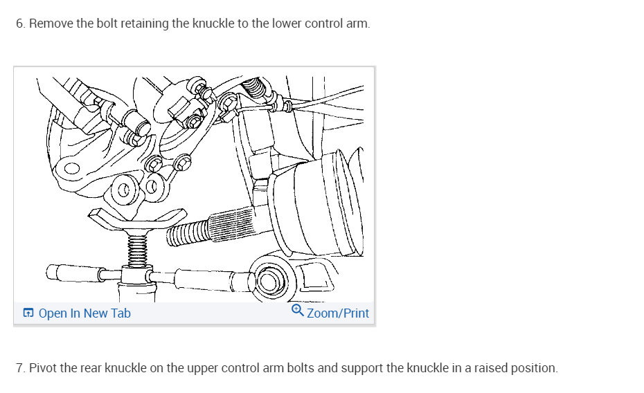

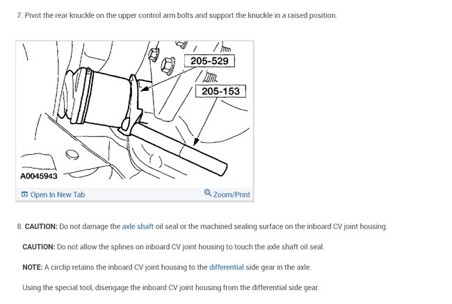

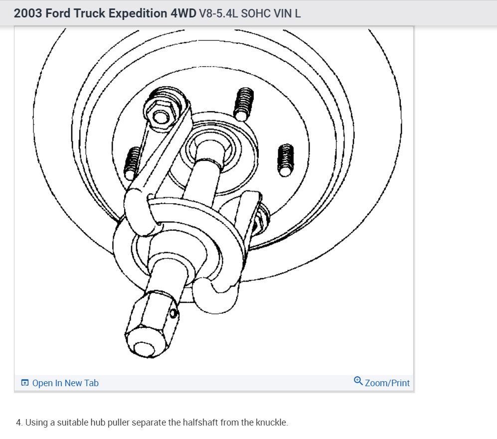

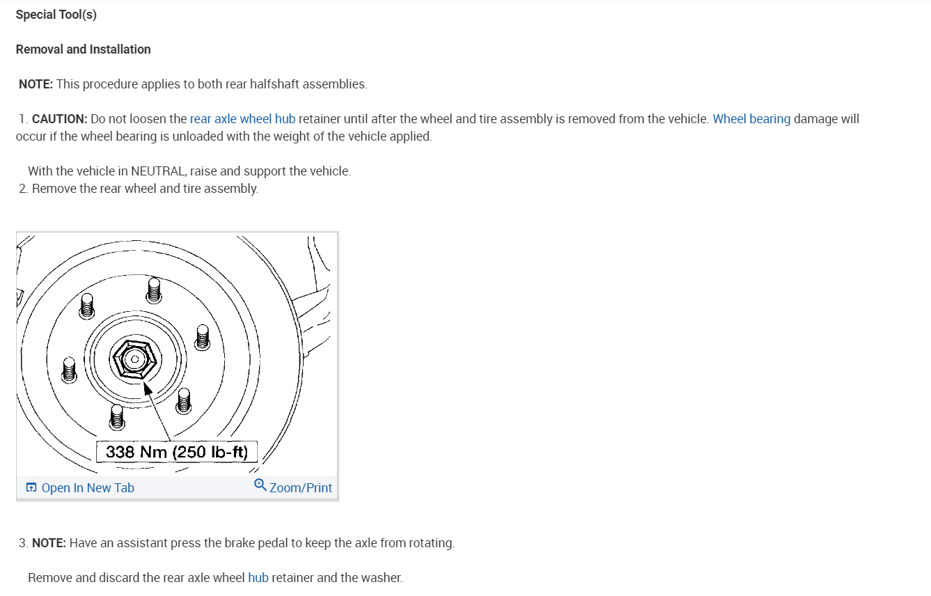

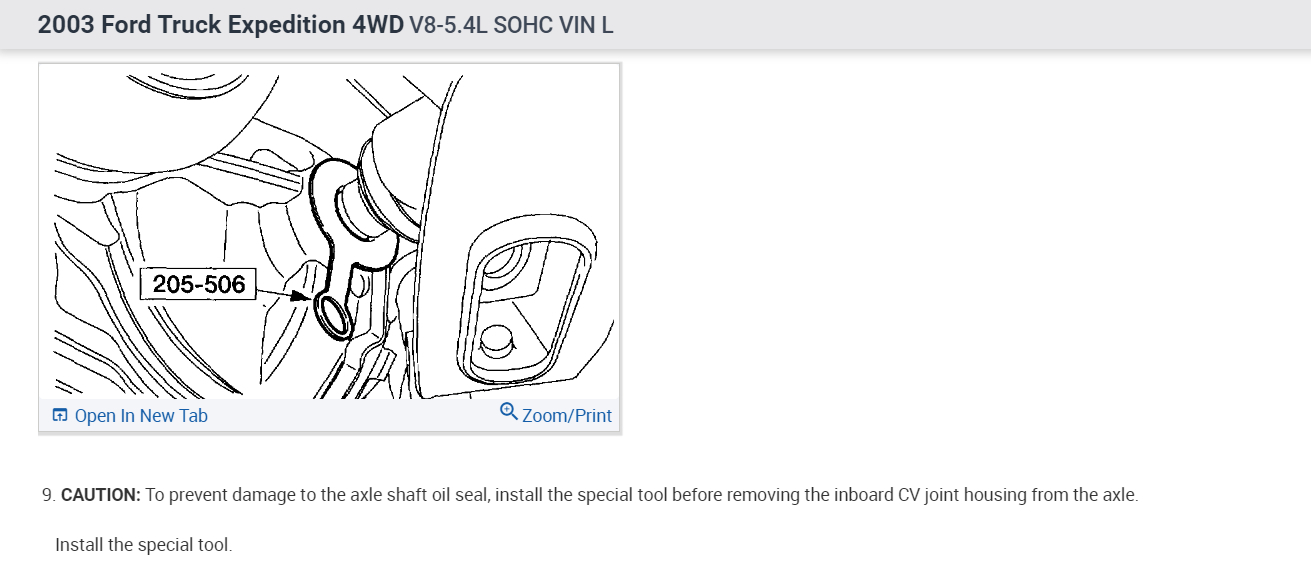

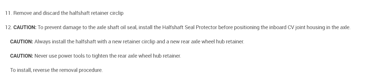

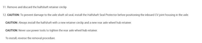

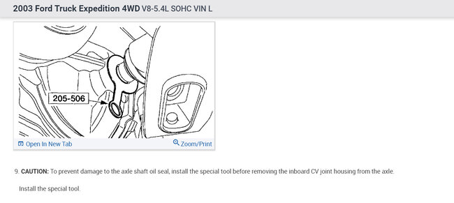

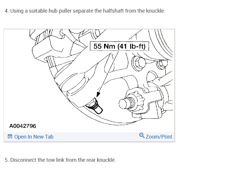

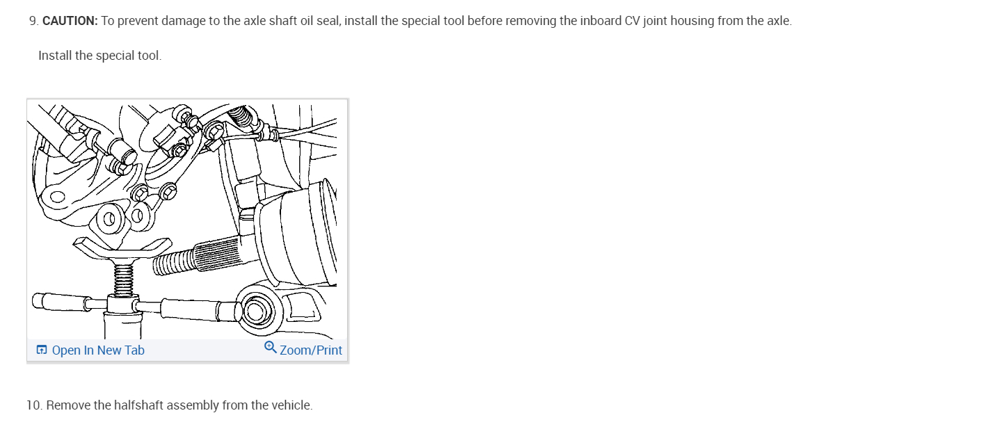

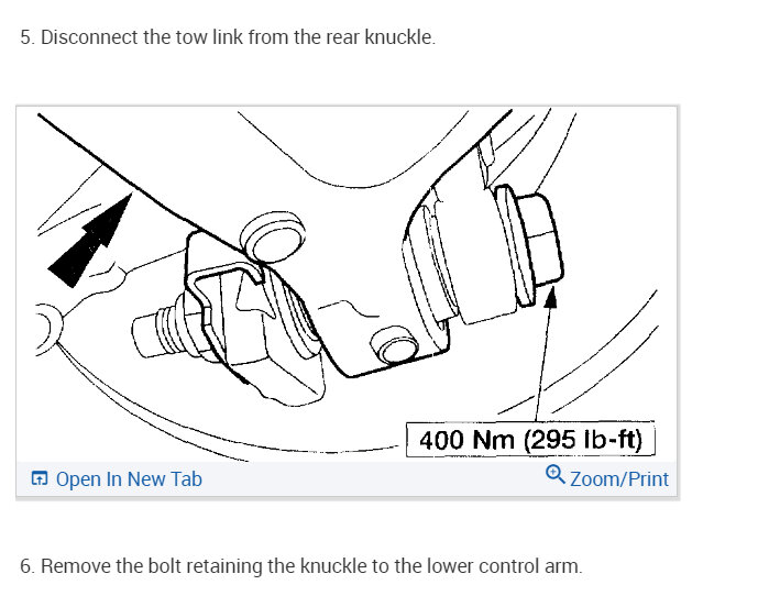

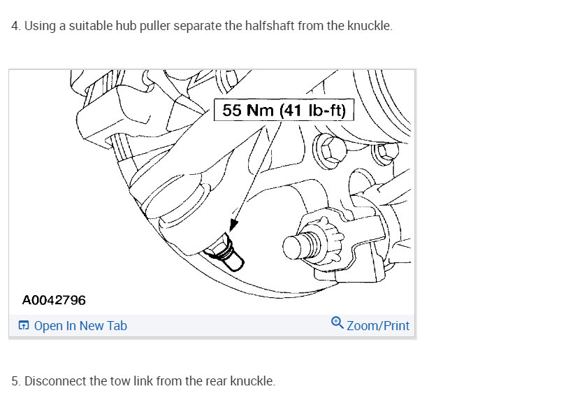

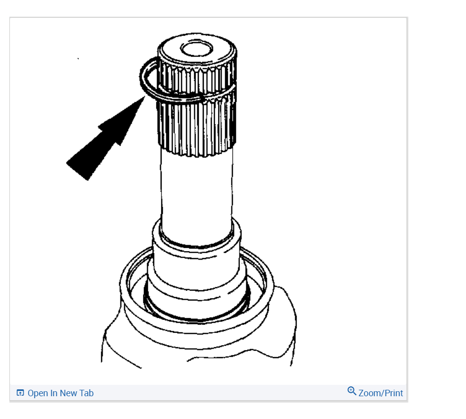

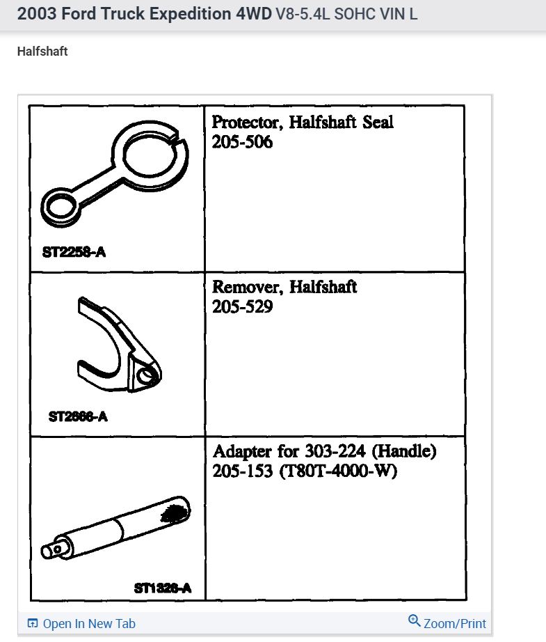

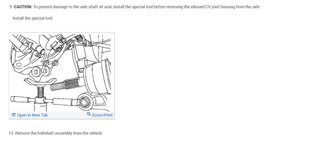

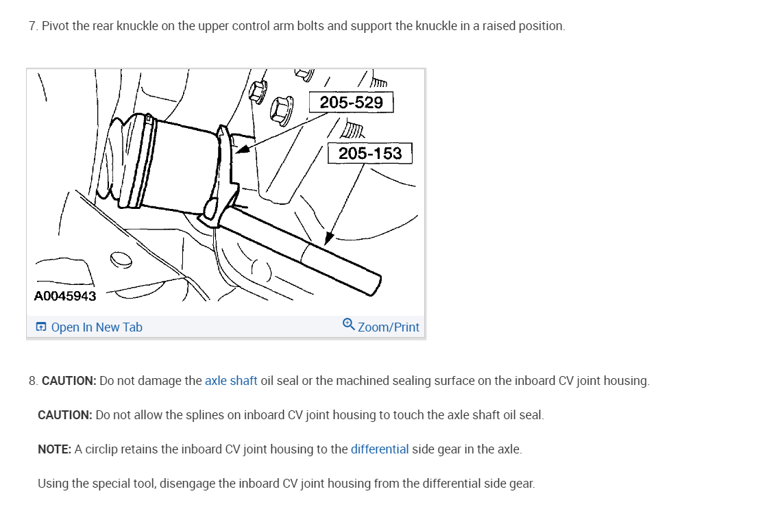

Good find. Here are the instructions on how to replace the rear CV axle. Check out the images (below). Please let us know if you need anything else to get the problem fixed.
