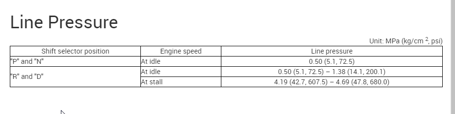

I ask because the noise may be from the serpentine belt. If is definitely in the transmission then this is more than likely due to the fluid quality or the pump is not producing enough pressure. The chirping noise that you are hearing is from the clutches in the transmission not fully engaging in the needed amount of time to not make the noise.
This is assuming you do not have the CVT transmission. I see it is an option and if it does have this unit then this noise is the steel belt. As your transmission does not have clutches.
