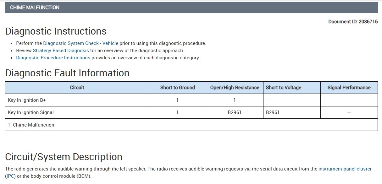

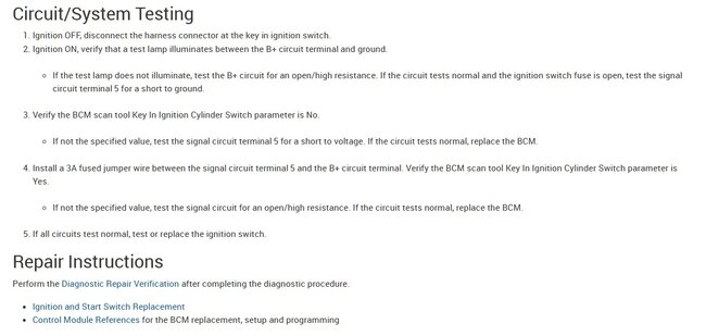

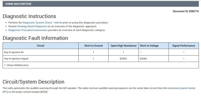

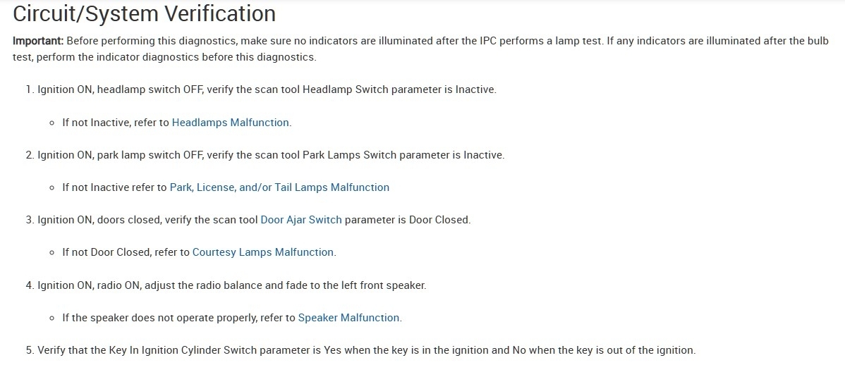

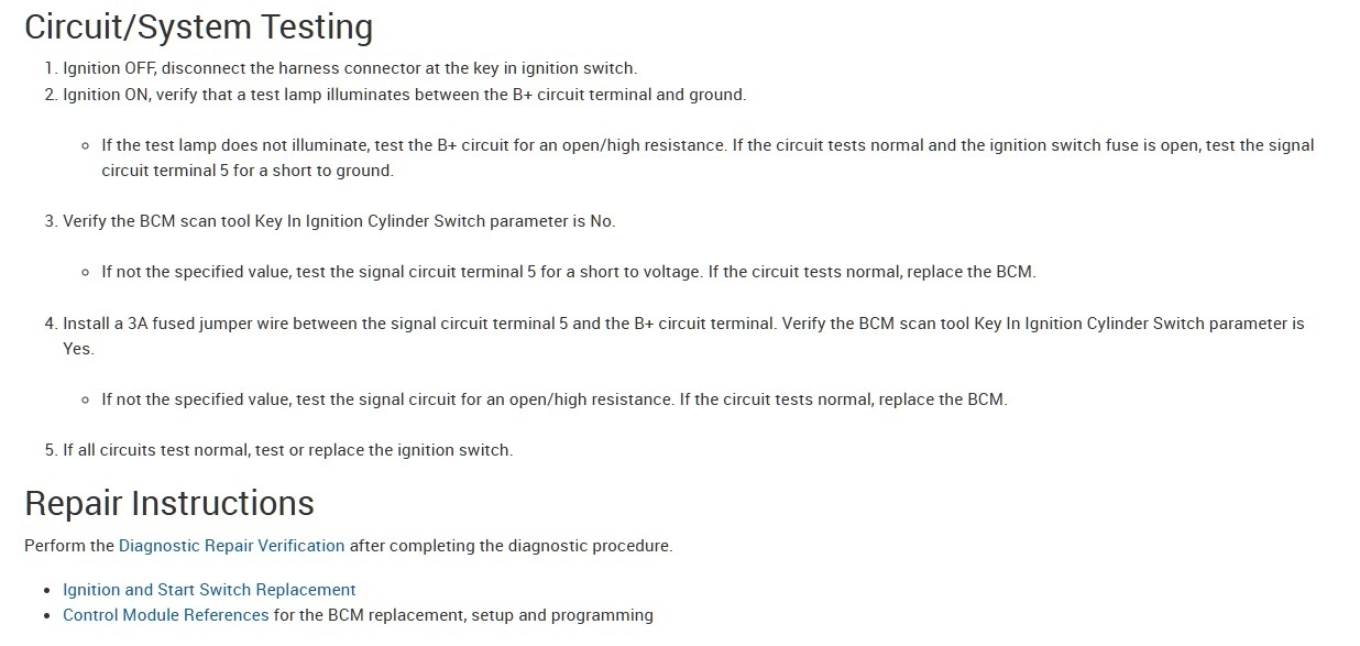

This is the service info for a "Chime Malfunction". But to begin with I would go through with a test light and check every fuse in the vehicle. Engine compartment fuse box and the one under the dash with the key On, see if you have a blown fuse.
Was the battery disconnected when doing the Alternator replacement?
