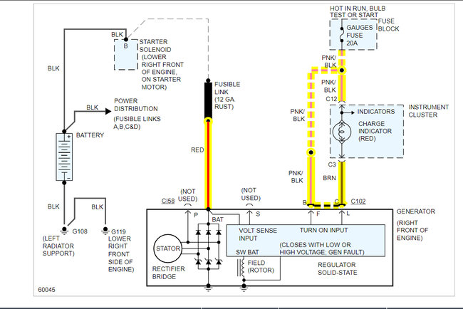

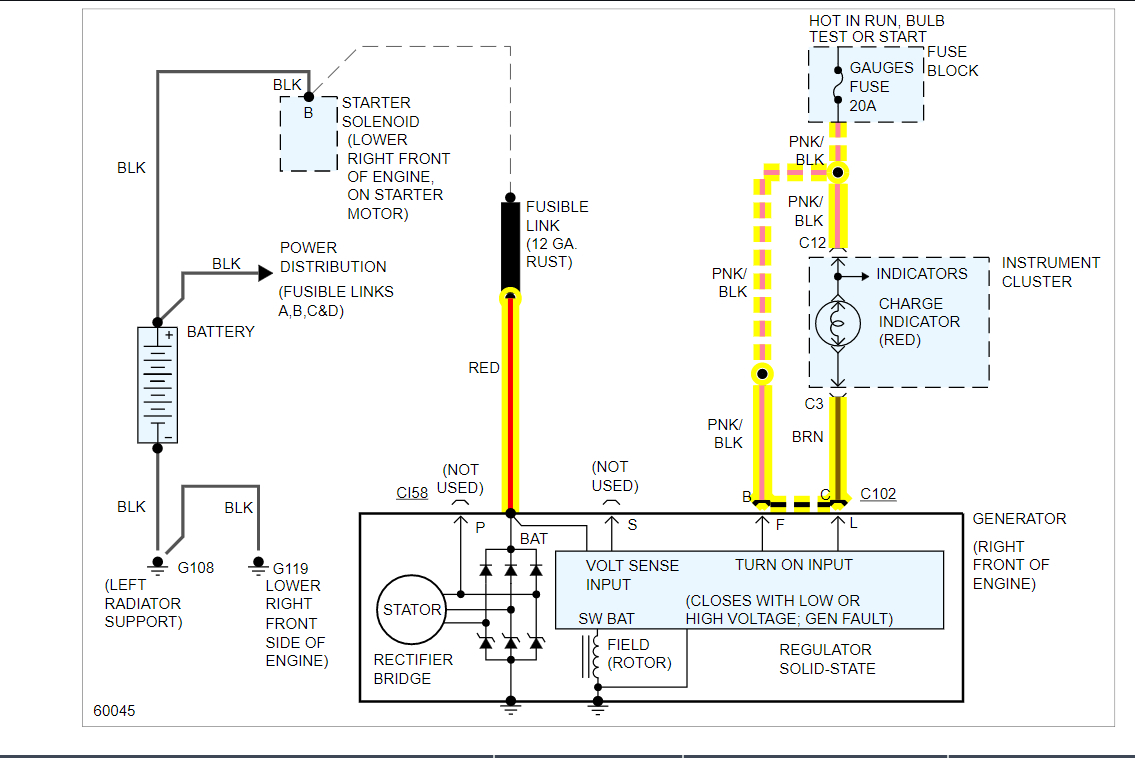

Hold on. You have 12 volts on the brown wire with the plug connected. That has to come through the fuse you said is blown. Do you also have a pink / black wire in that plug?
Unplug that connector, then, with the ignition switch on, tell me what you find for voltage on the brown wire, the pink / black wire, and their two mating terminals in the plug on the back of the generator. Is the fuse still blown or removed? Does that fuse blow when the plug is disconnected at the generator?
