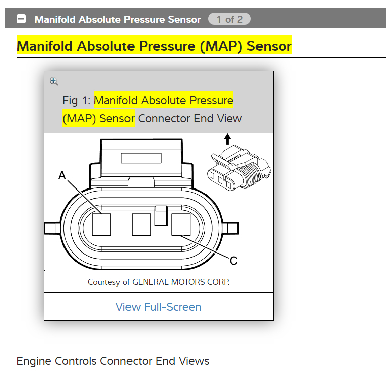

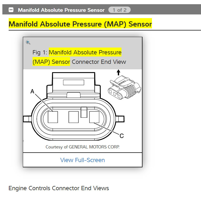

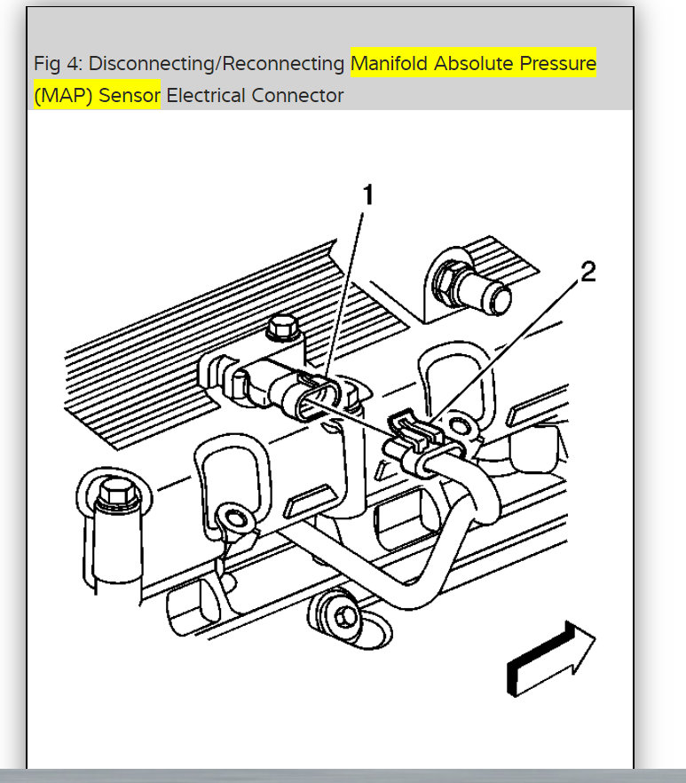

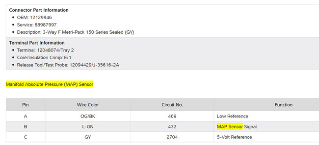

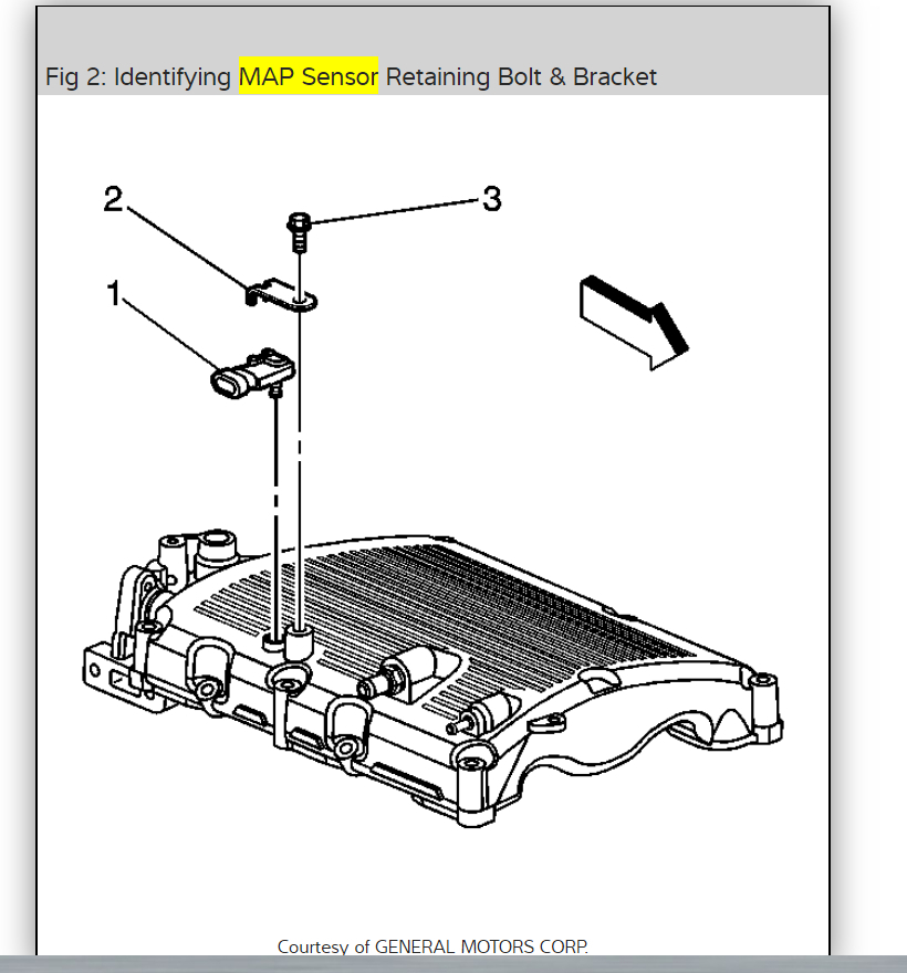

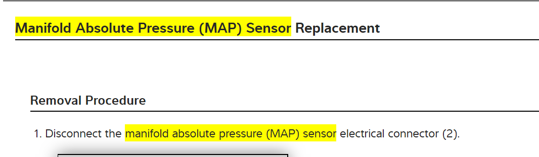

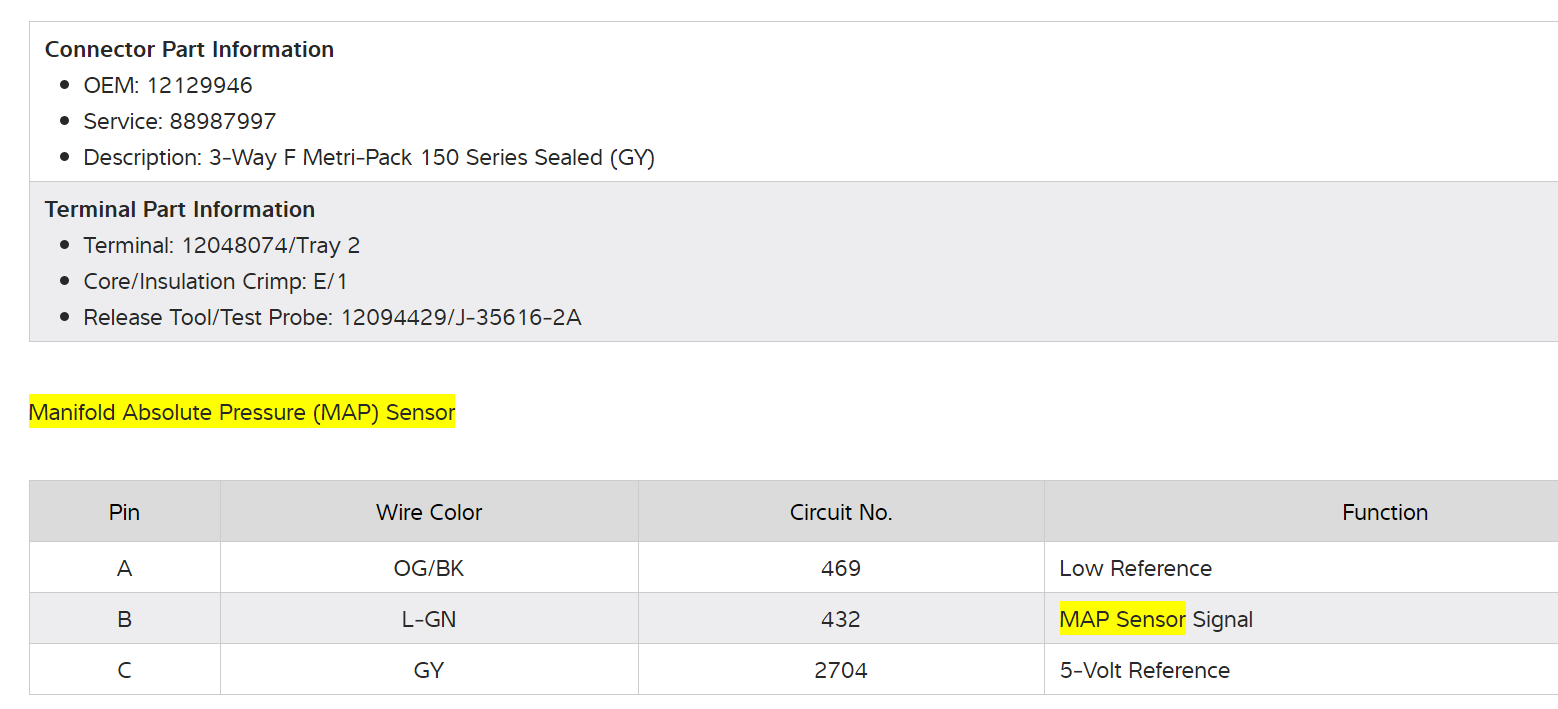

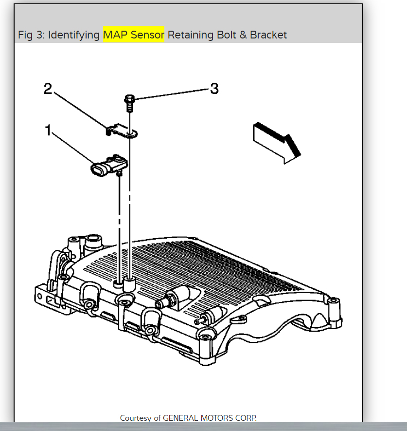

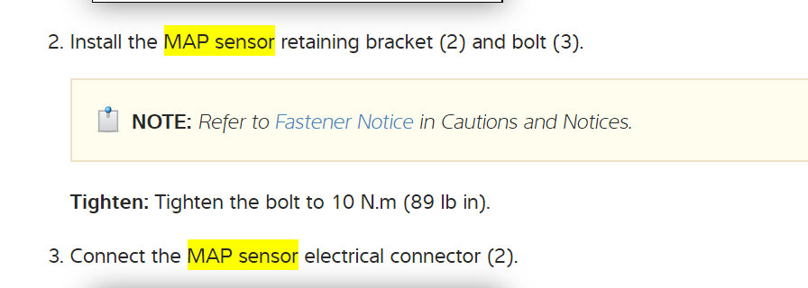

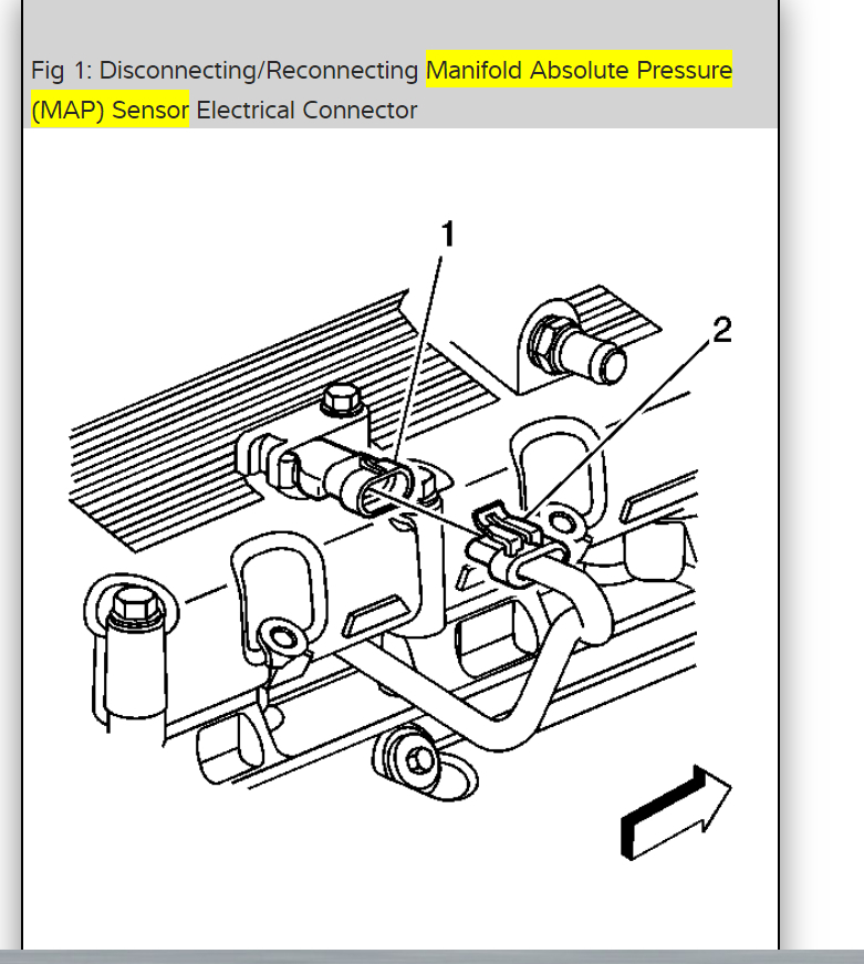

I have included the information that you have requested in the diagrams down below. I have the component connector information, as well as the location of the MAP sensor, and step by step removal and installation instructions for you to go through. Please go through these guides and get back to us with what you are able to find out.
