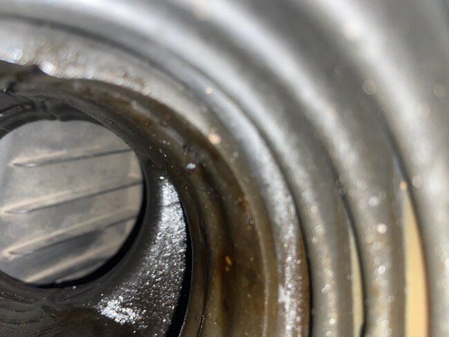

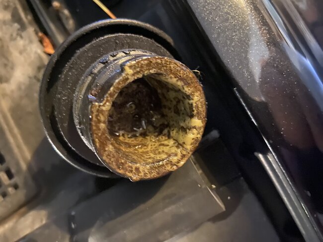

Hi Ken. I took your recommendations and checked for a blown gasket before going through the trouble of replacing the water pump. On step one of checking for a blown gasket, it described a milky substance in the oil which would be coolant mixed with the oil. I remembered seeing some of that when I replaced the thermostat. I went back in and checked the car to see if I could find something to show you and the oil cap is probably the best indication of something going on. The other picture shows a little bit of milky substance in the bottom left-hand corner. It was much worse when I originally open that up, but I cleaned it up. Is that evidence of a blown gasket and if so, what do I do? If it’s not that, what could it be and what should I do?
Feb 11, 2024 at 10:20 AM
Yep, that oil cap is telling us blown head gasket, sorry. Thanks for the images. I can upload images of the instructions if you want to try and fix it?
