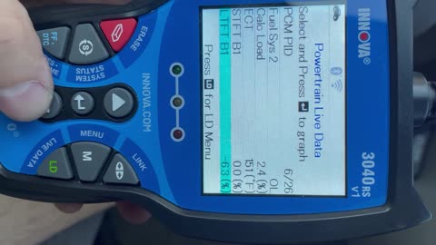

The vehicle listed above is a K2500. This car has sat for 10 years with no start. I drained the fuel tank, cleaned it out and installed a new fuel pump. I installed a new fuel filter as well. Other parts that have been replaced are the MAP sensor upper intake manifold gasket, spark plugs, spark plug wires, oil, serpentine belt tensioner, fuel pressure regulator, I cleaned out the injectors as well. Cleaned out the MAF sensor put new fuel in with fuel additive. Code p0106 keeps popping up and I was getting a code p0300 as well sometimes. The car is running rich i can tell be short term fuel trim is very negative. I’ll attach a video with some live data and the sound of the engine. Later in the video I rev it to 2,500 RPMs and 3,500 RPMs and show fuel trims.

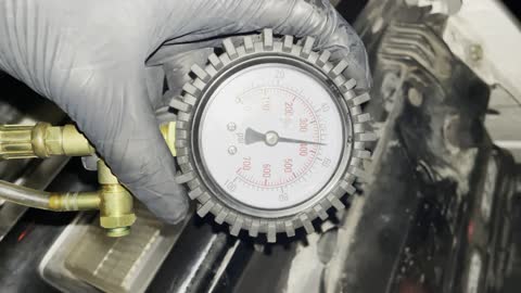

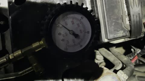

Here is a video of the leak down test and also the car at idle. The gauge is bouncing around is that normal?
Dec 9, 2023 at 7:19 PM
The gauge shouldn't do that. I suspect the cylinder 6 injector is faulty. When you removed and cleaned them, did you check the spray?

So, I ended up doing a long leak down test of about 15 minutes and it initially dropped from about 50 PSI to about 40 PSI in a minute or two but then it held at 40 PSI at about 40 PSI only a very small drop for the next 14 minutes. I ended up pulling the upper intake manifold off so I could access the fuel pressure regulator and the I injectors. I jumped the fuel pump relay and removed the vacuum line for the fuel pressure regulator. It was not leaking. I also checked the injectors for leakage, and they were not leaking as well. Then I cranked the car over a couple times and all injectors were spraying and the spray pattern looked the same on all of them.

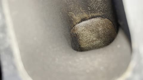

I am going to attach some videos. Of the distributor as well as the lower intake manifold ports where the injectors are located. I had have replaced the plugs and wires and used a spark plug tester and was getting spark to the plug when this initially started. Both on the bottom of the lower intake manifold where it only gets air not fuel and in the injectors port area were wet with what smelt like gas.

Here are the videos.

Something is leaking in the lower manifold. You shouldn't have what appears to be oil in there. Did the gaskets look good when you took it apart? Also, was cylinder 6 wet?

Cylinder 6 wasn’t wet but cylinder but cylinder 4 and 2 appeared to be wet. The upper intake manifold gasket looked alright, but oil didn’t run through that part. I didn’t take off the lower intake manifold because I will have to take out distributor and also take off fuel rail. Do you think it is the lower intake manifold gasket? Could that cause my rich condition though?
Dec 11, 2023 at 9:17 PM
I would think if there was a leak at the lower, it would cause a vacuum leak. That would result in a lean fuel mixture.
