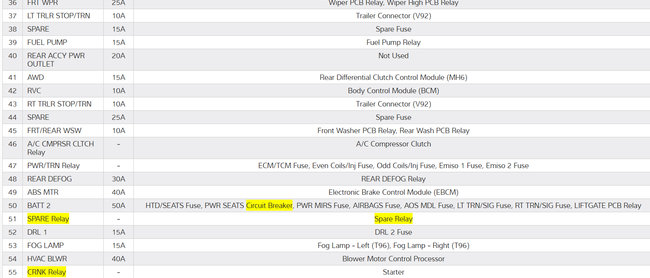

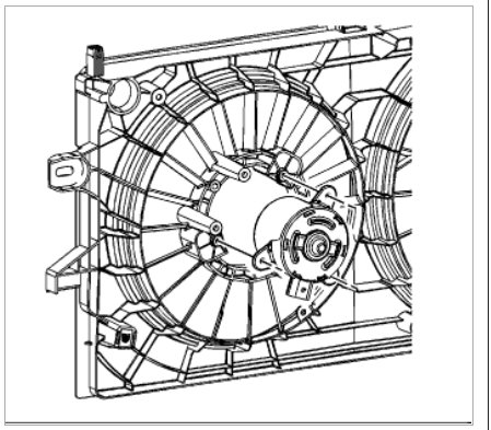

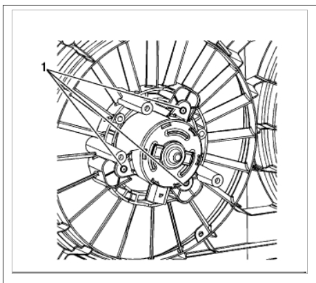

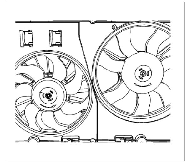

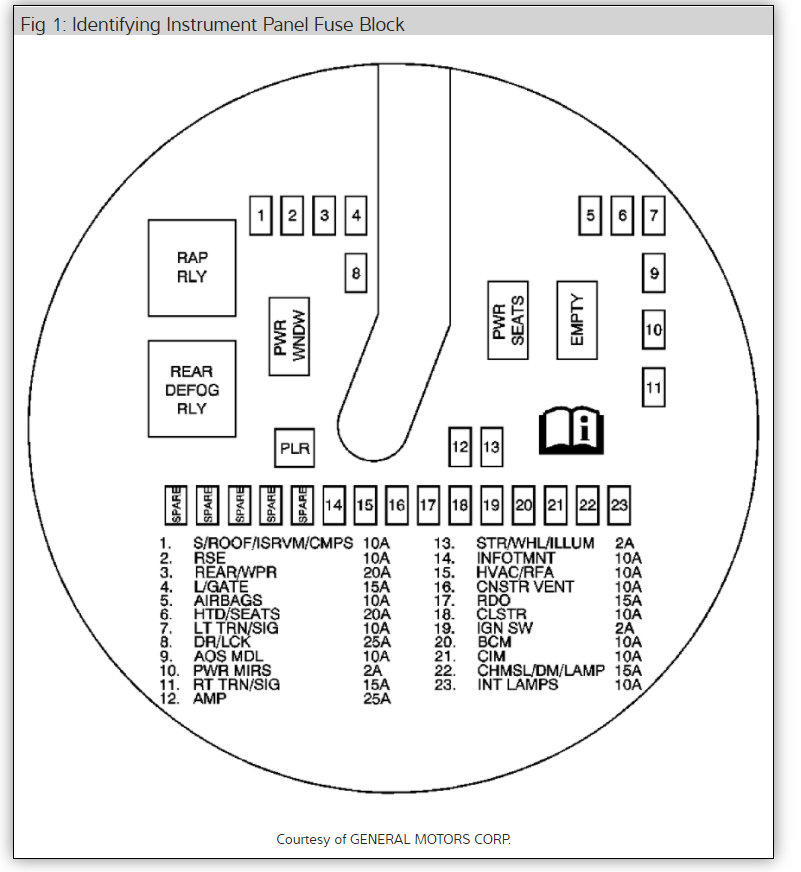

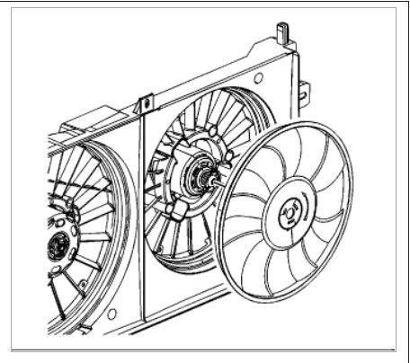

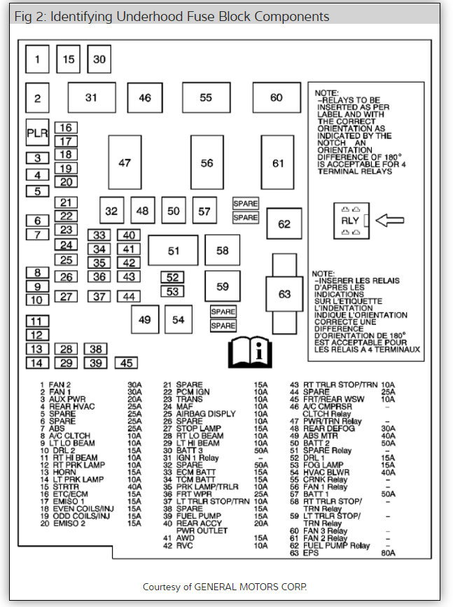

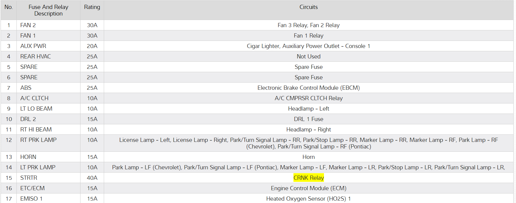

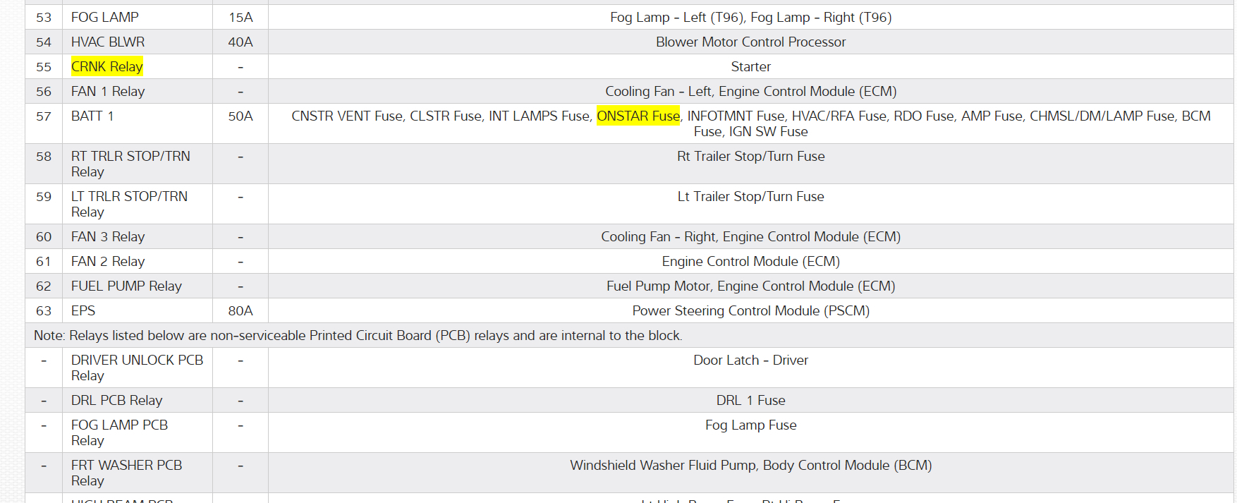

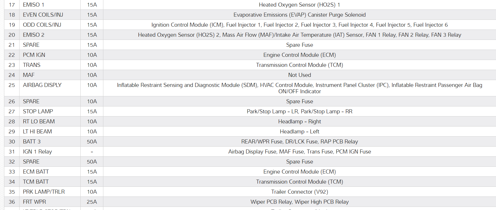

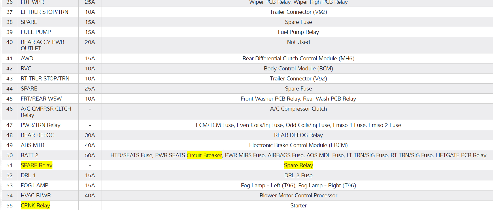

It sounds like both or one radiator cooling fan motor is not working. Here is a guide to help walk you though the steps to replace it.
https://www.2carpros.com/articles/replace-electric-fan-motor

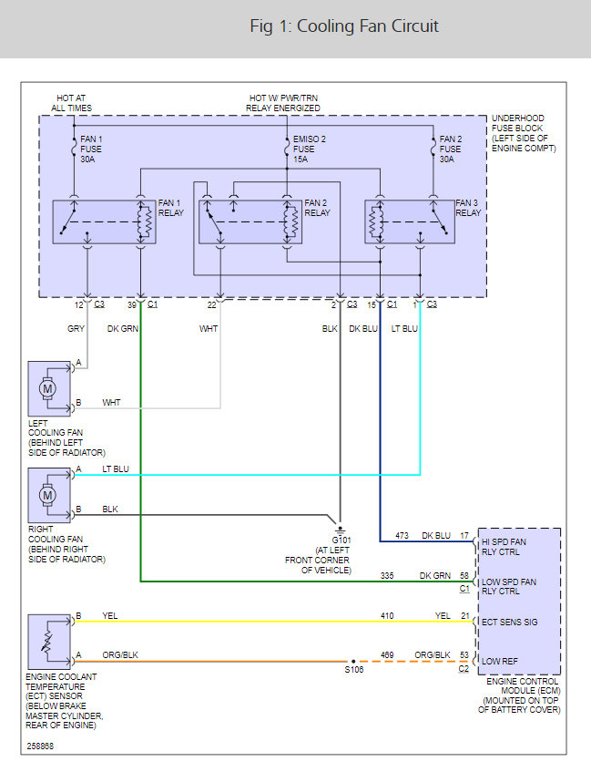

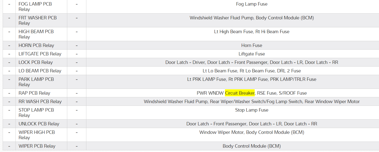

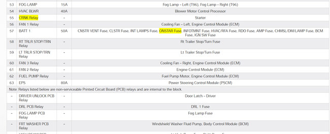

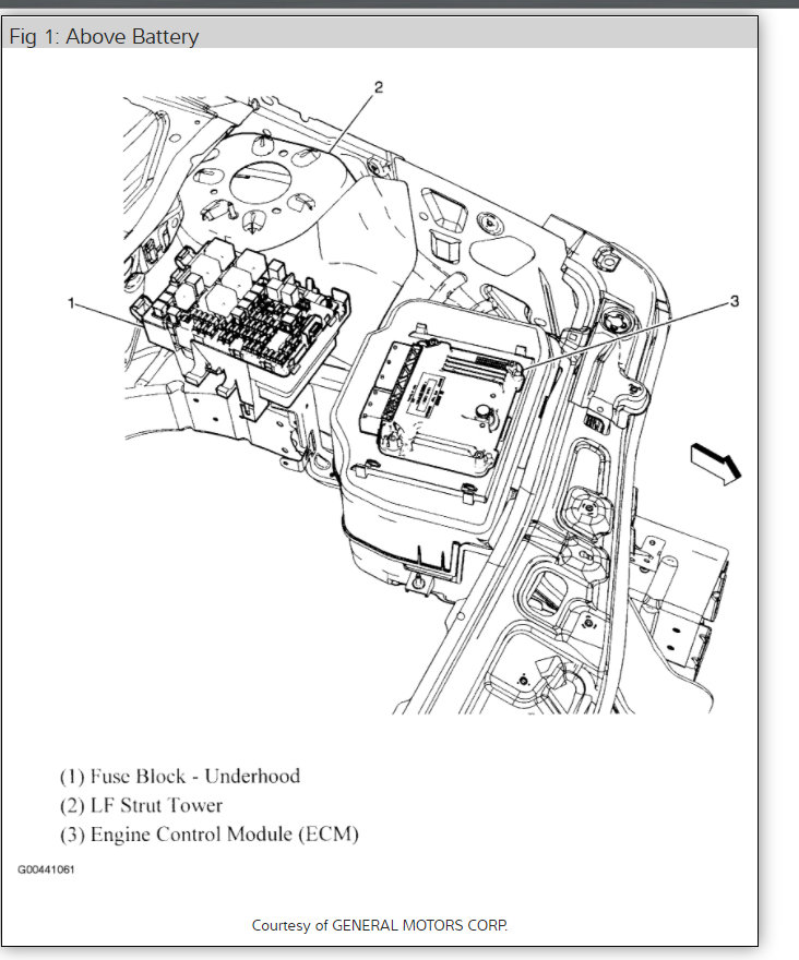

Start by checking the fuses and relays.
and
Here are the cooling fan wiring and fuse with replay locations
Cheers

Thank you so much I had one cooling fan burned out it didn't even turn. So I replaced both fan motors and the car works great again. I love this site I cant believe it is free.

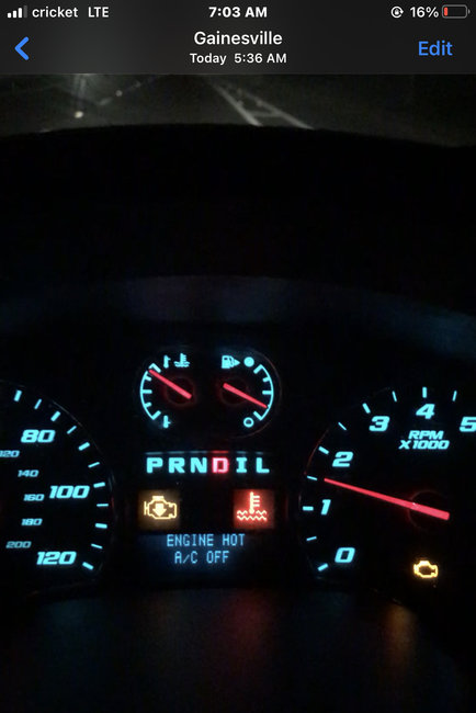

Hello, I’m having problems with my 2009 Chevrolet Equinox running hot. I had the radiator put on it still running hot. I had thermostat put on it still ran hot. I took it to Tires Plus they ran every test. they replaced the hose vacuumed air out of the thermostat they said and flushed it. a day later it ran hot again. needle all the way up. it said idle engine turn engine off now. they are saying they did every test it could be the thermostat again.
Feb 17, 2021 at 7:32 AM
CARADIODOC
  • 34,306 POSTS
When does this happen? If the temperature remains normal while you're on the highway, that is evidence the radiator fan isn't running. It is only needed at low speeds or when stopped in traffic, otherwise normal air flow is enough to cool the radiator.
