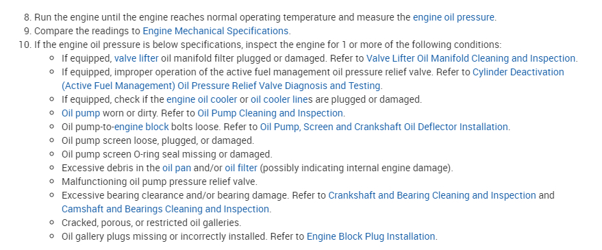

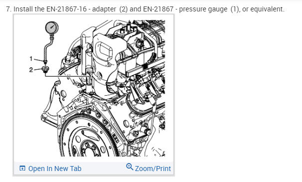

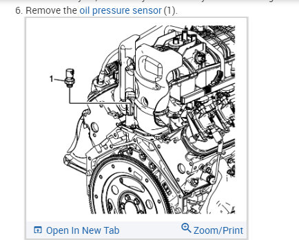

That may be the cause of the actuator not responding and setting the code. Is the oil pressure low enough that the light comes on?

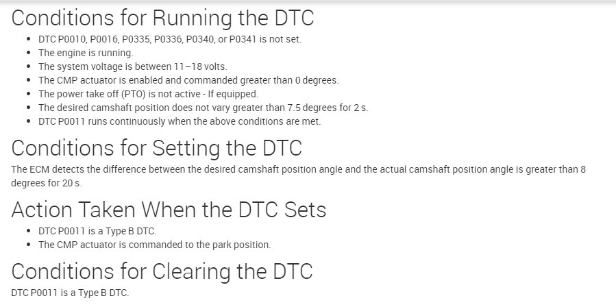

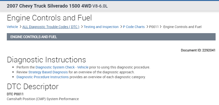

Also, with 200K on it, the timing chain may be stretched. The code indicates there is more than an 8-degree difference between the camshaft angle and what the PCM thinks it should be.

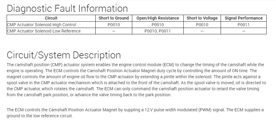

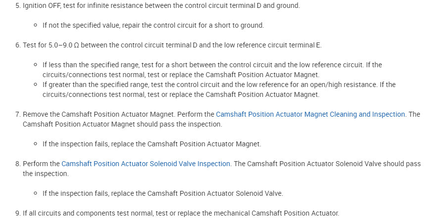

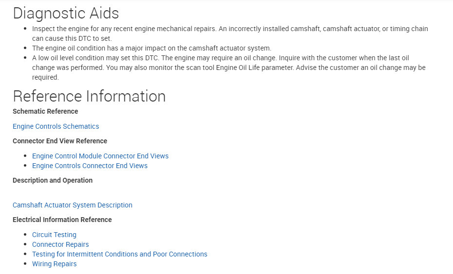

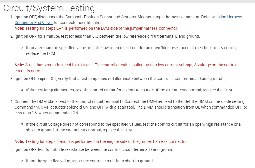

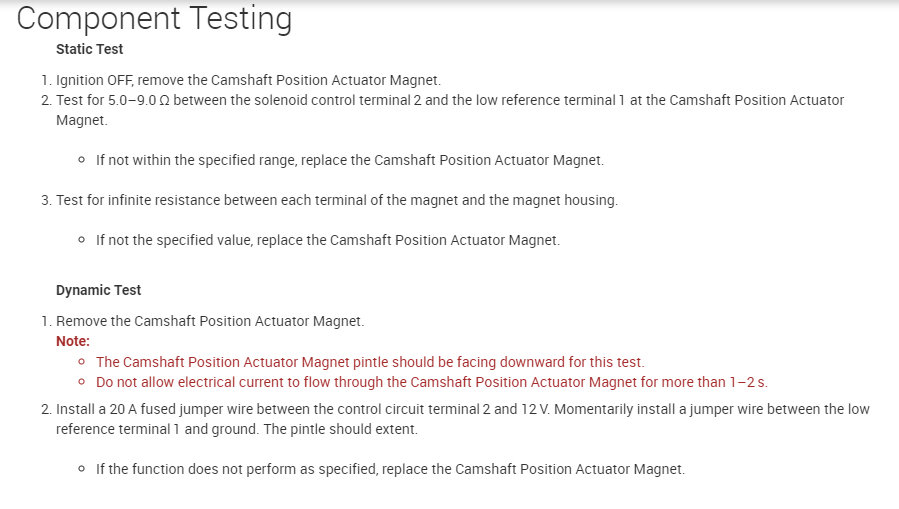

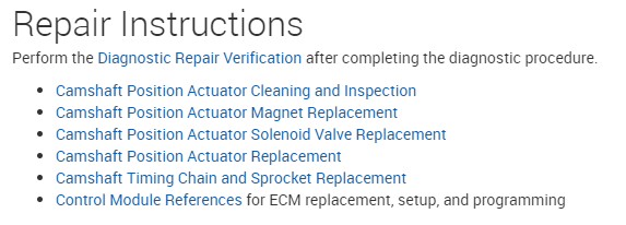

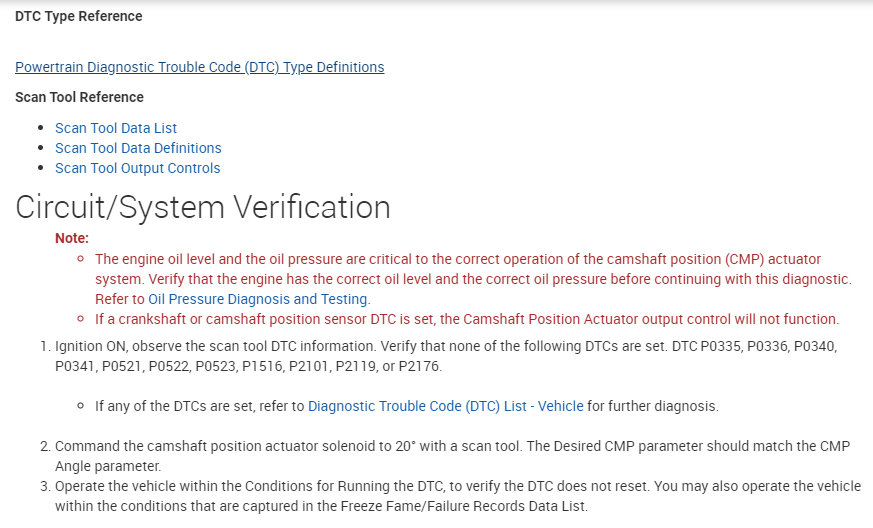

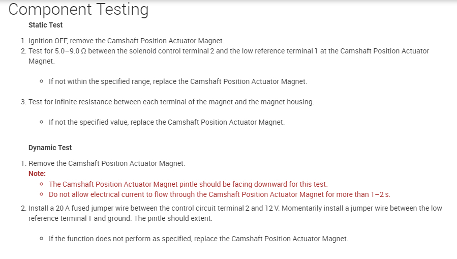

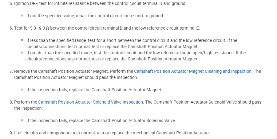

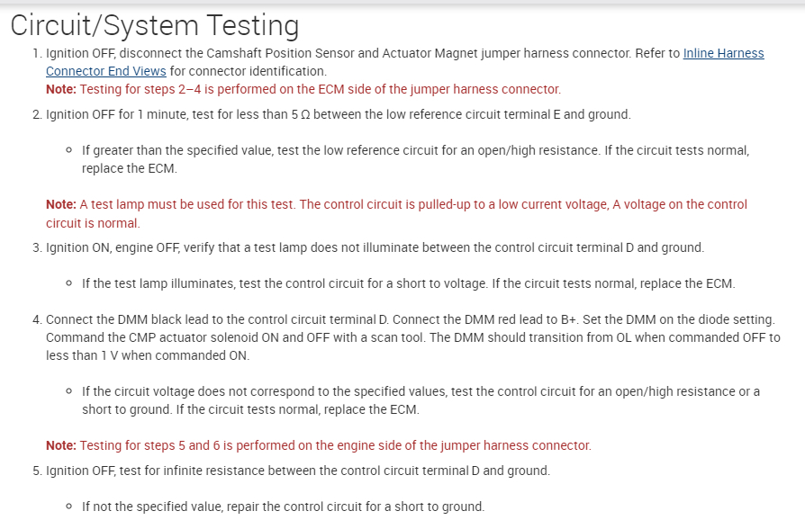

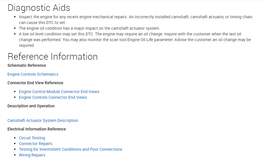

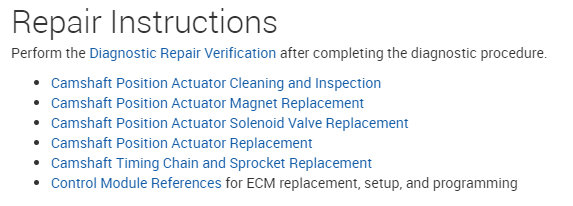

I'm going to attach the definition and diagnostics for the code. Testing needs to be done to determine if the cam actuator is responding. It could simply need to be cleaned, but even that isn't simple because to remove it requires the timing chain to be removed.

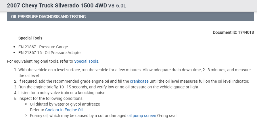

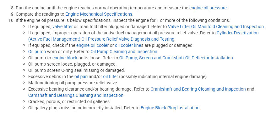

However, I feel somewhat confident it is the result of the oil pressure. For the system to work correctly, the pressure needs to be right. That leads me to a different question. Is there sludge in the oil pan that is restricting the oil pump or is it due to wear?

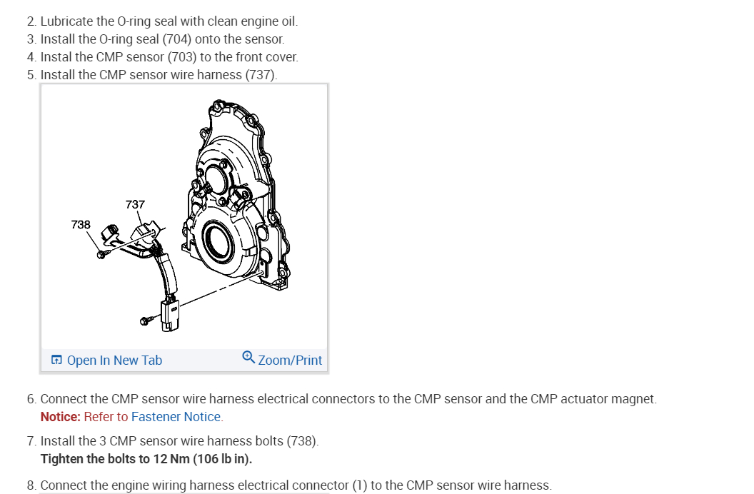

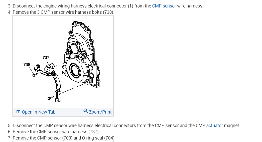

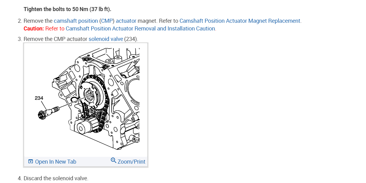

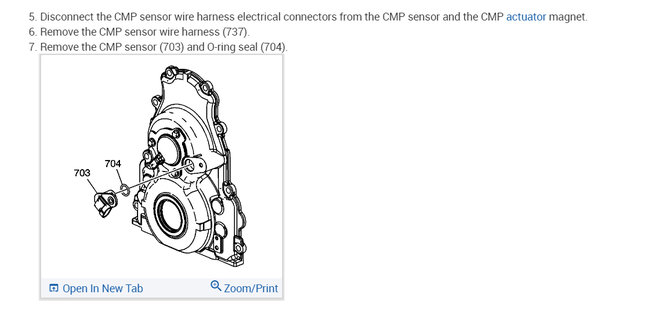

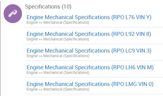

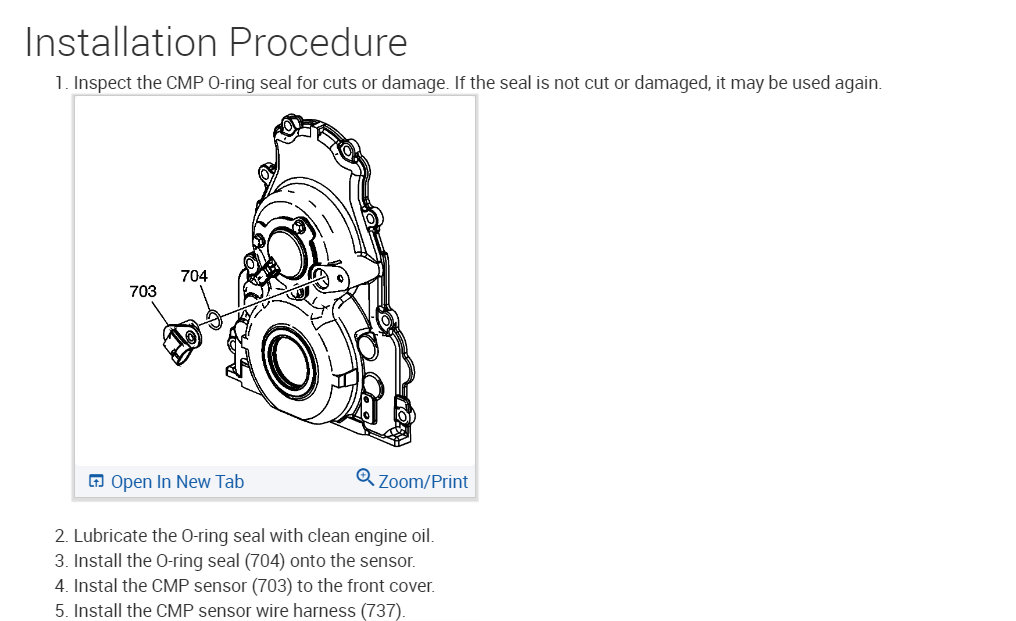

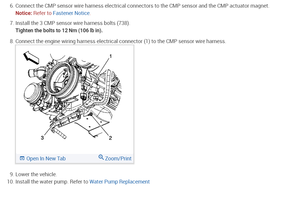

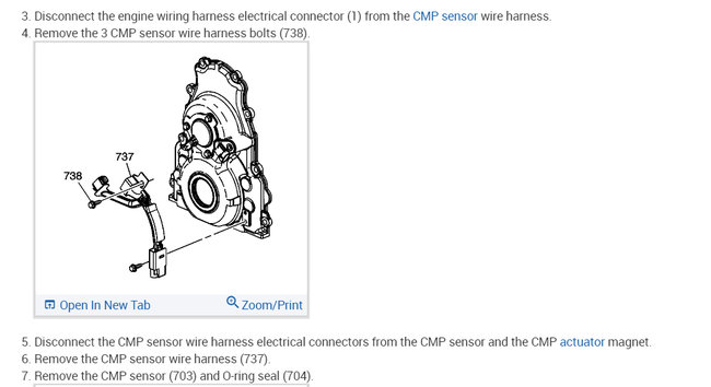

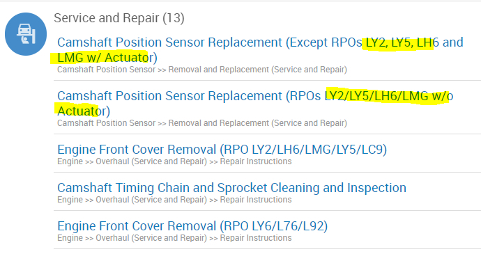

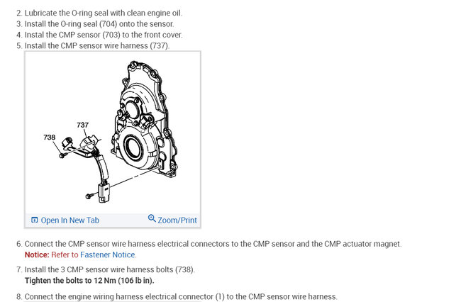

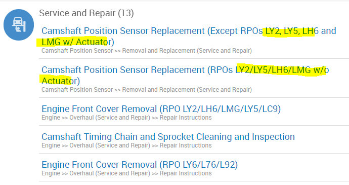

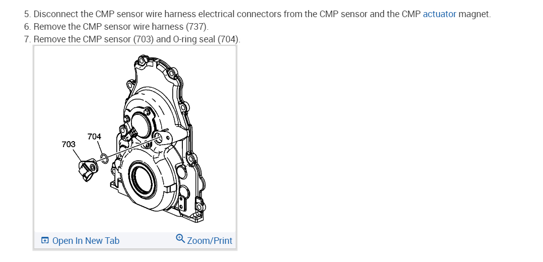

Your original question was where is the sensor. I need to know the engine RPO to determine that. RPO stands for regular production options. I can determine the engine RPO with the 8th digit of the VIN number, or you can locate it usually in the glove box there is a label with several numbers which lists all that the truck came with.
If you look at the last two pics, you'll see why I need it. There are variations in the engine. The last pic shows what the RPO is based on the 8th digit in the VIN.
Let me know your thoughts and which direction you would like to go.

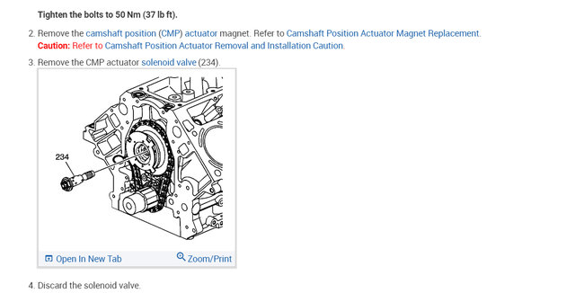

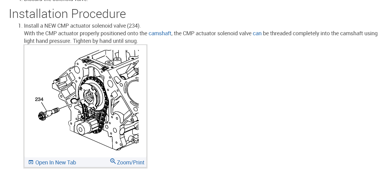

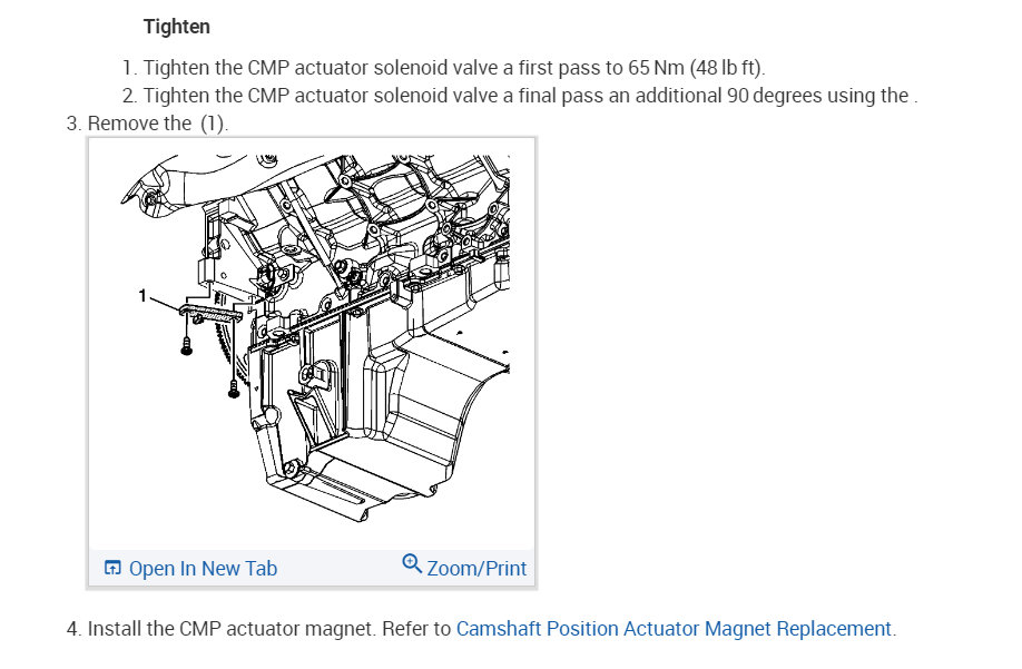

See pics below.
