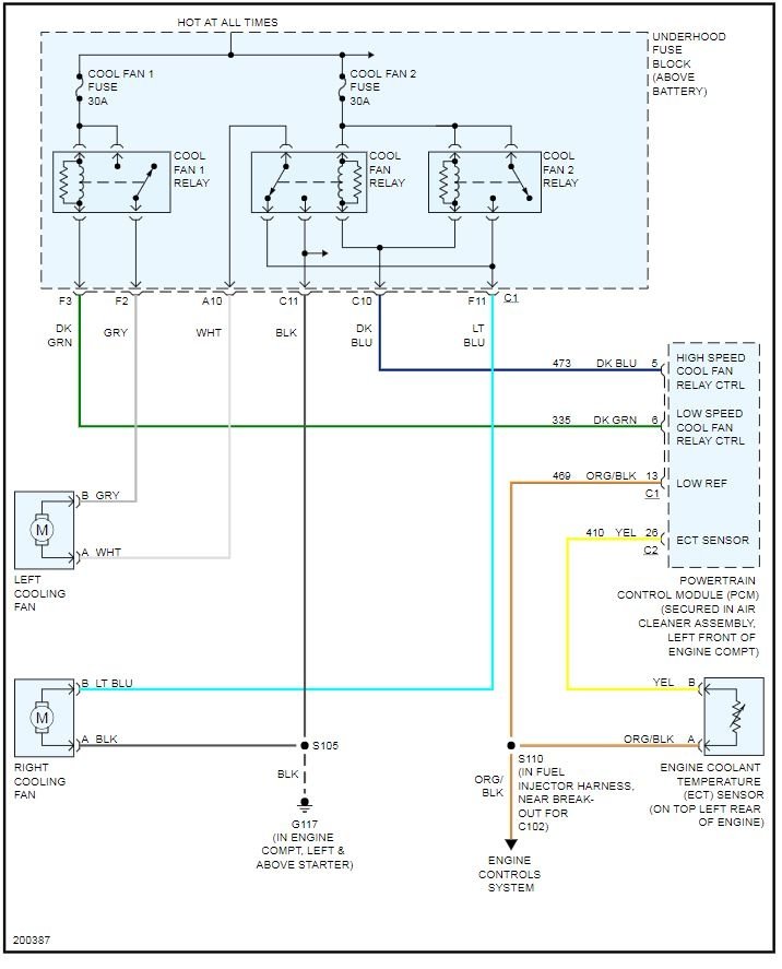

Read these guides, they will help you figure this out
The wiring diagram for your cooling fans is attached below
