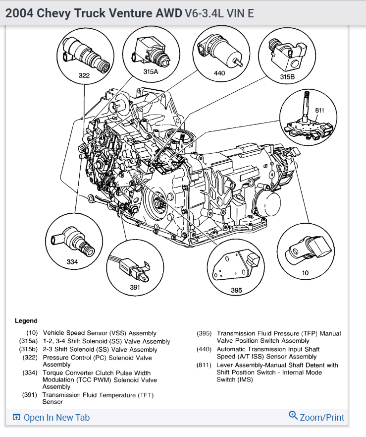

The transmission will not shift out of first gear It only stays in the gear that it is in when you put it in Drive and my speedometer is not working?
Dec 27, 2009 at 3:14 PM
It sounds like the VSS has gone bad here is a diagrams below to show you the location so you can change it out. Check out the diagrams (Below). Please let us know if you need anything else to get the problem fixed.
Jan 3, 2010 at 8:46 PM
REDDOGZ06
Thanks for this post I had this problem and the VSS fixed it. I love this site.
