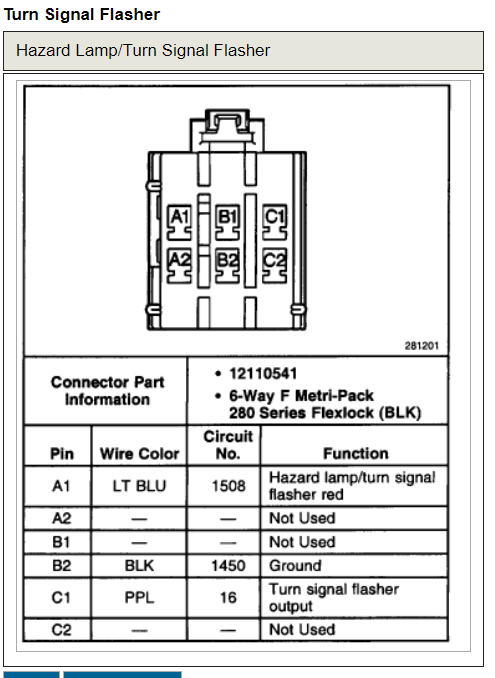

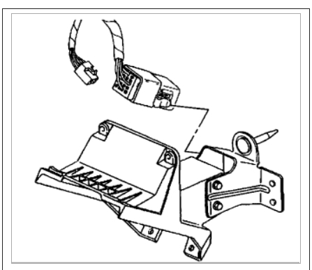

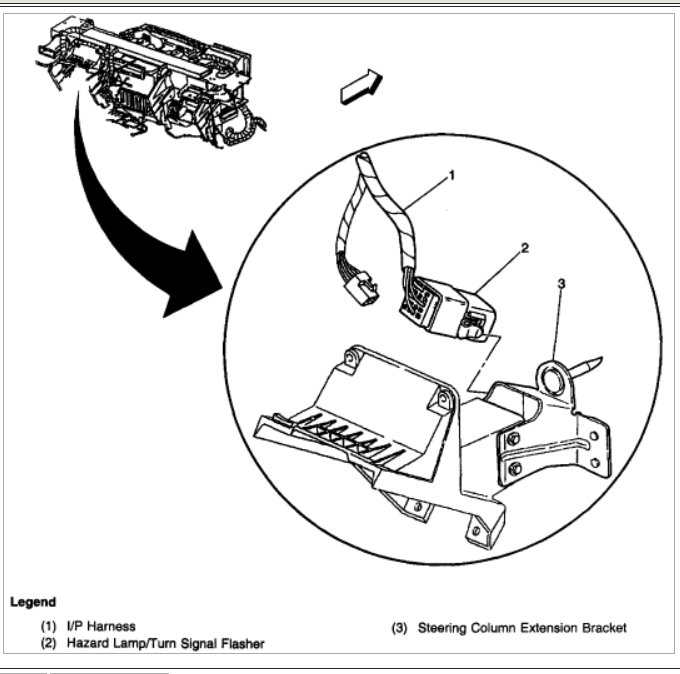

Electrical problem 6 cyl Front Wheel Drive Automatic 357000 miles
My directionals, flashers only work intermittently, where is the flasher located to enable replacement?
