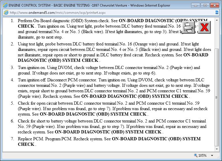

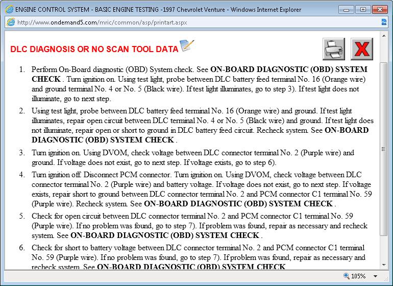

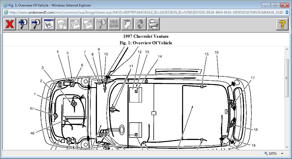

I failed an inspection recently when their machine wouldn't talk to my OBD system. No test results were reported, the printout simply said "Abort" next to most every test field.
I took it up the street to another shop, just to make sure it wasn't just their machine messing up. No dice, and they even charged me $10 just for trying. :-( All the fuses looked good, but none were labeled "computer" or "OBD".
What should I check?
