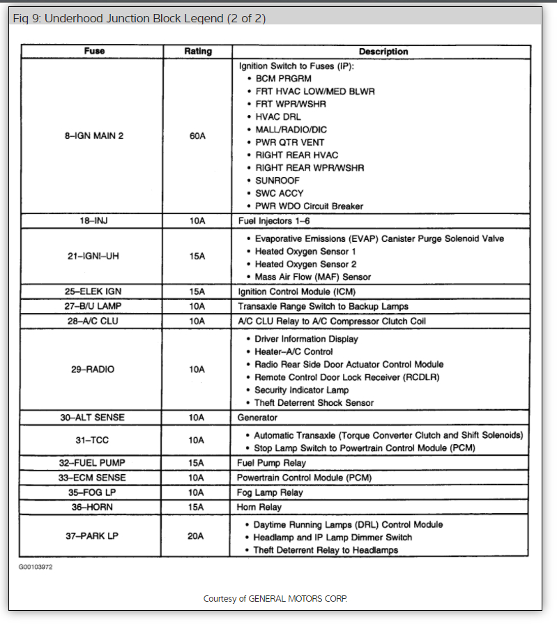

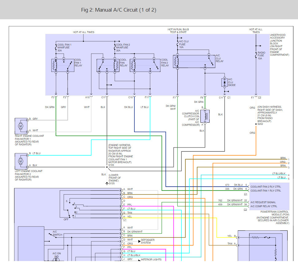

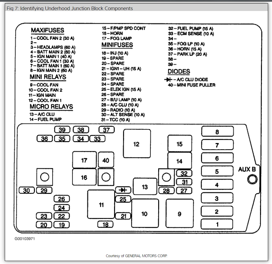

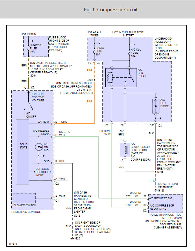

Is the compressor clutch turning when you turn the system on? It sounds like you have a relay that is out not activating the clutch on the compressor which will make the ac not work.
Here is a guide to get us started finding out what is wrong.
https://www.2carpros.com/articles/car-air-conditioner-not-working-or-is-weak

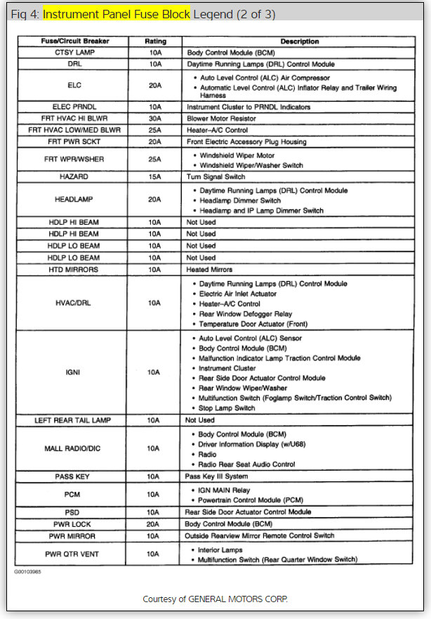

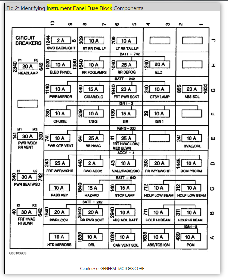

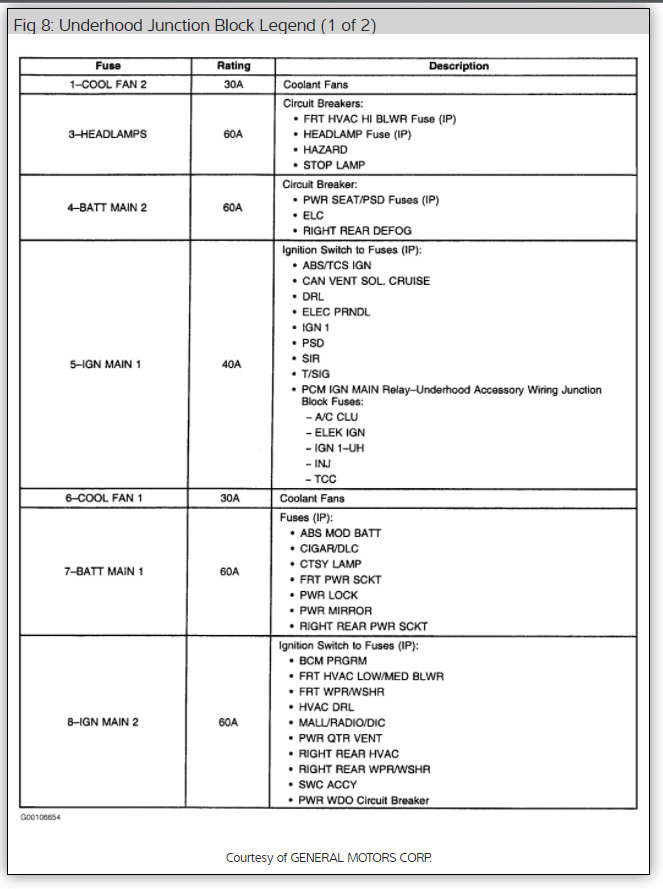

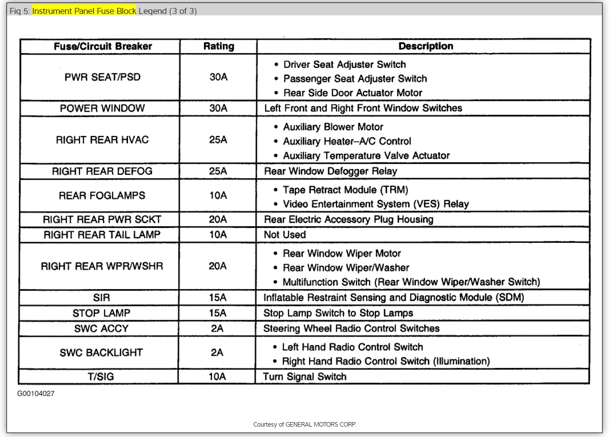

I would start by checking the fuses and relays, here are some guides to help with that.
and
Please let us know what happens so it will help others.

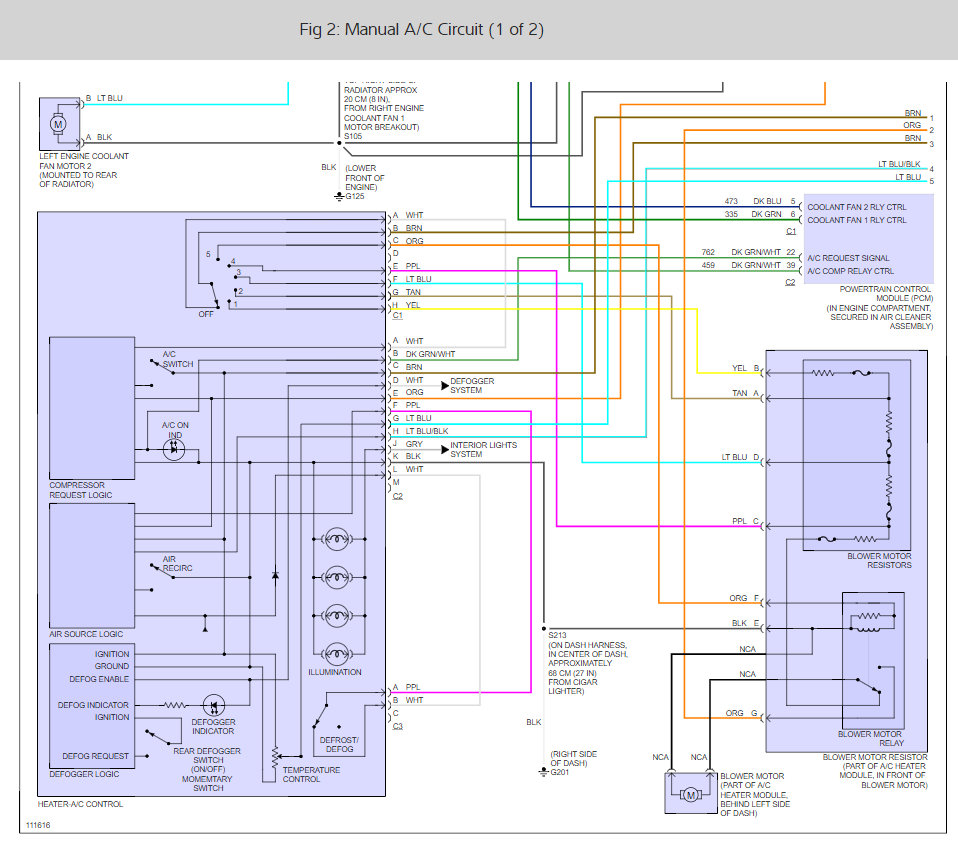

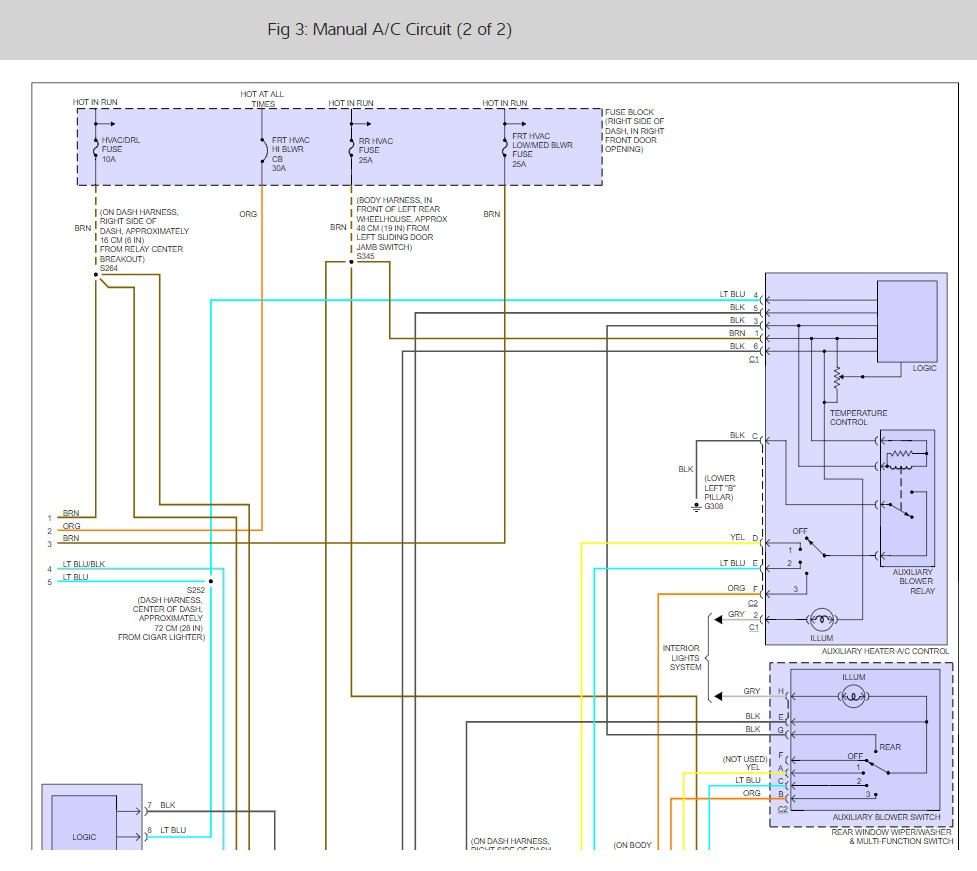

First check all fuses, underhood and in the pass compartment.Need to test the blower motor for power and ground.It is behind the right side of the dash. If no power, follow wires to fan speed resistor and test for power there, if it has it then the fan speed resistor is bad.
Sep 29, 2017 at 4:52 PM (Merged)
RANCHHOUSE
  • 11 POSTS
ty for your time....i checked power at fan motor and it has power so does that mean its my motor or resistor?
2CARPRO JACK
  • 11,533 POSTS
Check the ground too, if it has both and doesnt work it is the motor
