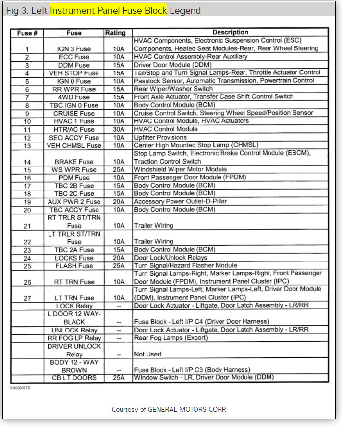

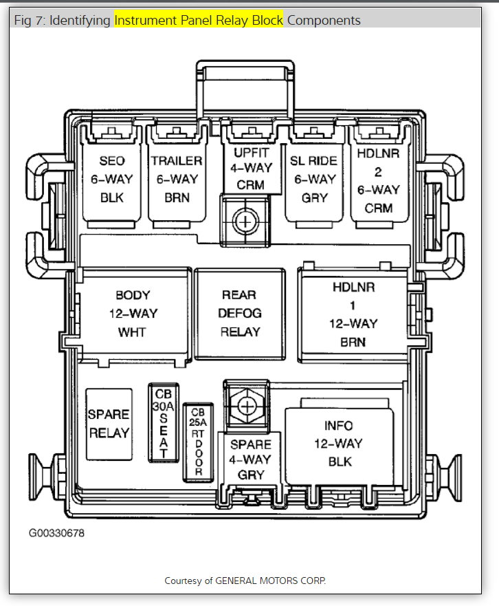

There is a door lock relay for the rear doors only that could be out but to be sure lets run this guide

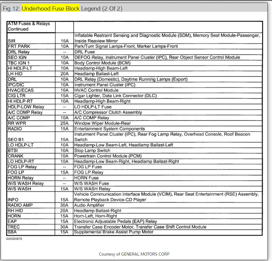

I would check the fuses as well

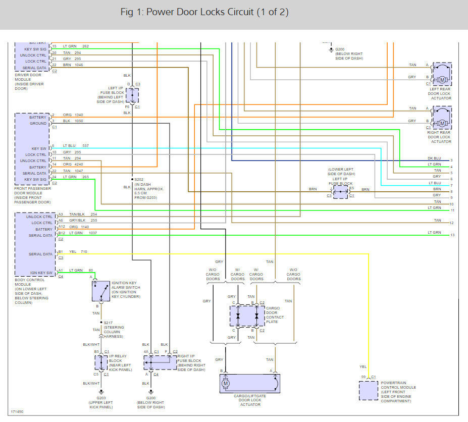

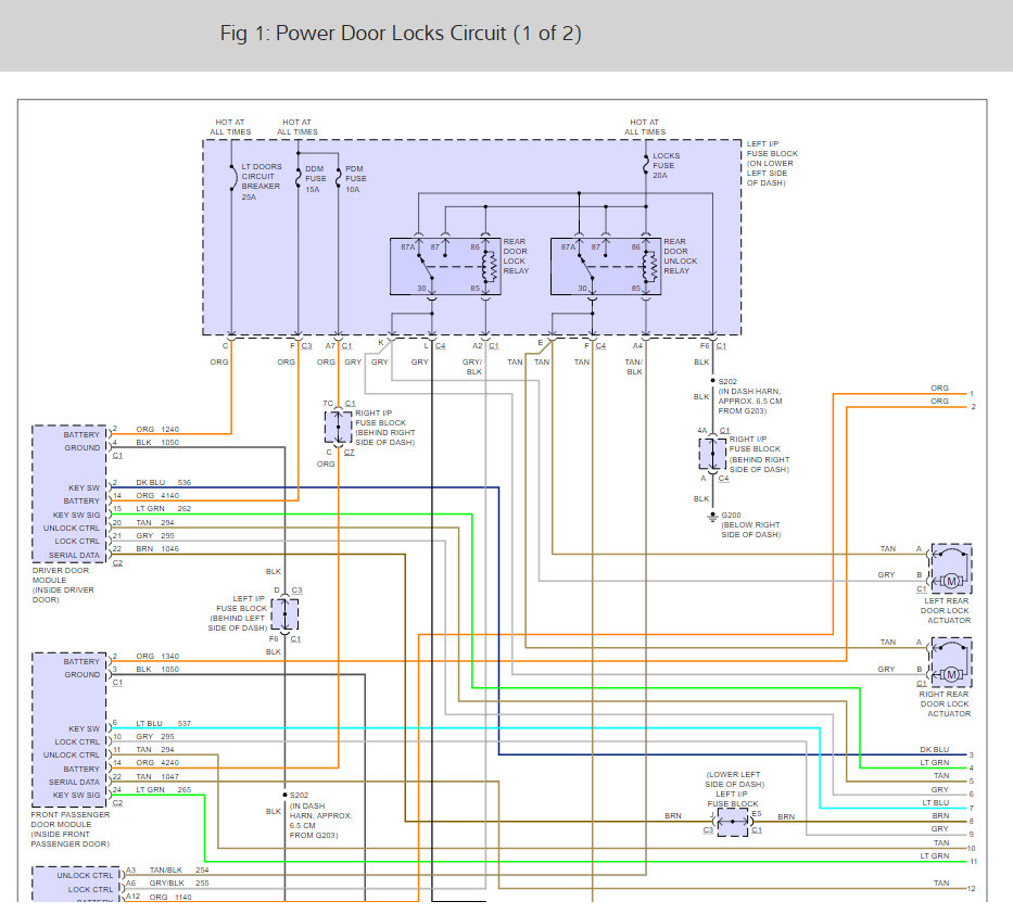

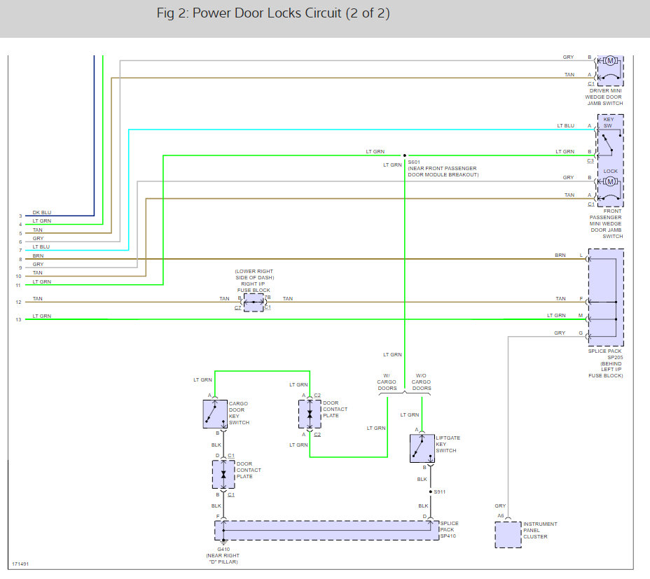

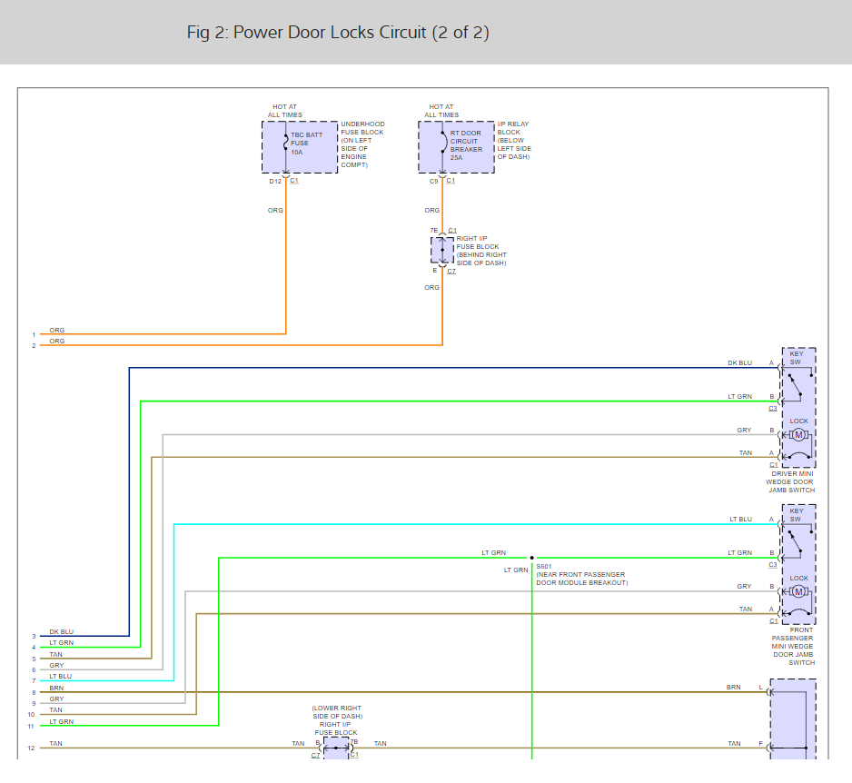

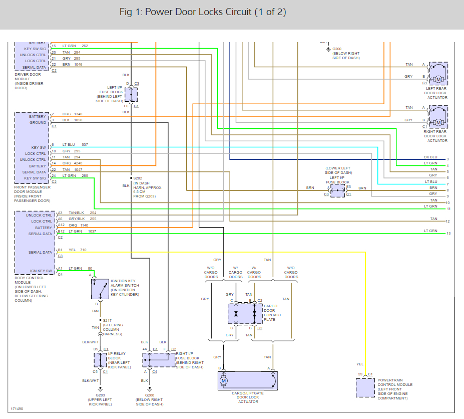

Here are the door lock wiring diagrams too so you can see how the system works.

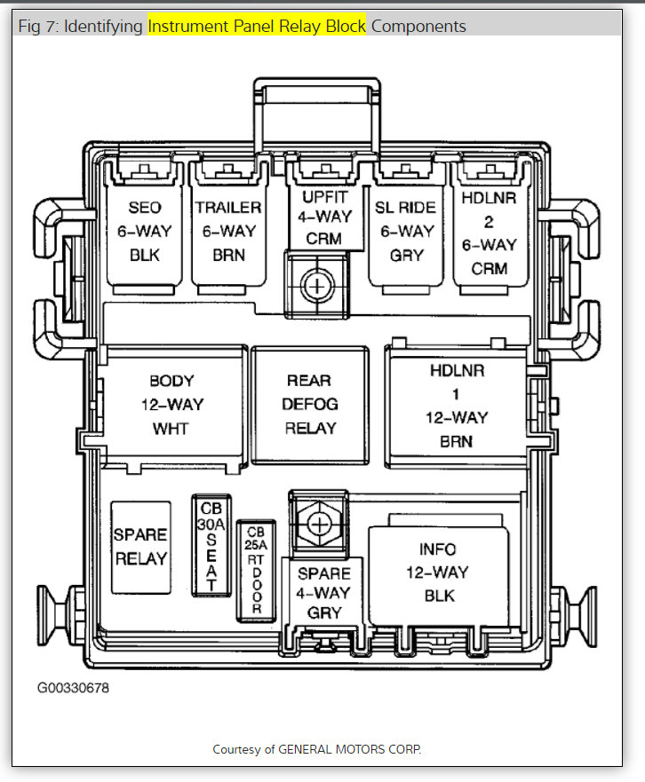

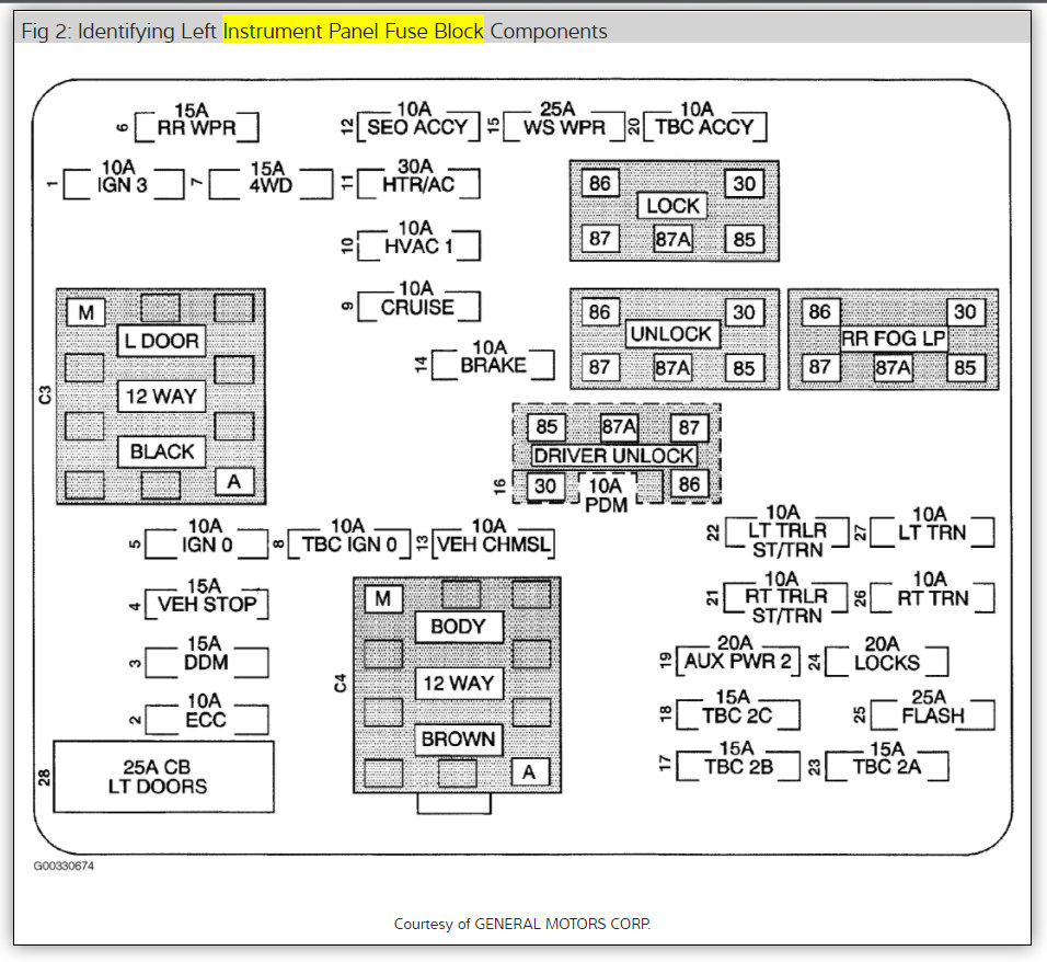

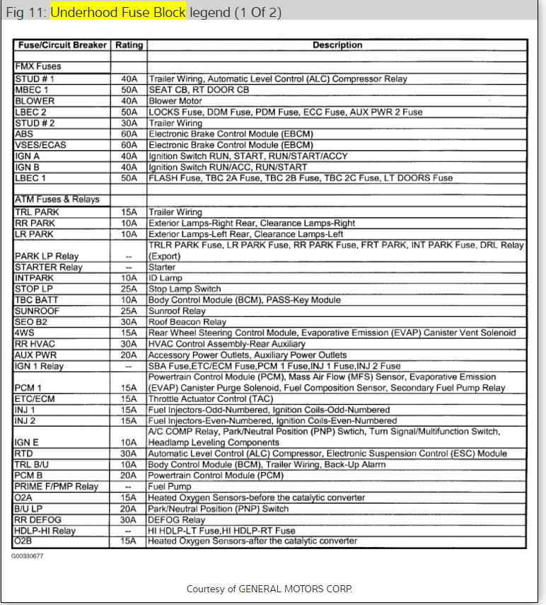

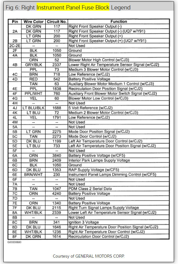

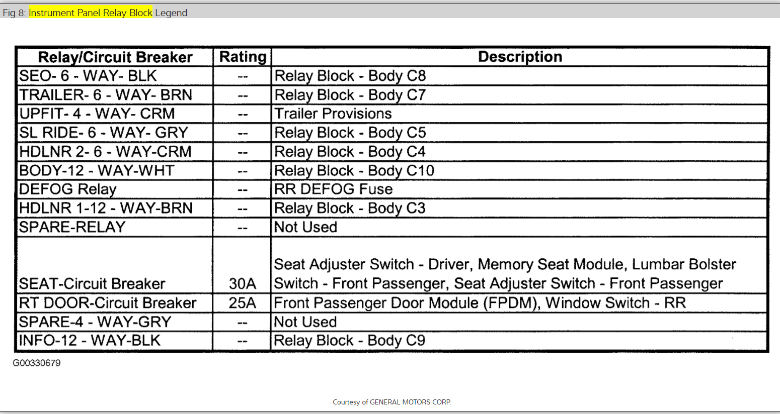

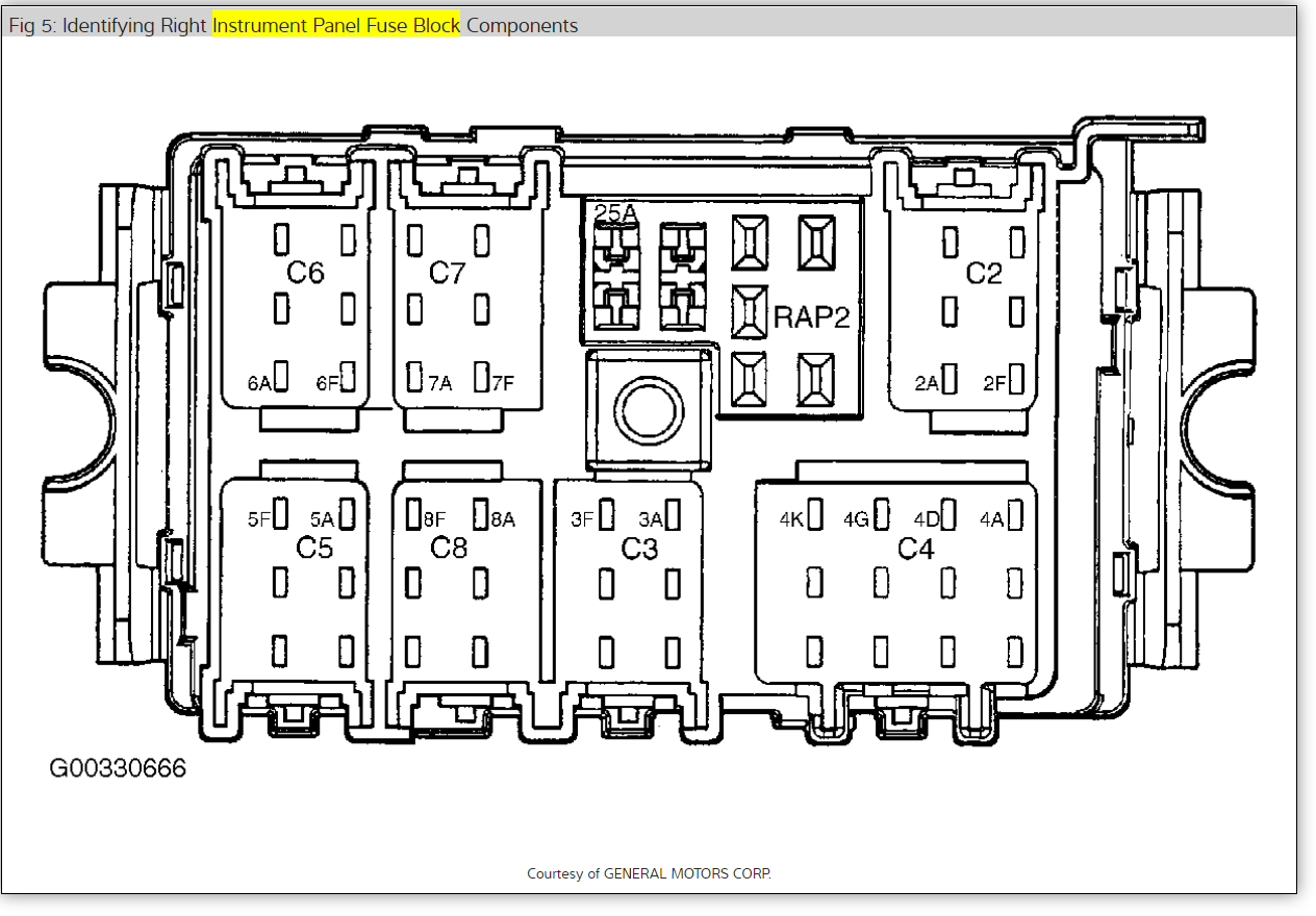

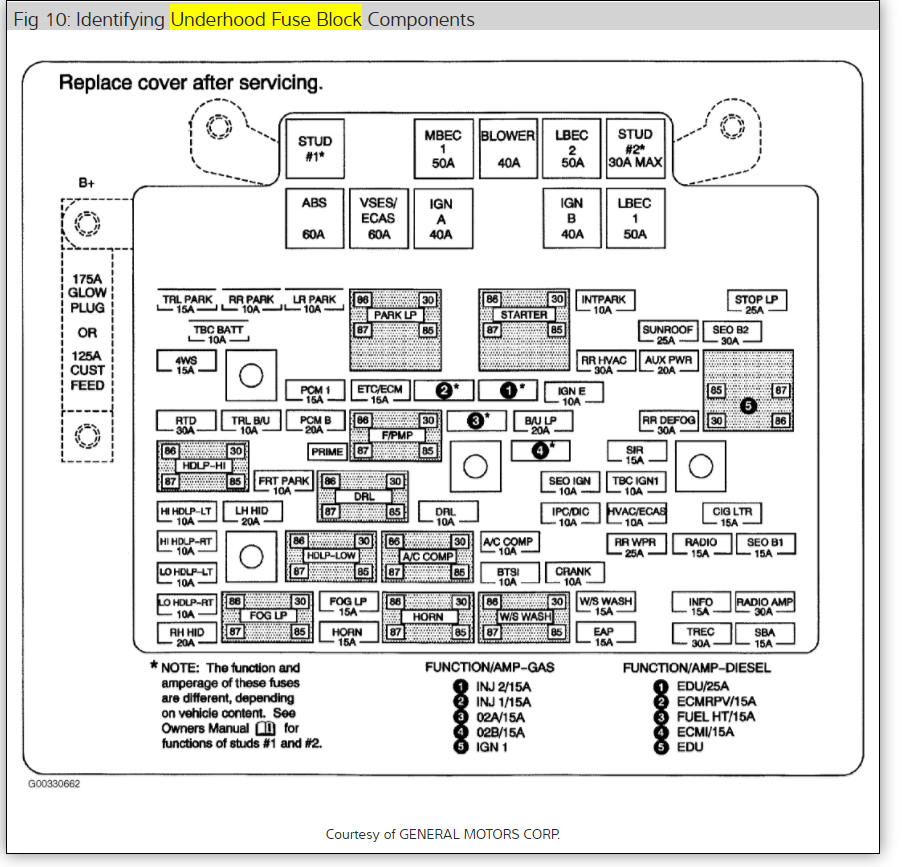

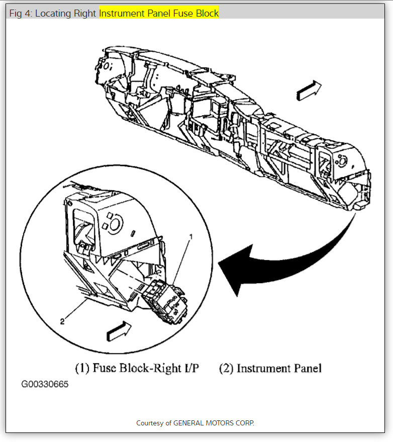

Here is the location of the relays and fuses for your car (below)
