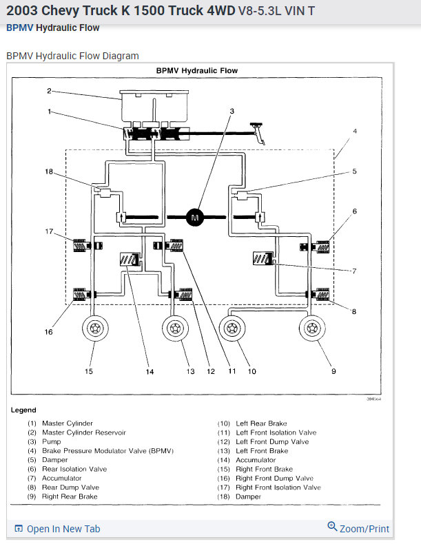

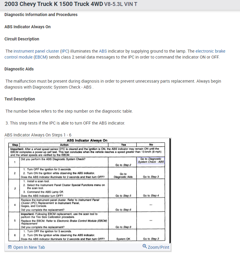

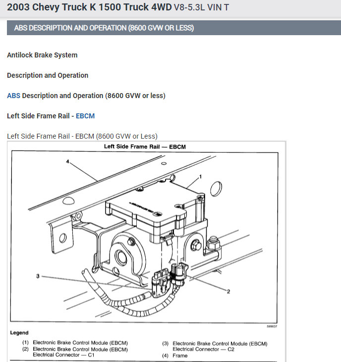

I have attached the ABS module diagram as well as diagnostics for the ABS light below.
