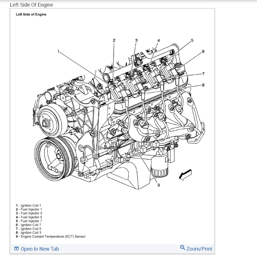

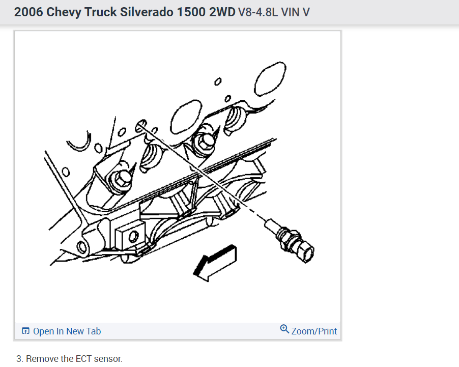

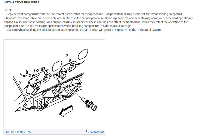

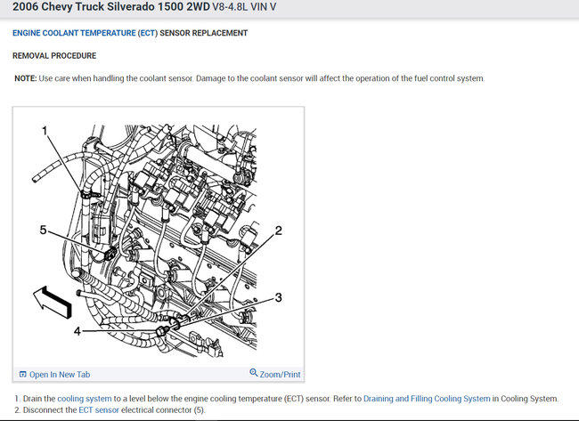

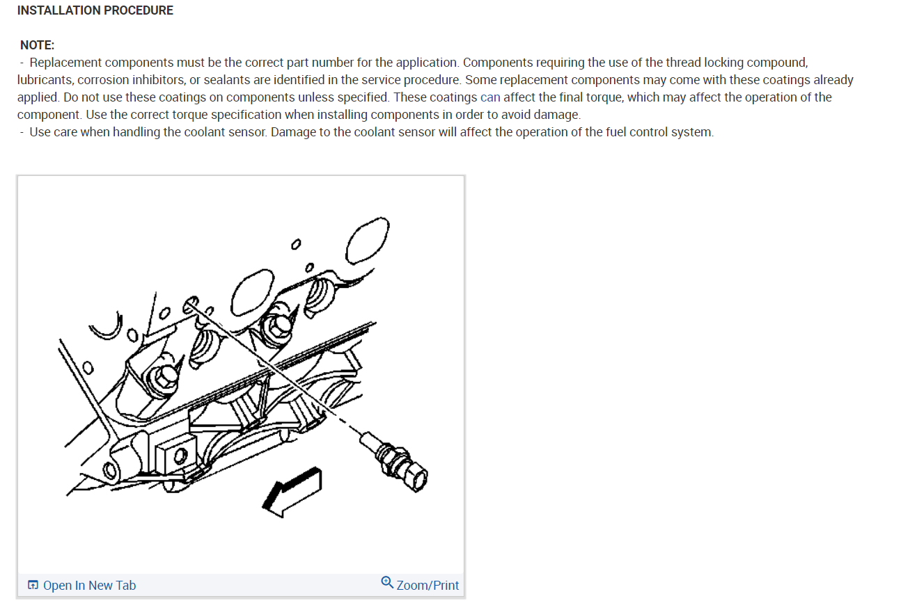

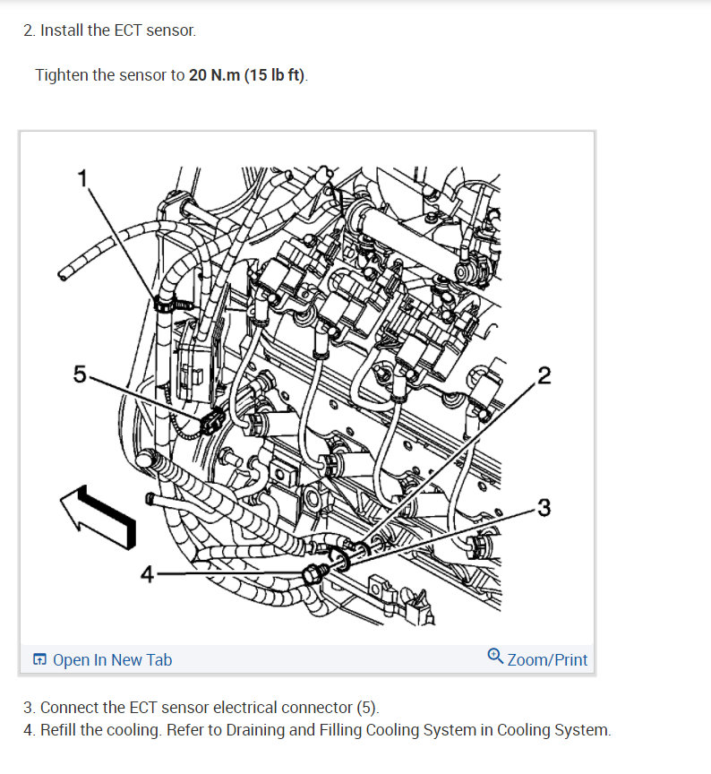

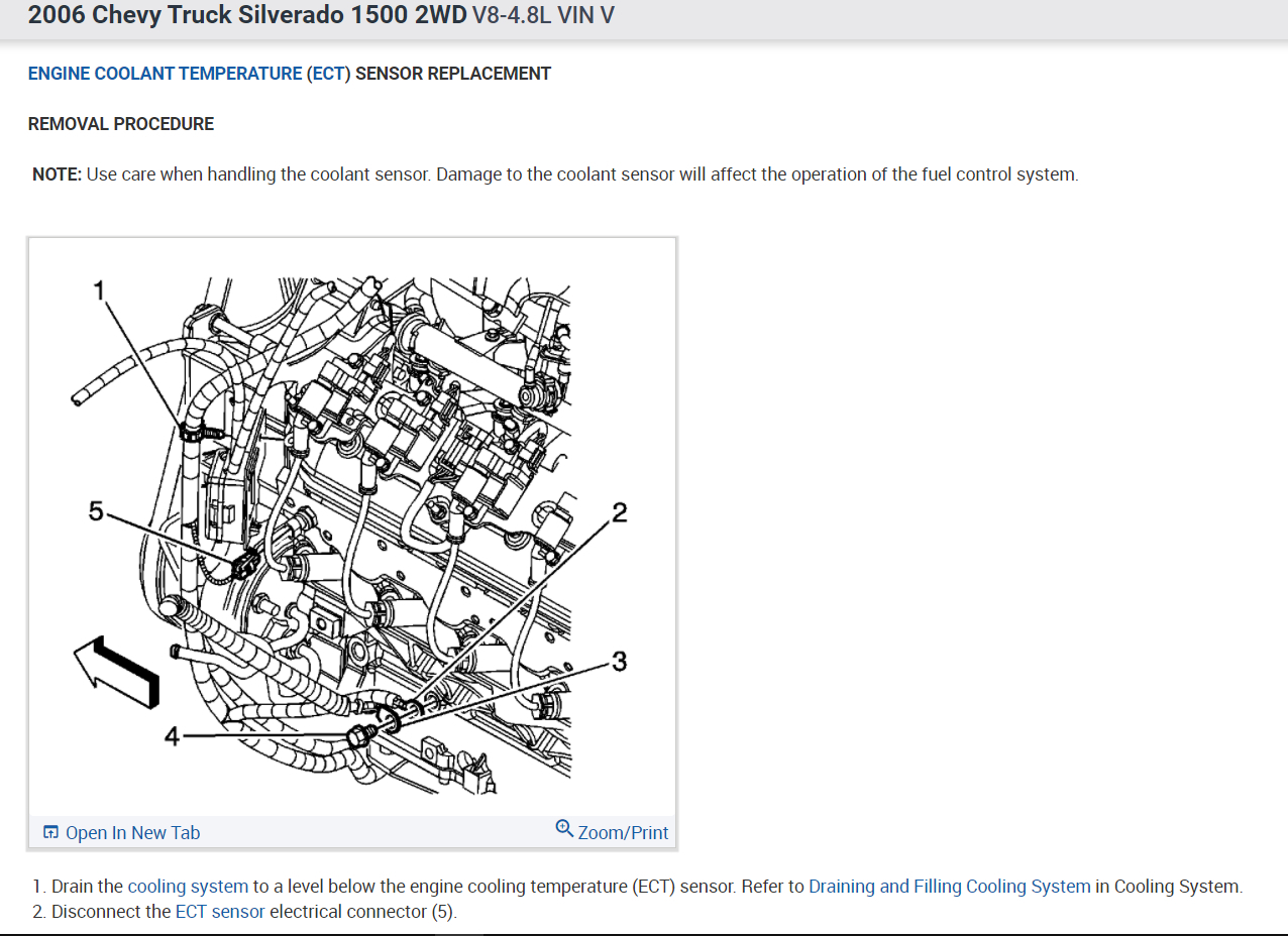

9 times out of 10 it will be the coolant temperature sensor or cluster here is a video that shows how to fix it.
https://youtu.be/_HEC44xENxw
Check out the diagrams (Below). Let us know what happens and please upload pictures or videos of the problem.
Jan 30, 2007 at 4:33 AM
