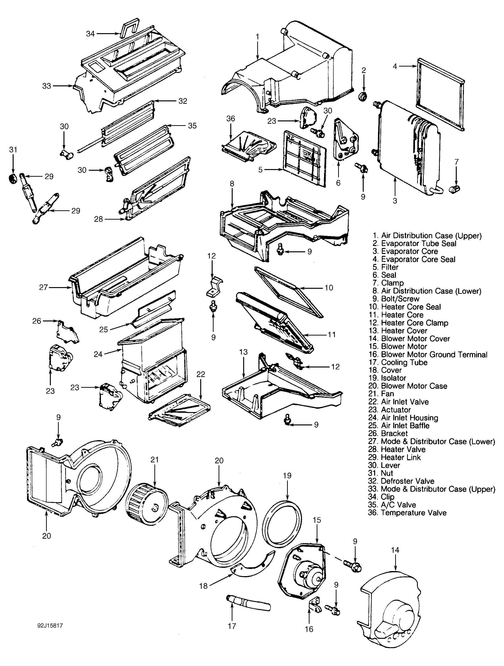

I have no heat both lines going to heater core are hot and the blend door actuator is off and its always on hot
Jan 13, 2021 at 10:43 AM (Merged)
CJ MEDEVAC
  • 11,004 POSTS
i looked at your question. i found this diagram in "prodemand" i researched a chevy pickup k1500 automatic with a manual hvac- if this is wrong, let me know, i look for another diagram. i noticed there are other doors and valves in the diagram, i don't know how they are actuated. This guide can help as well
https://www.2carpros.com/articles/car-heater-not-working
Check out the diagrams (Below). Let us know what happens and please upload pictures or videos of the problem.
