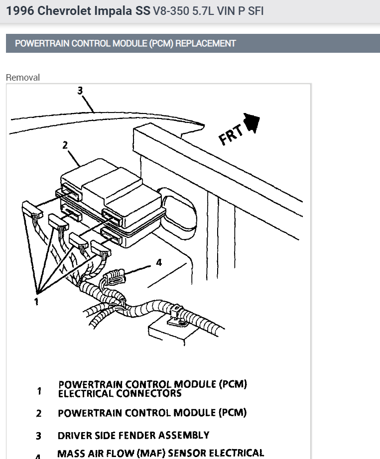

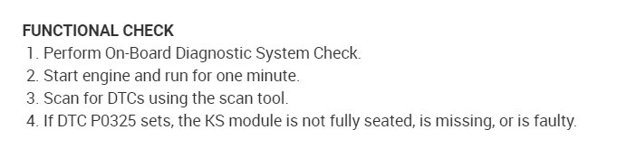

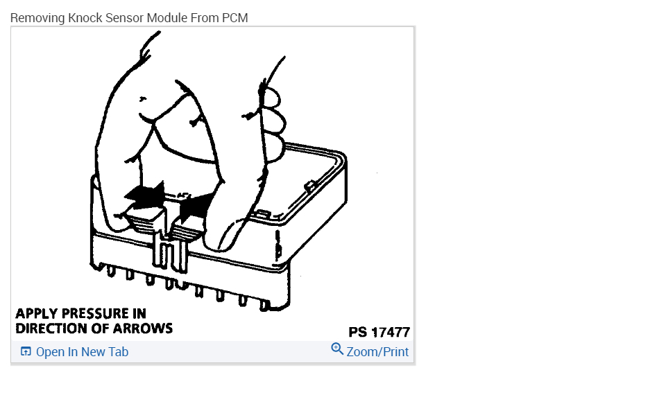

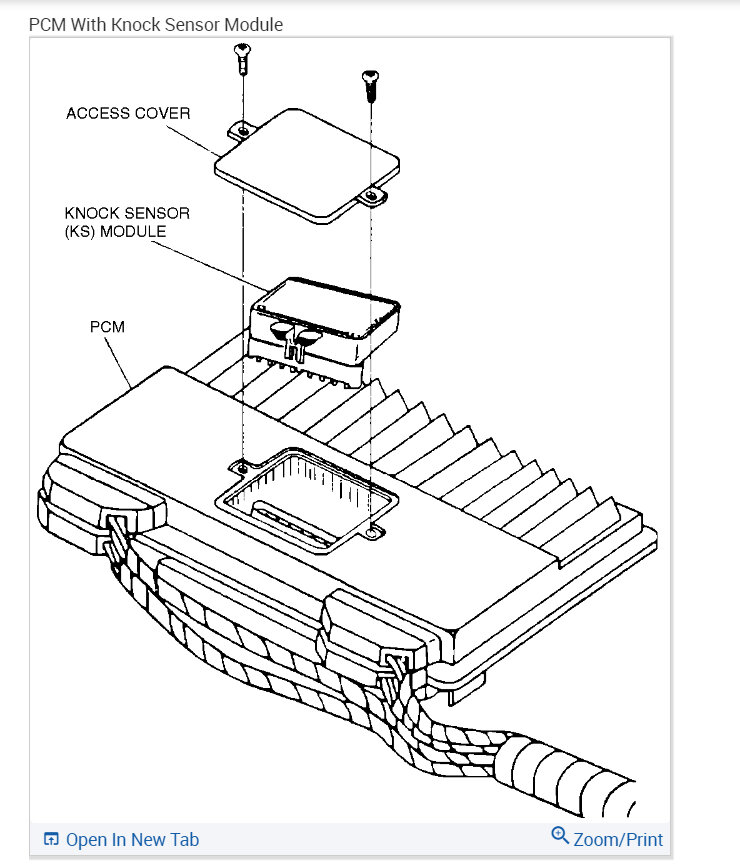

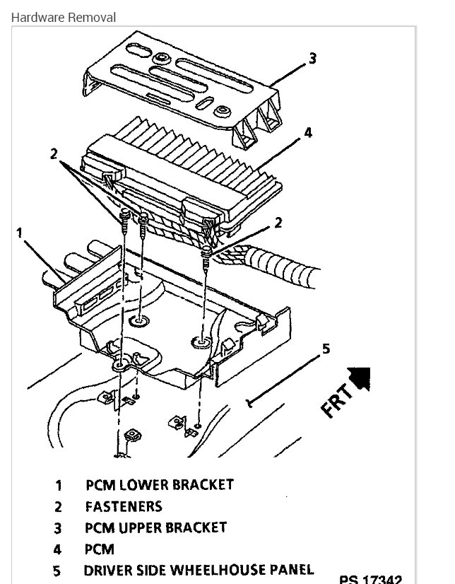

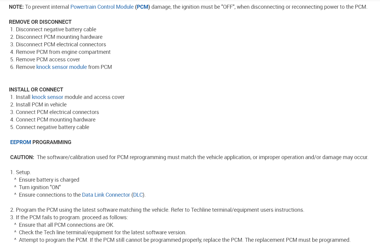

this is common when the PCM goes bad you need a rebuilt unit. Here is how the job is done in the diagrams below. Check out the images (Below). Please let us know if you need anything else to get the problem fixed.
