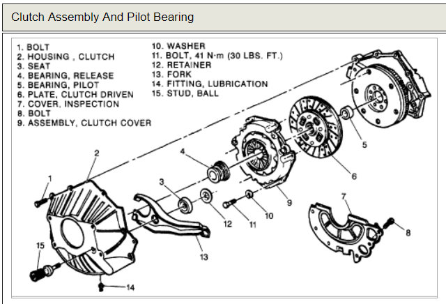

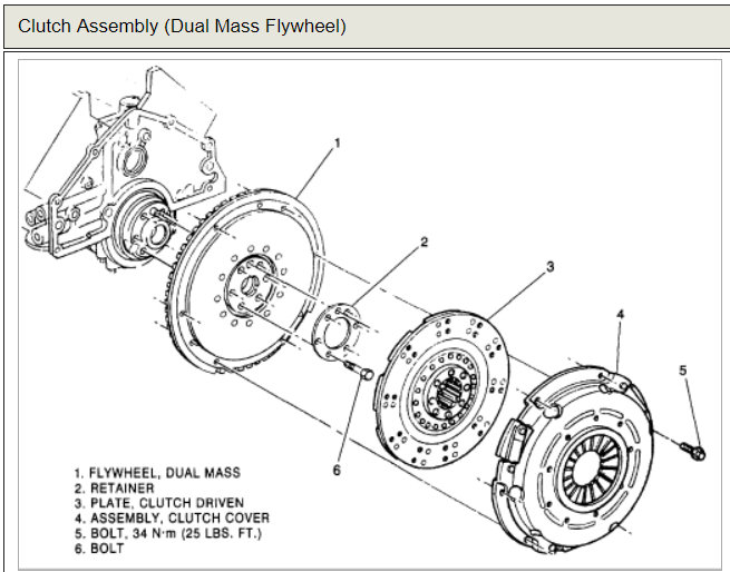

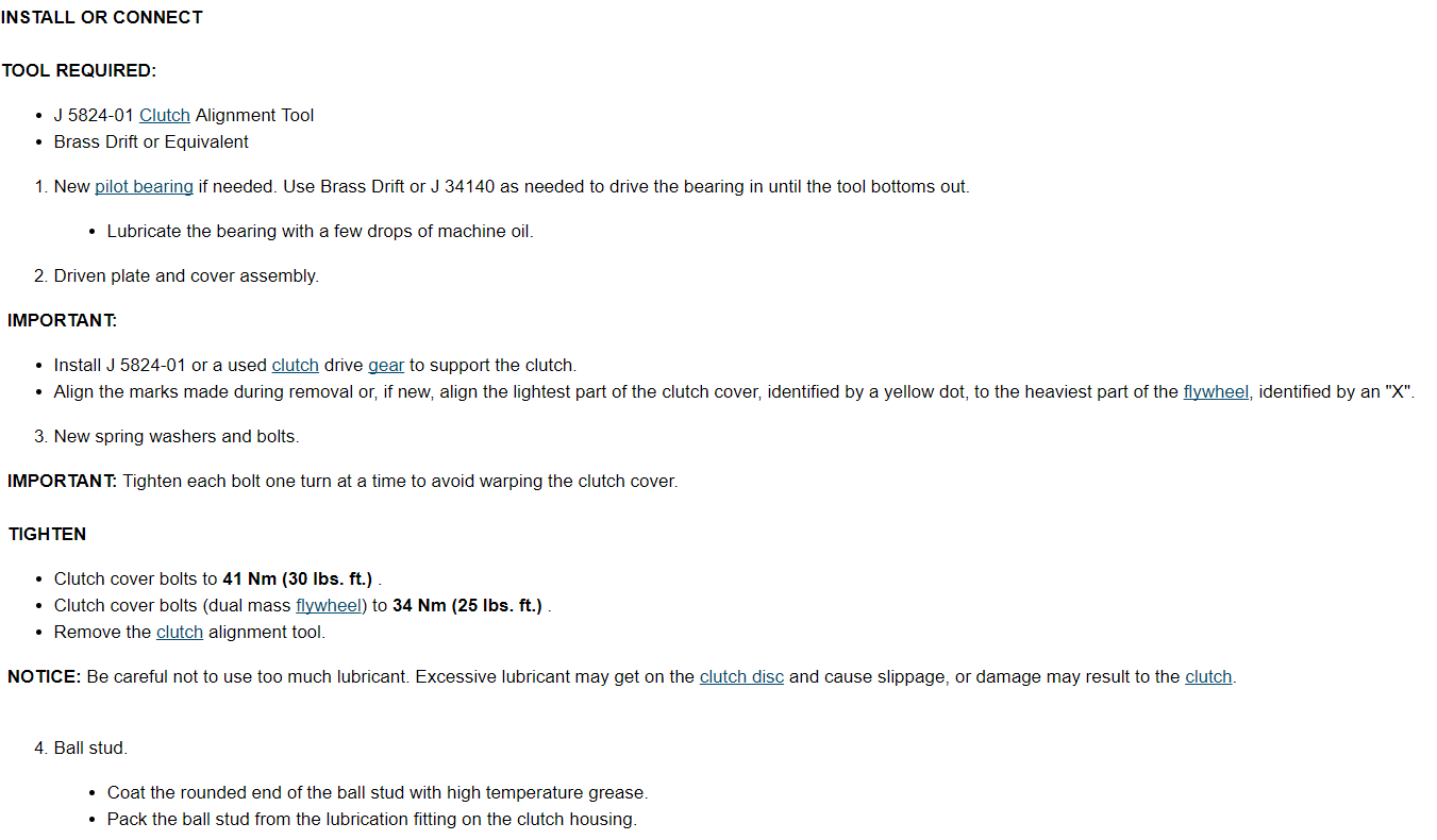

The hydraulic clutch is not adjustable the mechanical clutch adjusters is on the slave cylinder but is sounds like the disc may have fallen apart causing the problem you are describing.
This may help
https://www.2carpros.com/articles/clutch-doesnt-work-sometimes-or-not-at-all
Here are guides that shows you what you are in for when doing the job.
https://www.2carpros.com/articles/transmission-replacement-removal-manual
and
https://www.2carpros.com/articles/how-to-replace-a-clutch
Check out the diagrams below. Let us know what happens and please upload pictures or videos of the problem.
