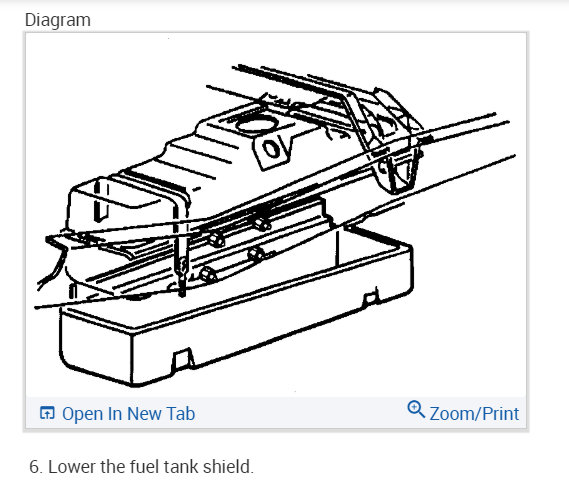

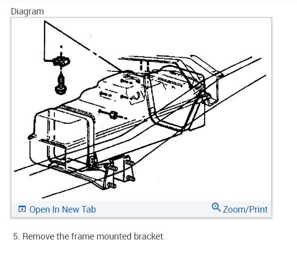

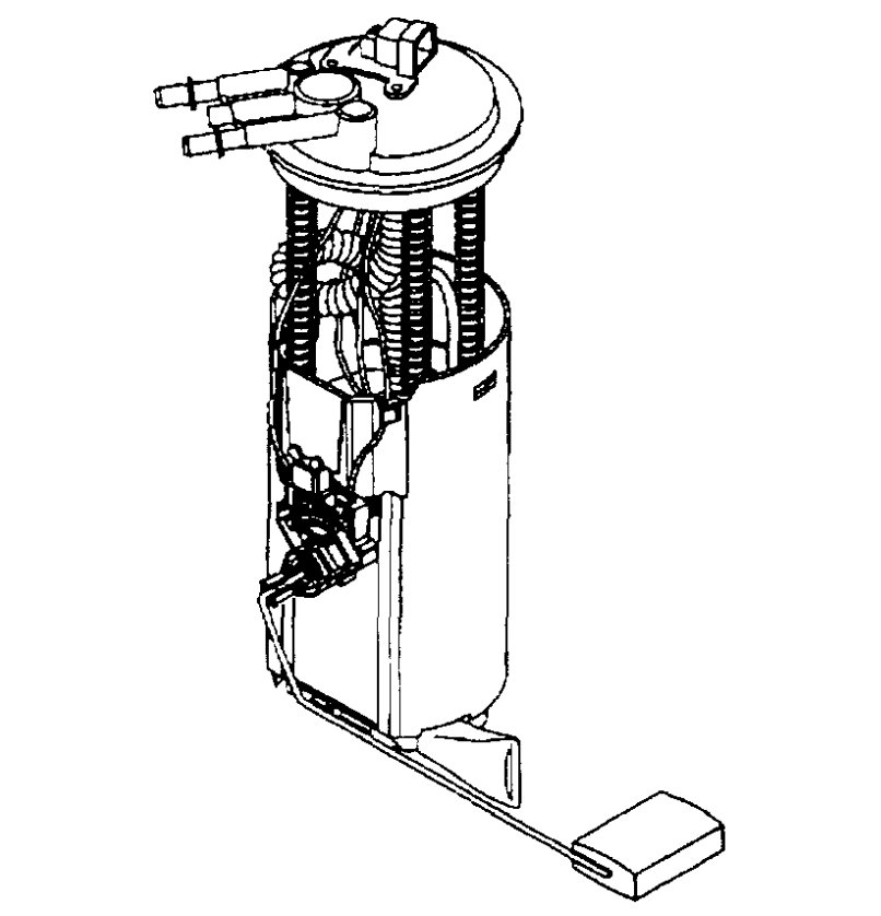

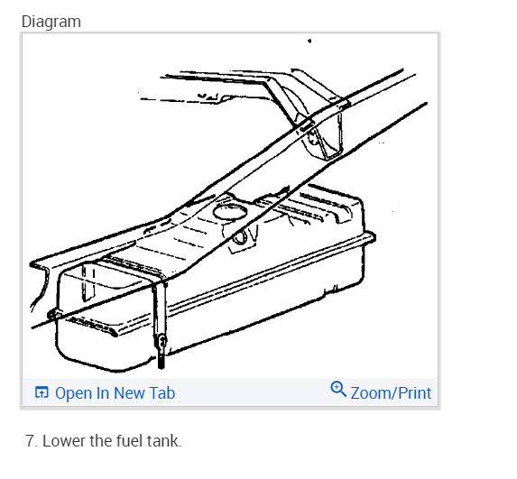

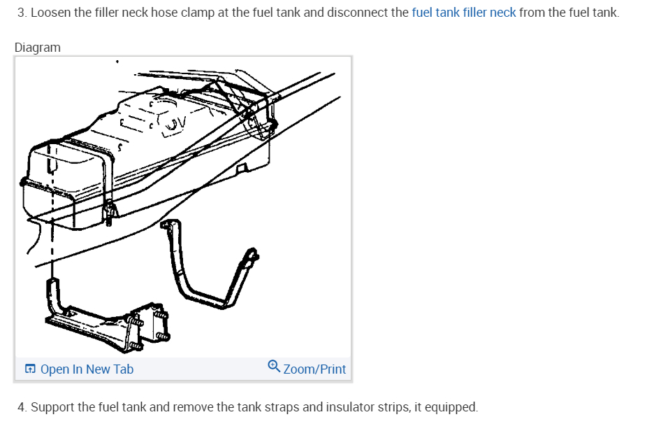

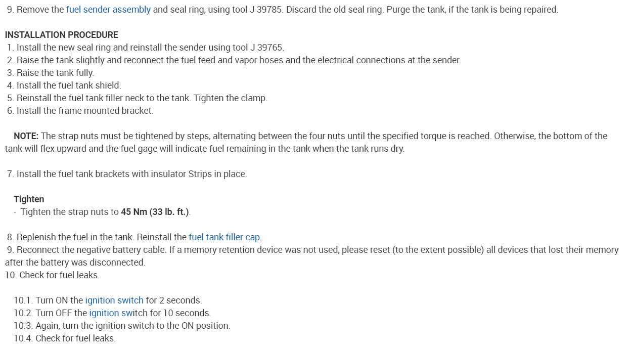

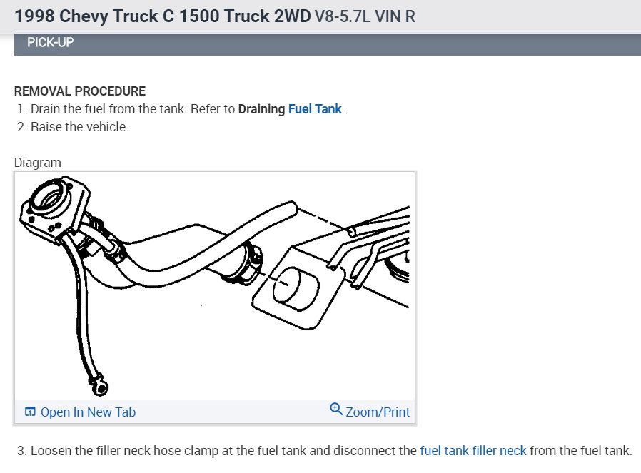

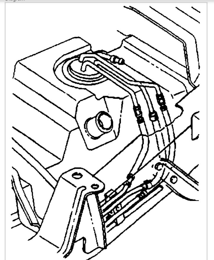

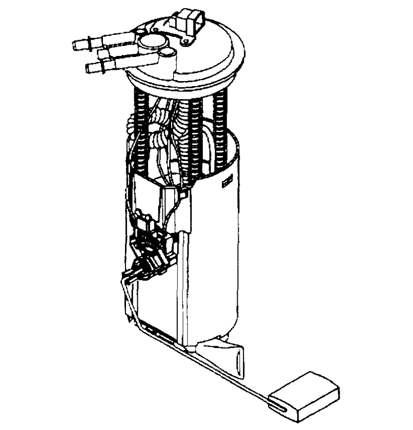

my blazer is stalling when i push the gas pedal down to far....i can only give it a lil gas at a time....when it stalls i can only start it when i go under the car and bang the fuel tank then it stated leaking I need a new tank can you help me?
Sep 21, 2006 at 8:45 PM
DIGUGLIELMO
  • 28 POSTS
sounds to me like your fuel pump is losing back pressure and stalling itself out due to loss of fuel, check the fuel filter first, then replace the fuel pump. if that doesn't work go get your injectors cleaned. Here is how to change the tank out in the diagrams below. Check out the diagrams (Below). Please let us know if you need anything else to get the problem fixed.
