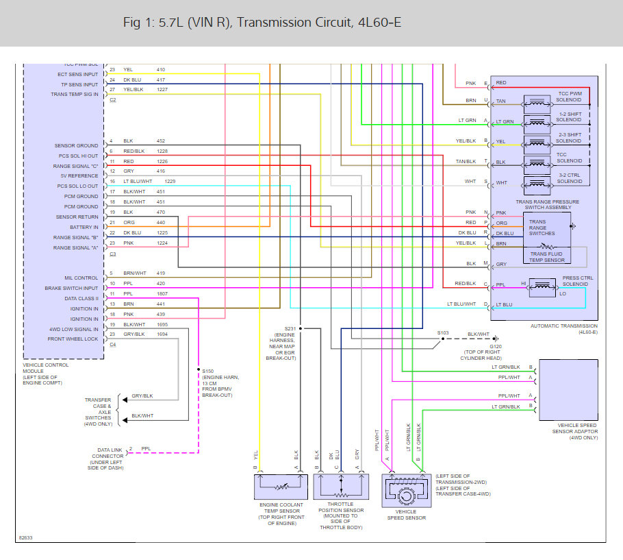

I'm having a problem with the Transmission shifting. I thought the trans. might be bad so I replaced it and I'm still having the same problem with the shifting. The Check Engine Soon Light stays on and it just will not go into O/D and somtimes it doesn't want the upshift from 2nd to 3rd. I've replaced all the Modules and changed the fluid and filter 3 times so far. I've been told that it could be the Ignition Switch. Could that possibly be the problem? I don't know what else to do. Can you help? Thanks,Stanley
