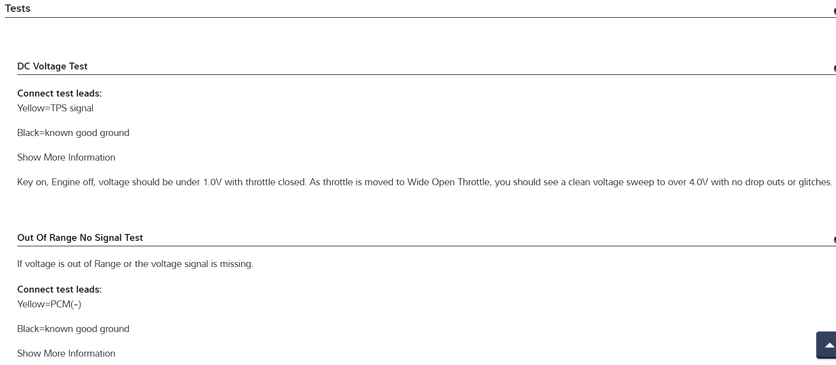

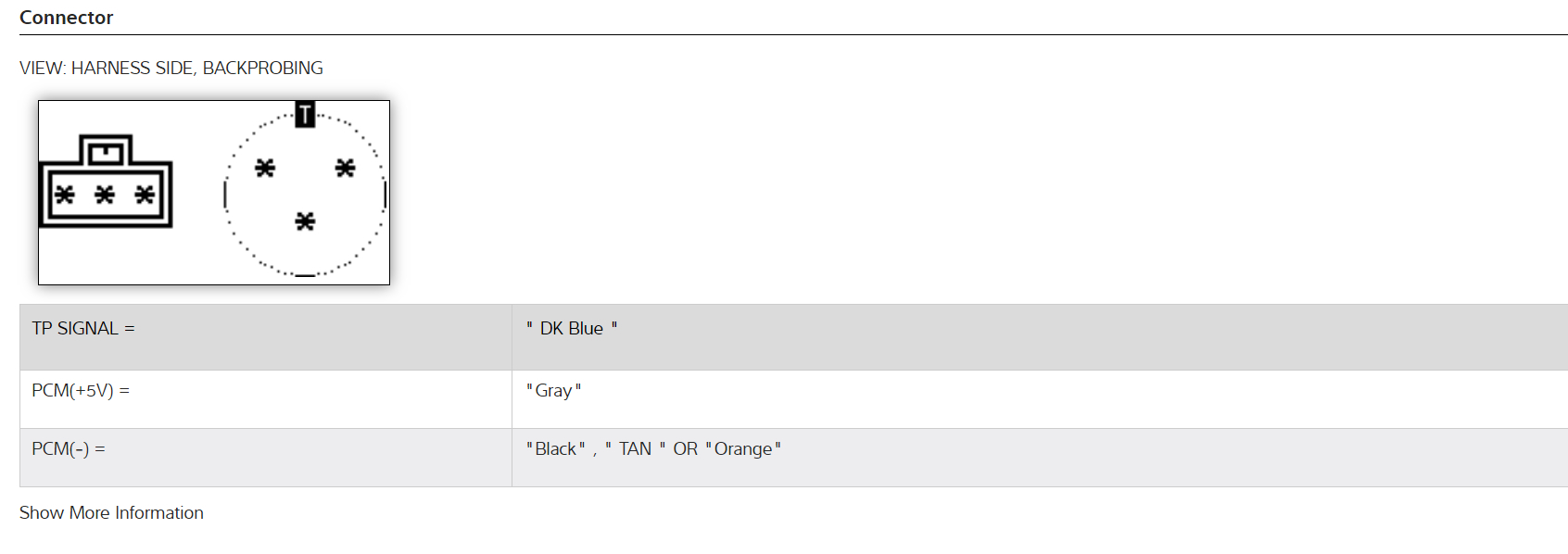

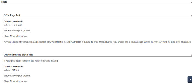

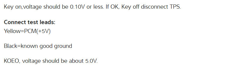

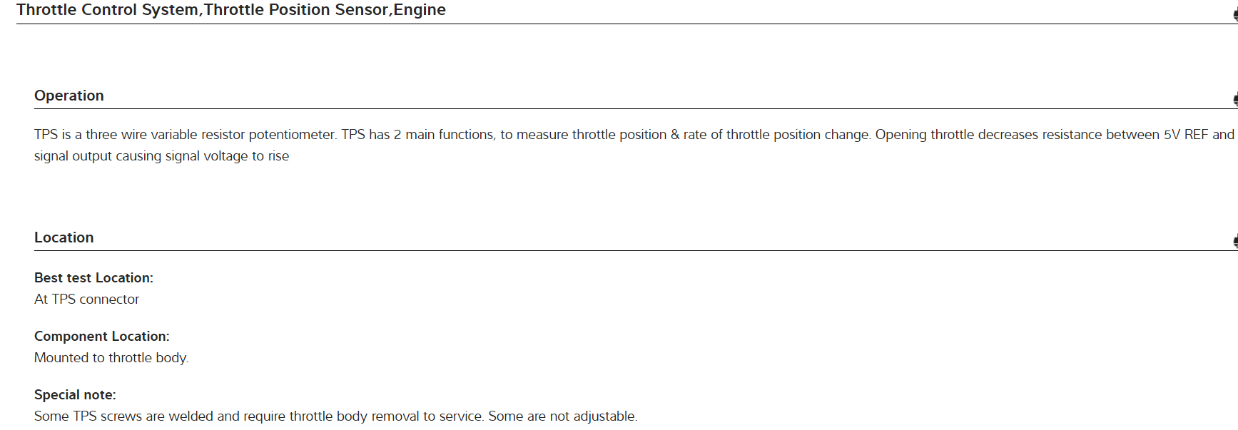

Do not jump to the conclusion that it is the tps sensor or the maf sensor. Blindly changing parts is not good. Test the tps sensor first. The tps sensor is a variable potentiometer, meaning it varys voltage. The ecm reads this varied voltage and adjusts fuel delivery accordingly. A 'dead spot' in this sensor is not likely. To test the tps--with the sensor plugged in--back probe the dark blue wire terminal with the positive lead of a DC voltage meter. Connect the negitive probe to a good engine ground. Turn the key on but do not start the engine. The voltage should be 0.6 volts at closed throttle. Open the throttle slowly and smoothley. The voltage should increase smoothley to 4.5 volts at wide open throttle.

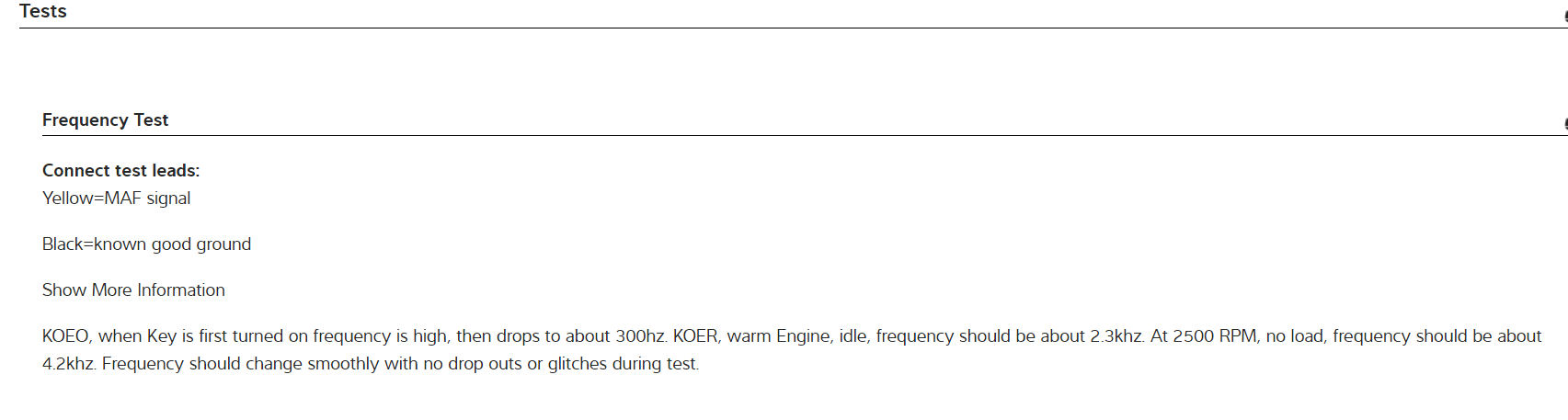

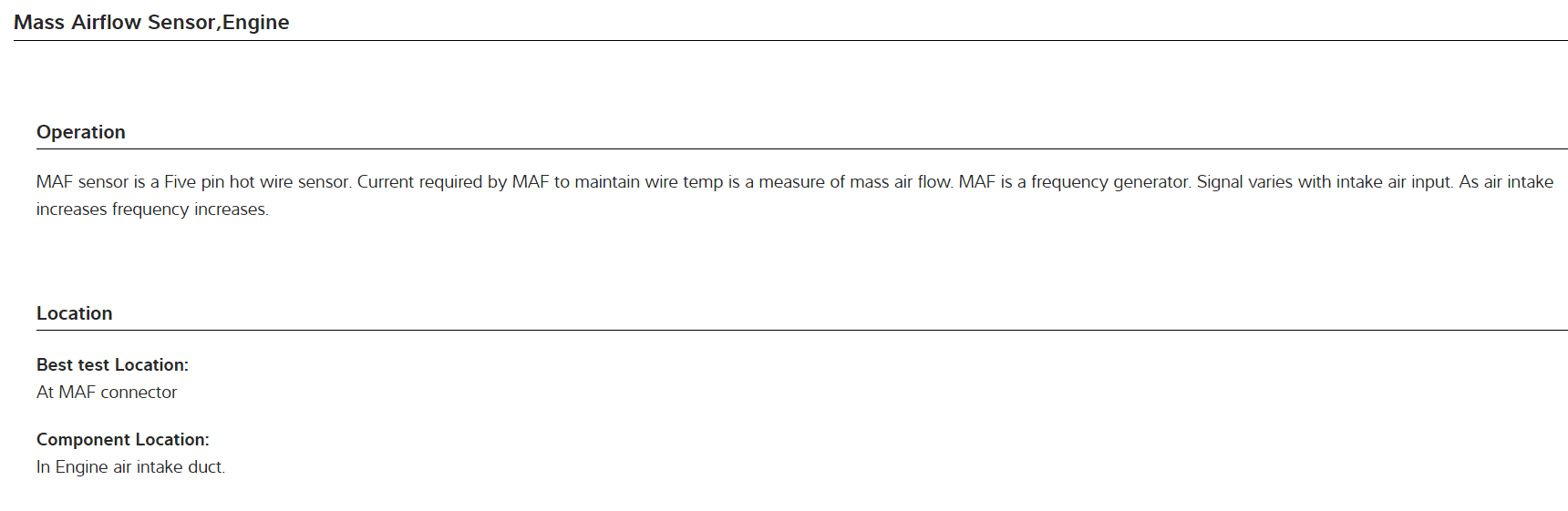

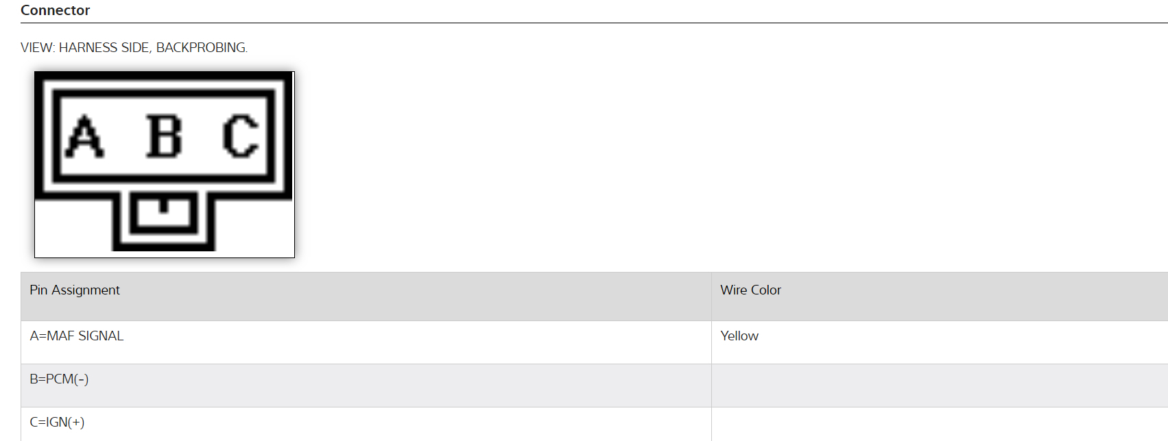

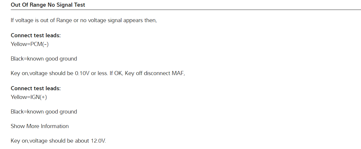

Your maf sensor needs to be hooked up to a scan tool to test. At operating temperature the maf sensor should read 4.0 to 9.0 grams per second.

BTW there is no calibration on either the tps or the maf sensors.

  I have never had to calibrate a TPS like that, but your way does make sense. I always use GM parts so the part always exactly fits.

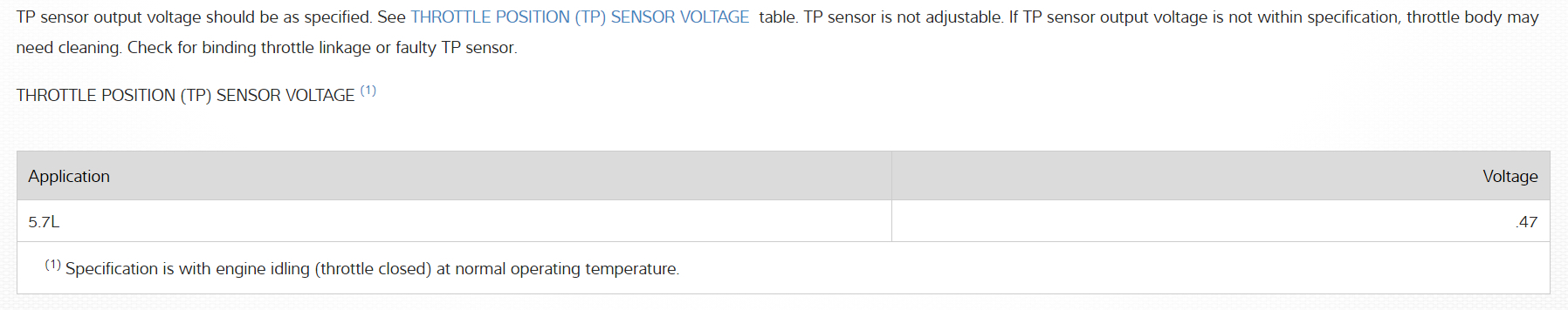

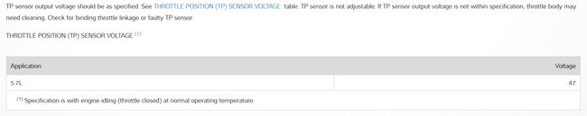

Hi Blair Blair, my name is Alex and I will be helping you. Here is the information you requested. I hope that this helps, and MAFs are not adjustable. They usually consist of a complex circuit that basically works by heating a platinum wire to around 500 degrees. As your engine ingests air, the wire gets cooled. Voltage is then added to the wire to maintain its 500 degree operating temperature. This added voltage is then read and interpreted by the pcm, and the proper amount of fuel is then introduced for the combustion process.
