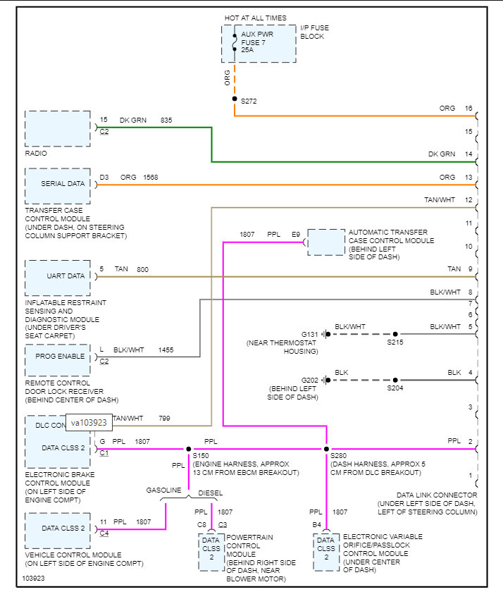

the truck is in theft mode, had a ground ,found it, now the truck starts and shuts off, had it to the dealer but they could not get into the computer to reprogram it plus it was 4:30 and they were leaving at 5 Now i got a computer out of a 97 the truck starts and runs but shes flooding and not workin right. the truck is manual shift does the computer have to be out of a manual shift truck? or do you know a way to get her out of theft mode?
