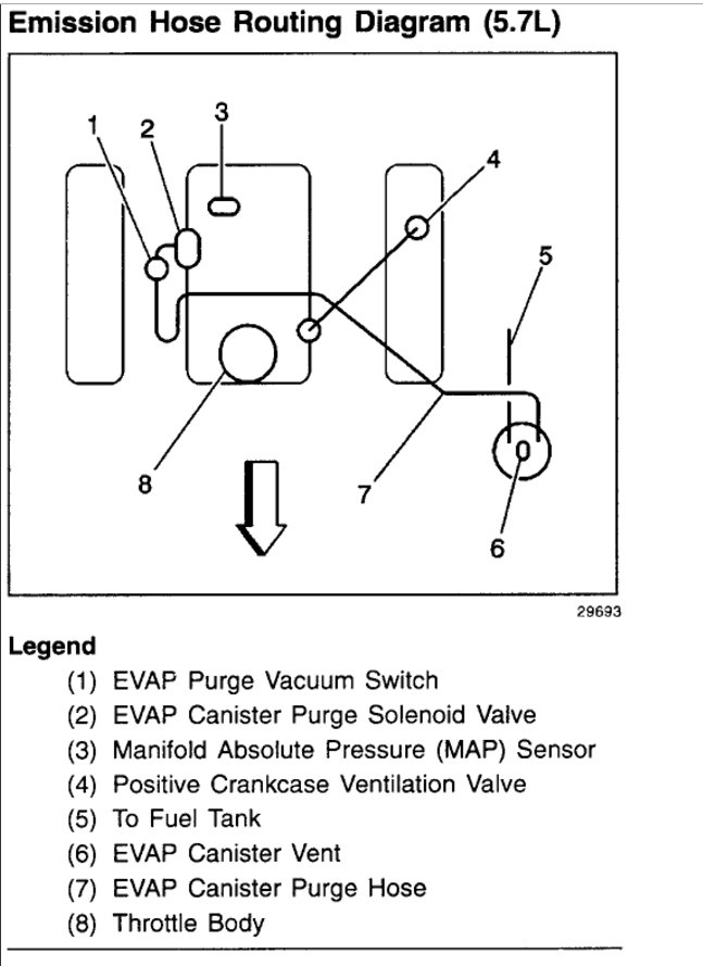

the pcv hose on the driver side of the 5.7 liter engine connects from the valve cover to the intake manifold. there is another smaller vacuum line that comes from this connection at the intake manifold. where does this vacuum line connect? on the passenger side of this same engine, there are 3 hoses/lines that connect to the evaporation emissions purge solenoid vacuum switch. one to the canister purge solenoid, one to the purge fitting at the vapor canister, but where does the third vacuum line coming off this device connect to? no vacuum diagrams show these 2 lines.

Here is the vacuum diagram for your car (BELOW). The 3rd goes to the fuel tank, the smaller hose goes to the MAP sensor. There are not many lines. I was unsure to give you the answer because its V8 and there's 2 different engines and the vacuum diagrams are different-I can provide the other diagram if you wish-hoping its the one you're looking for.

Thank you for the vacuum diagram they helped me and I got the truck running great.

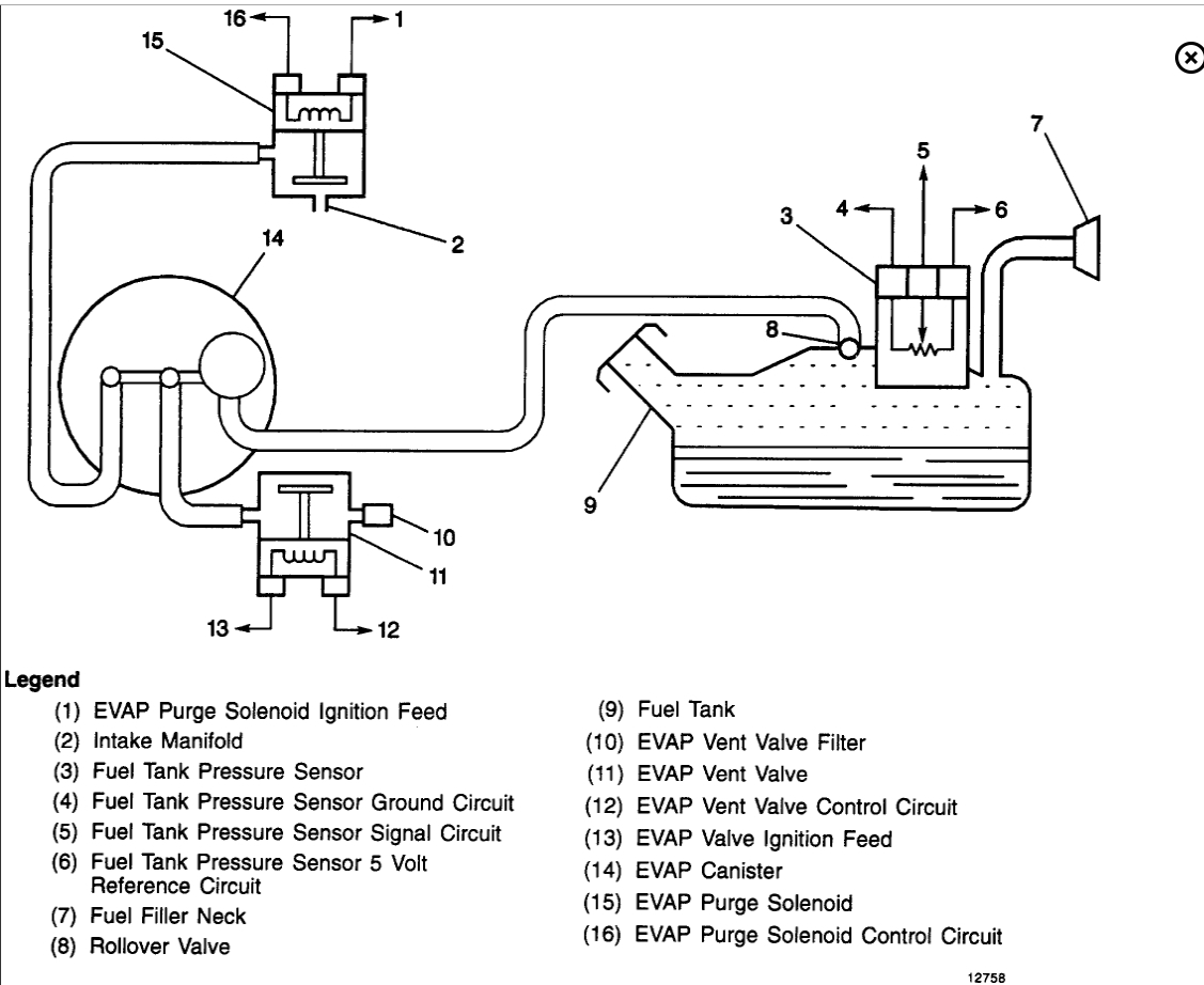

Have a 1997 5.7 liter V8 stepside pickup. Symptoms include high idle while running down the road, 40mph and release gas pedal and truck very slowly lowers in speed unless brakes depressed then it slows the engine idle down. examination shows a vacuum line port with no hose and I cannot determine what (if anything) should be in there? I have never replaced the MAF or serviced it in the last 6 years that I know. Dont know where to start or where to get a diagram to check the hose issue. Is there instructions on cleaning or replacing the MAF, or replacing the thermal sensor they speak of myself? Hard to justify another expensive dealer visit for this old but dependable truck. Will ADD a tip and another donation for a good advised solution - first time user. I have a picture to upload. [added: ALSO there is pressure in gas tank when gas cap is removed, hisses significantly when opened to fill - maybe related??
https://www.2carpros.com/forum/automotive_pictures/556948_DSC04160_1.jpg
https://www.2carpros.com/forum/automotive_pictures/556948_DSC04161_1.jpg
Apr 25, 2021 at 2:31 PM (Merged)
FACTORYJACK
  • 4,159 POSTS
There is no hose that goes to that solenoid, it is a vent. The solenoid you have pictured is the evap purge vacuum switch, I believe the one next to it with the red connector is the evap purge solenoid. Here is a brief description of its purpose. A vacuum switch in the purge line detects when the system is purging. The normally closed switch will open when less than 1 inch Hg is present in the purge line.
Pressure in the gas tank is not necessarily an indication of a problem, it can be considered normal. The MAF can be cleaned by spraying the hot wires with an electronics, or contact cleaner aerosol. If you had an active vacuum leak, you should have an engine light and corresponding lean fuel trim codes

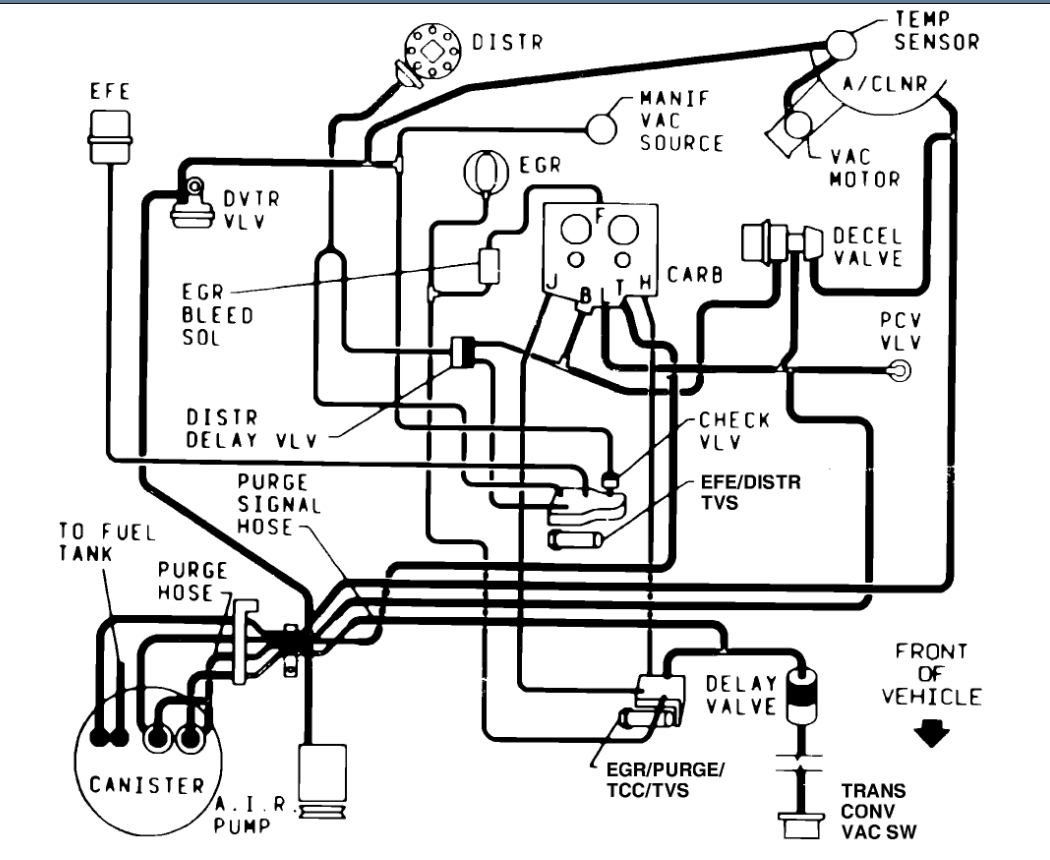

JASON.MOIT
i have a 86 chevy pickup with a 305 that will not idle. i think i might have reversed some vacuum lines but i can't rad the diagram on the truck. How can i make sure my vacuum lines are in the correct places
Apr 25, 2021 at 2:33 PM (Merged)
JDL
  • 16,098 POSTS
here are the vacuum hose routing diagrams for you truck. Check out the diagrams (Below). Please let us know if you need anything else to get the problem fixed.

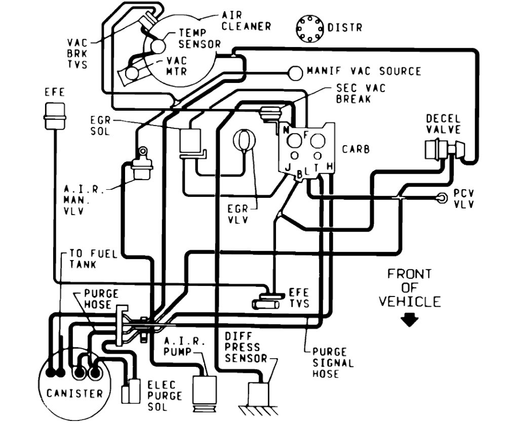

CAUSTIN86
I am rebuilding this truck and can not find a diagram or picture of how to do the vacuum line or hose. It's a 1500 Scottsdale. Also I need to know how to fix the Eldon Brock Carburetor. It's a 1600 or 1200
HMAC300
  • 48,601 POSTS
I don't understand how you want to fix your carb which is an edelbrock I beleive. Here is a vacuum diagram but it is for a federal emmission not california..

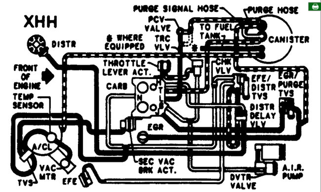

RUFAS
I am looking for XHH vacuum line diagram for a California 1985 Chevrolet C20 Build date of11/84. 5.7 with a automatic transmission.
HMAC300
  • 48,601 POSTS
see attached pic xhh is 1984 not 1985 85 is uhh but that is for a diesel.
RUFAS
HAMC
Thank you, I could not locate that diagram. That's why I also listed the build date. All info. I found pointed to this being a 1984 code, thank you again.
Rich

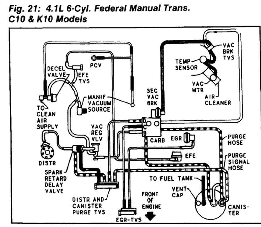

SCORPEON40
  • 33 POSTS
I wish to make sure my vacuun lines are ran correctly could you share a resourse or two of a diagram of the vacuum routing. Thanks ahead of time !!!!
HMAC300
  • 48,601 POSTS
see pic it's for a 4.1 or 250- 6 cylinder they did not put a 292 in it so hook it up the same.

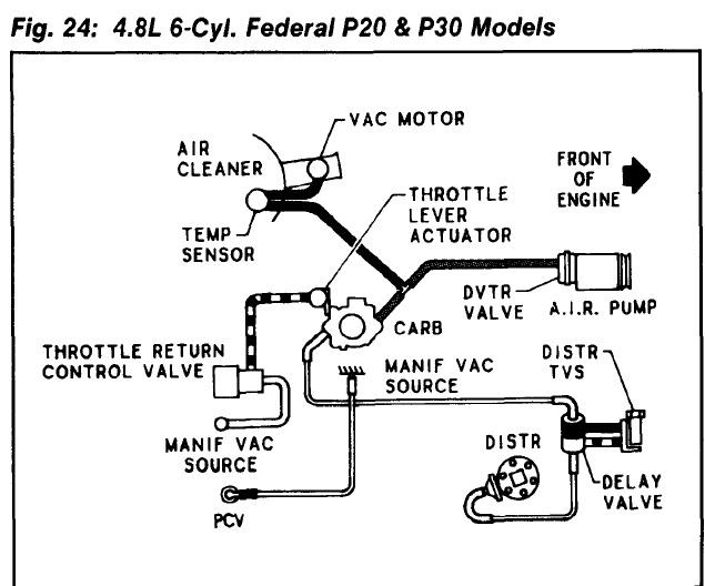

SCORPEON40
  • 33 POSTS
I have questions of weather my vacuum lines are routed correctly could you send me a resource thanks ahead of time..
JDL
  • 16,098 POSTS
I found this for the 4.8L.
