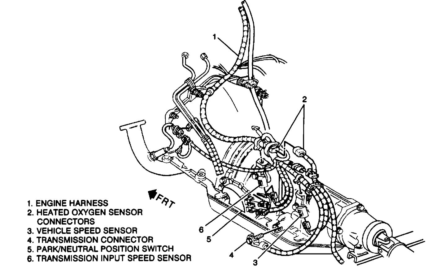

Can you tell me where the vehicle speed sensor for the transmission is located?

Hi Kimburchell and welcome to 2carpros The transmission speed sensor is located on the right side of transmission- See diagram below #3 Check out the diagrams (Below). Please let us know if you need anything else to get the problem fixed.
