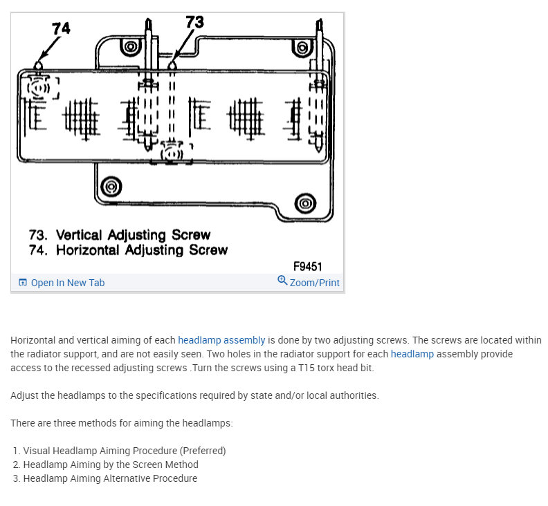

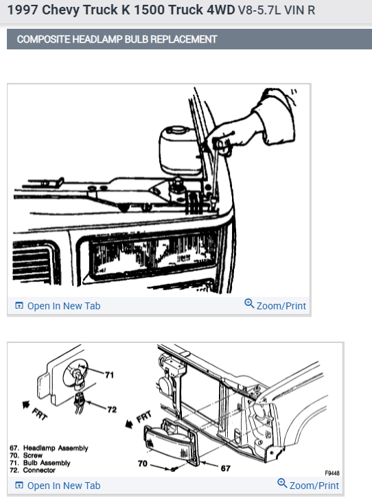

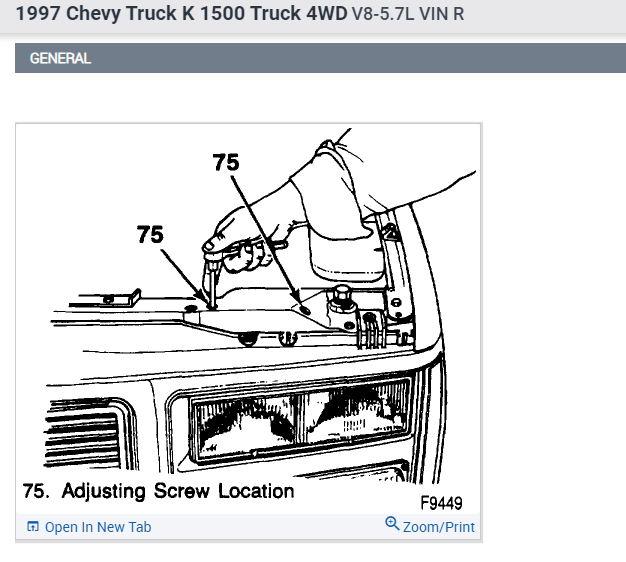

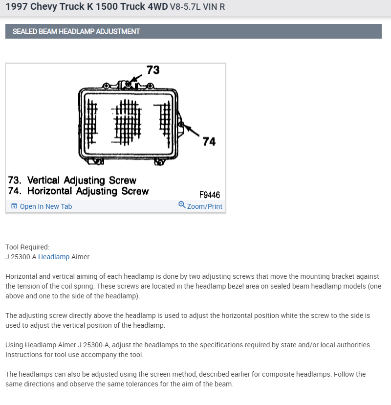

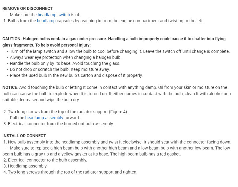

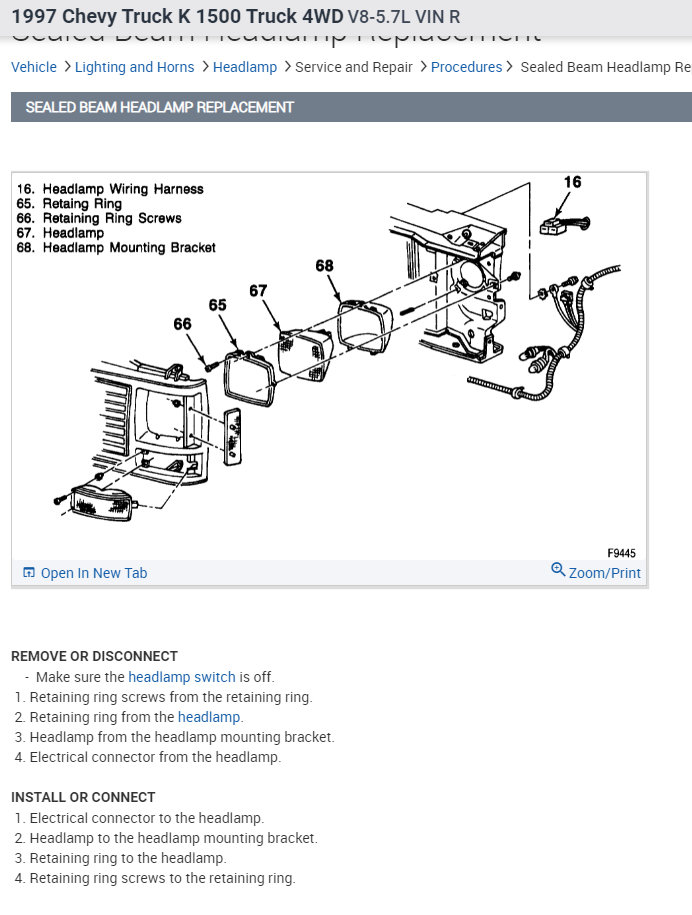

On this year Silverado's had either composite or sealed bead headlights.
The replacement procedure is different for each one.
https://www.2carpros.com/articles/how-to-replace-a-headlight-bulb
I have attached the instructions for both type below.
