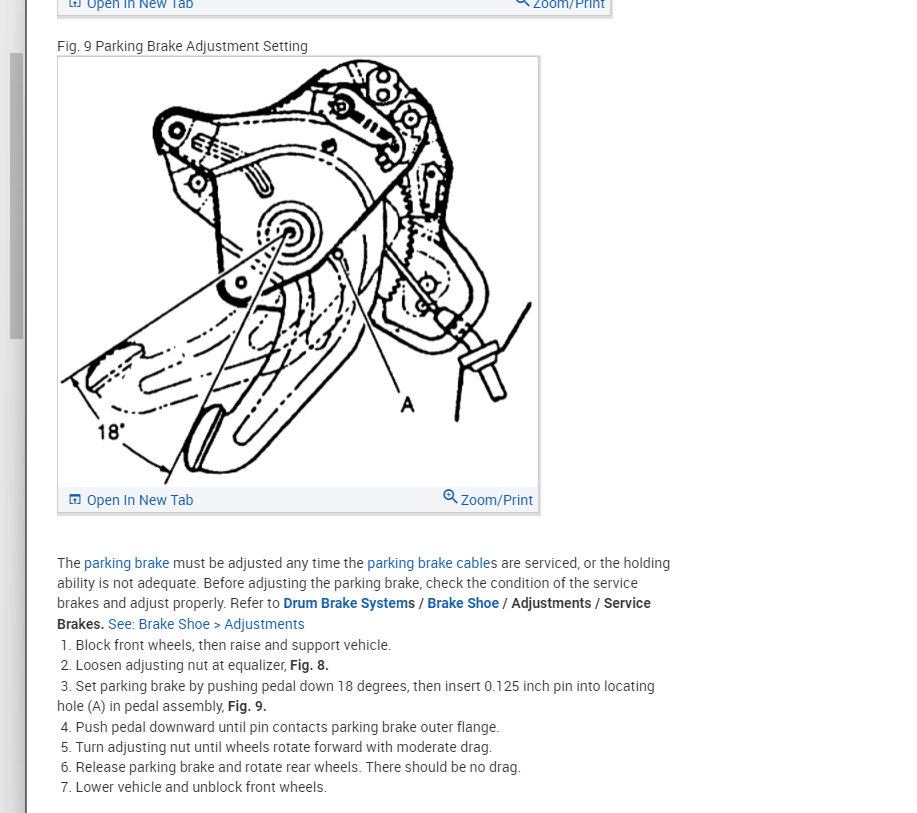

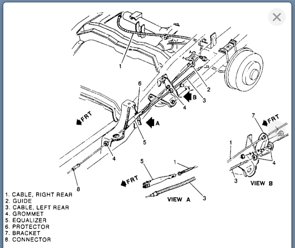

I am attaching the info below on how to adjust the parking brakes so let's run through this process and go from there. Thanks
