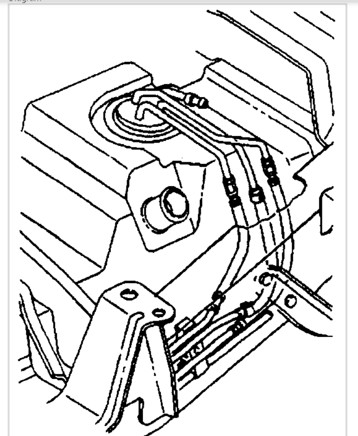

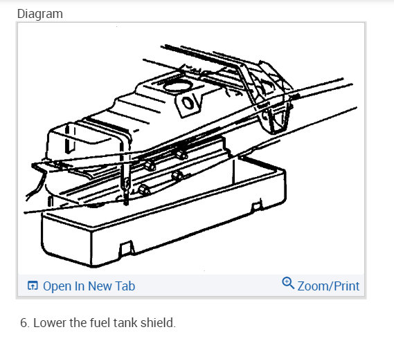

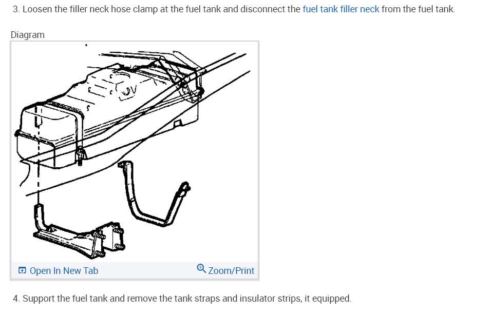

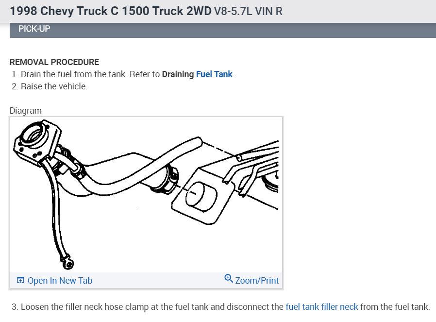

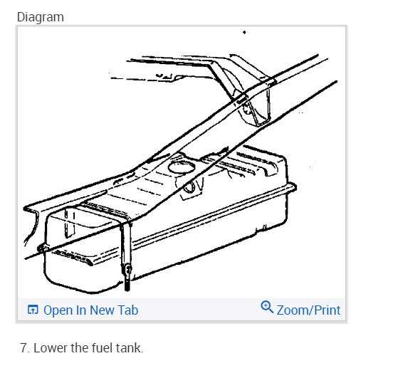

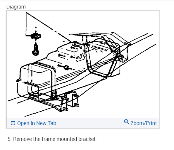

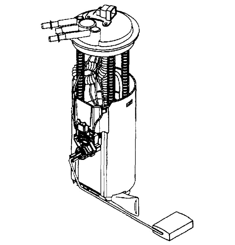

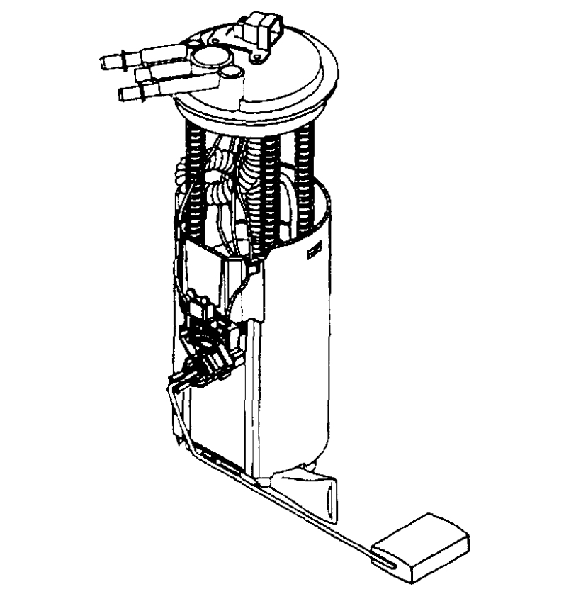

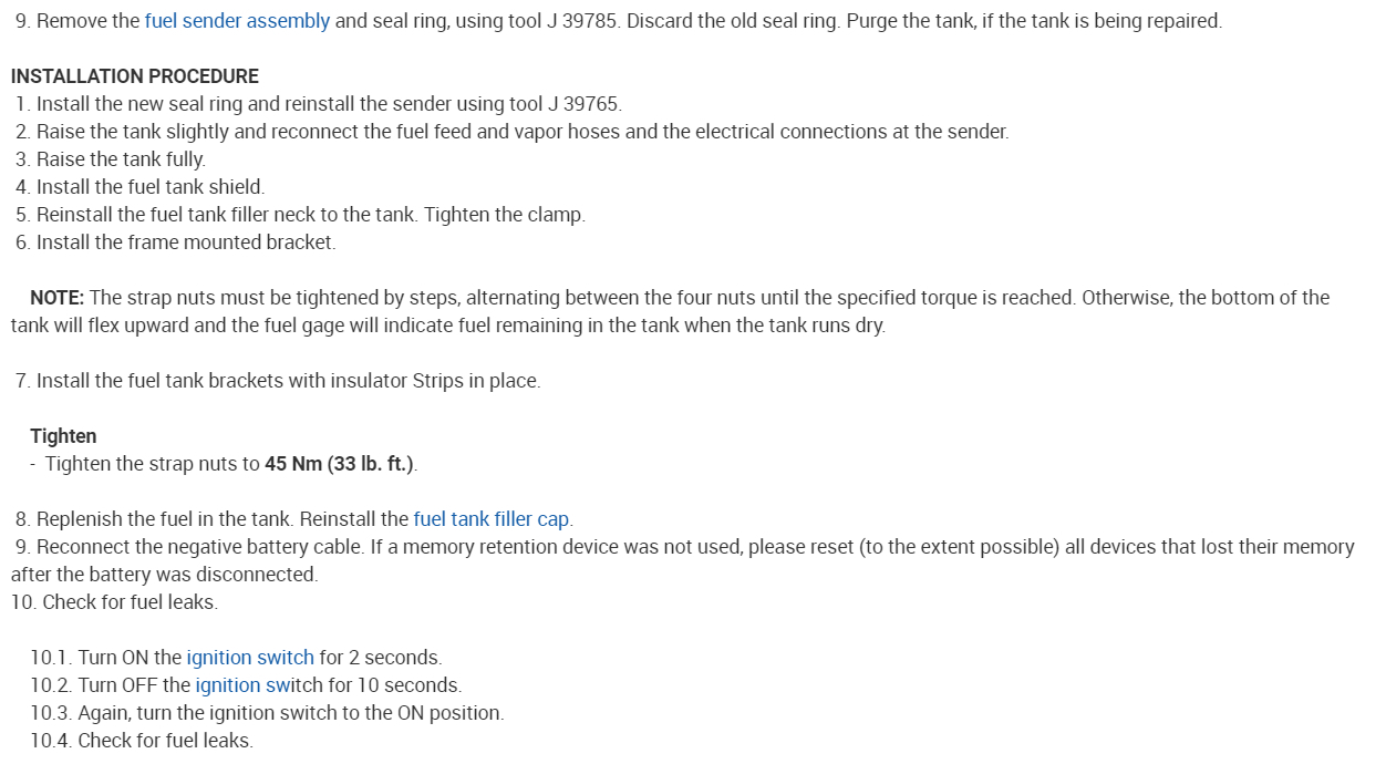

It sounds like you have a fuel pump going out but to be sure here is a guide to help you check the fuel pressure and diagrams below to show you how to replace the pump.
Check out the diagrams (Below). Please let us know what you find. We are interested to see what it is.
