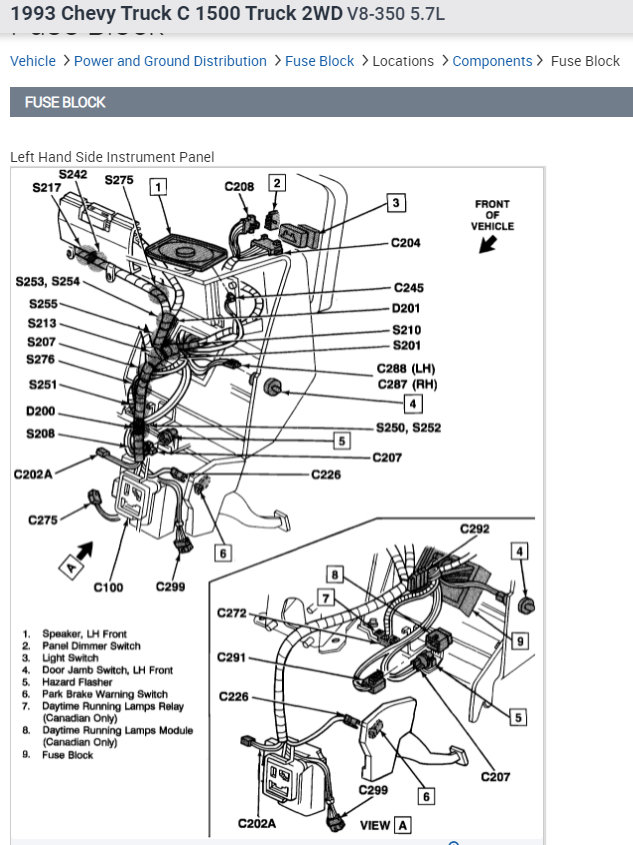

because before it's working then I've accidentally short the 2 wire connector of the door lock actuator then after that it doesn't work maybe the fuse blown up and I trying to find the fuse box for the door lock electrical system on the front hood but I can't find it, please help me

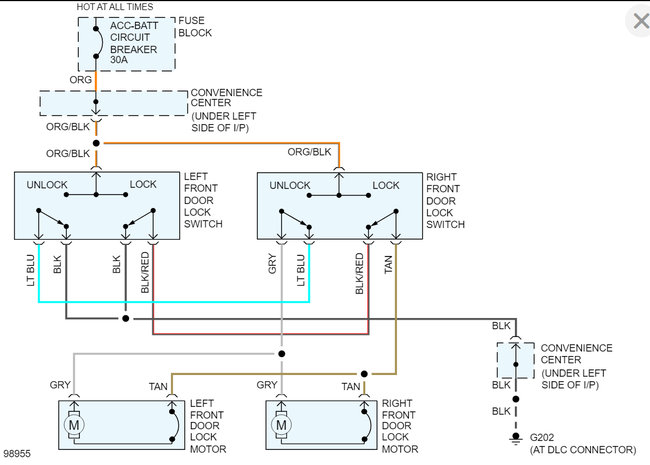

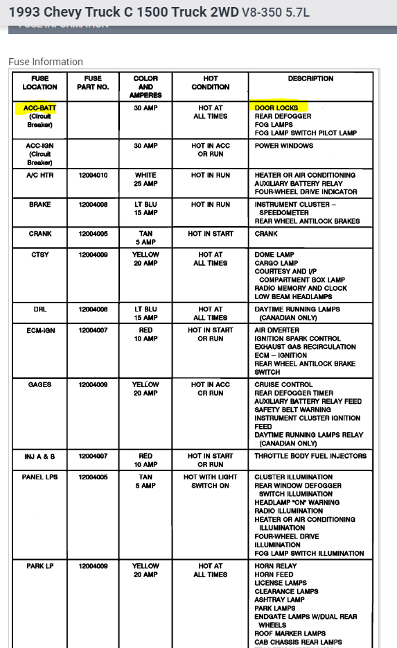

There is a circuit breaker for the door lock circuit.
It is in t fuse block on the right side of the instrument panel.
It should be 30A breaker.
If the circuit breaker is good, it could have a shorted wire. It is possible to have burnt wire when the two ends touch.
I have attached the wiring schematics and fuse block diagram below.
Thank you.
